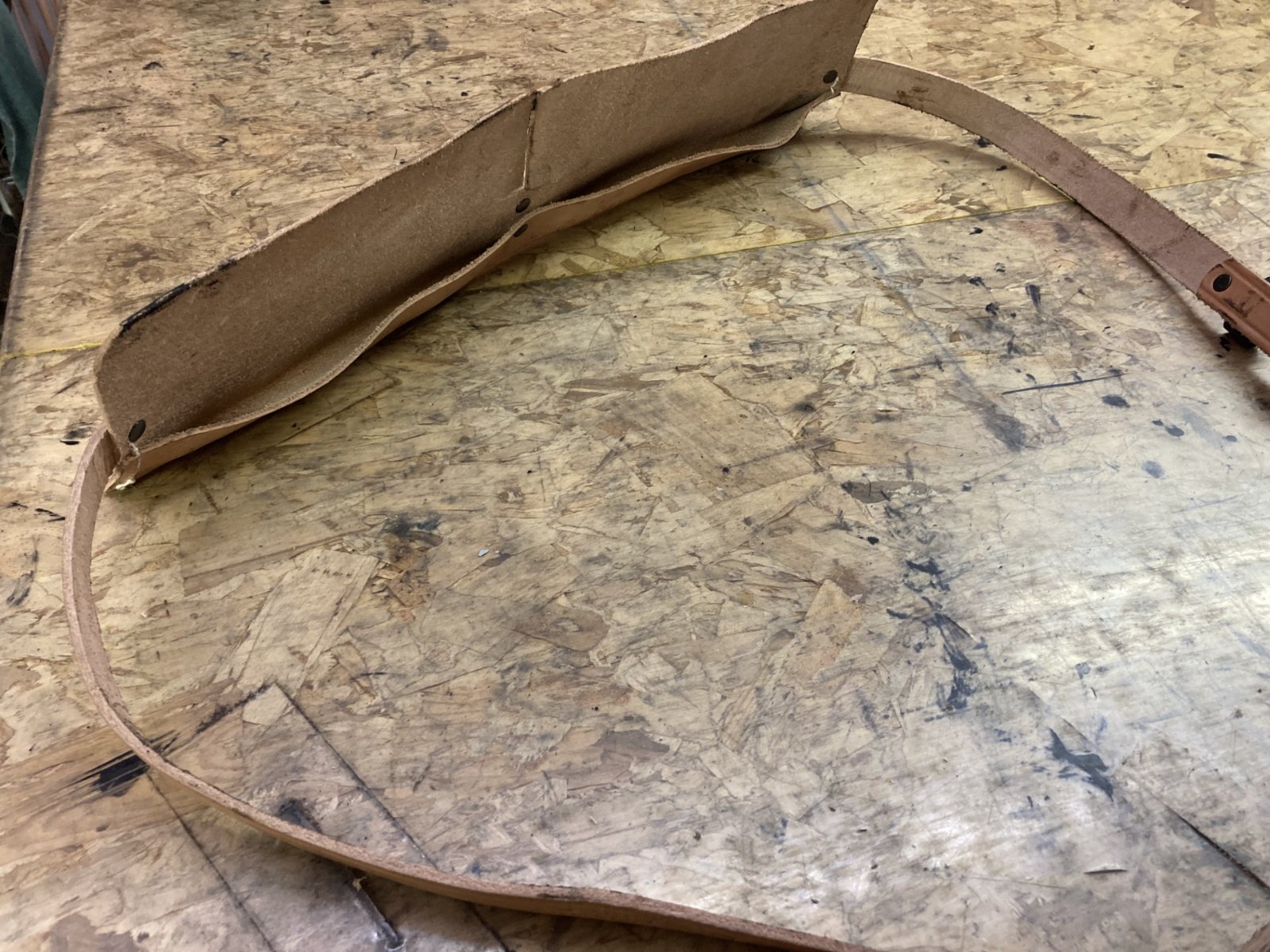

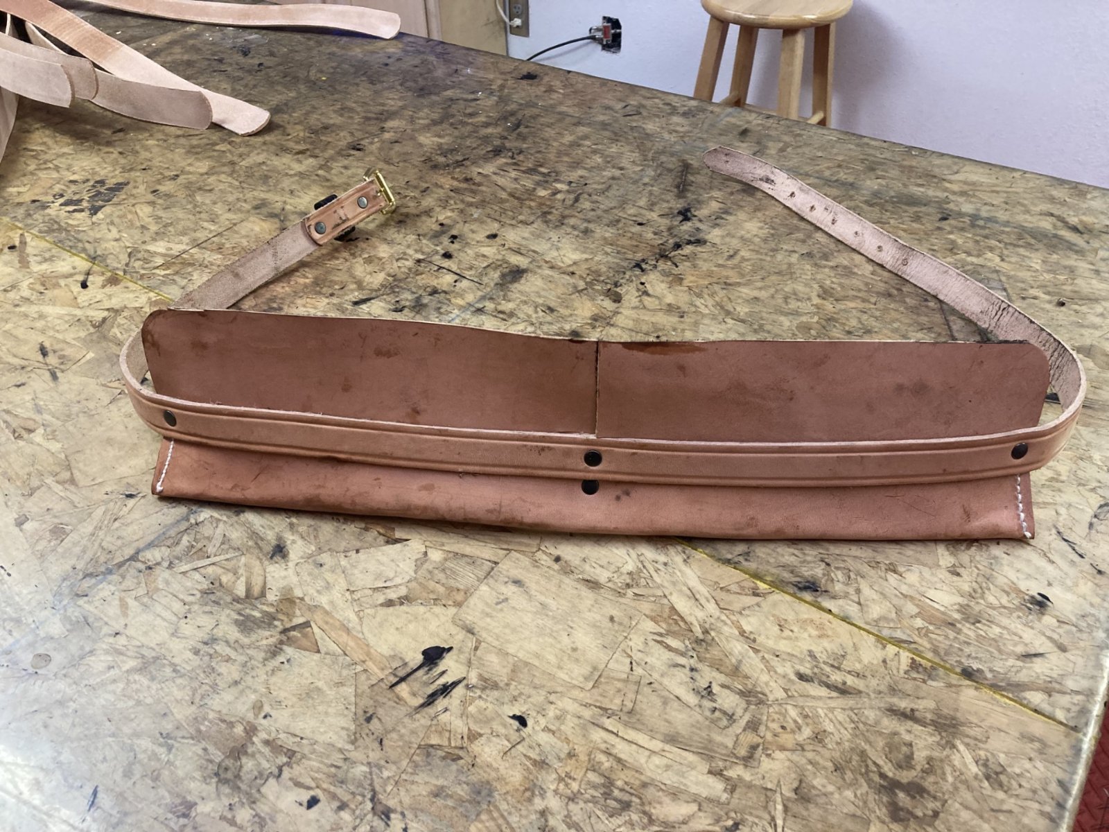

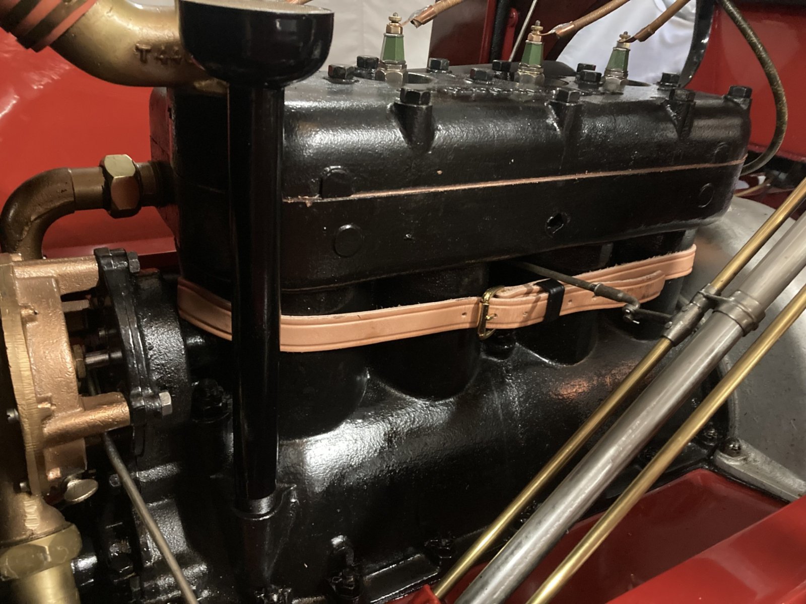

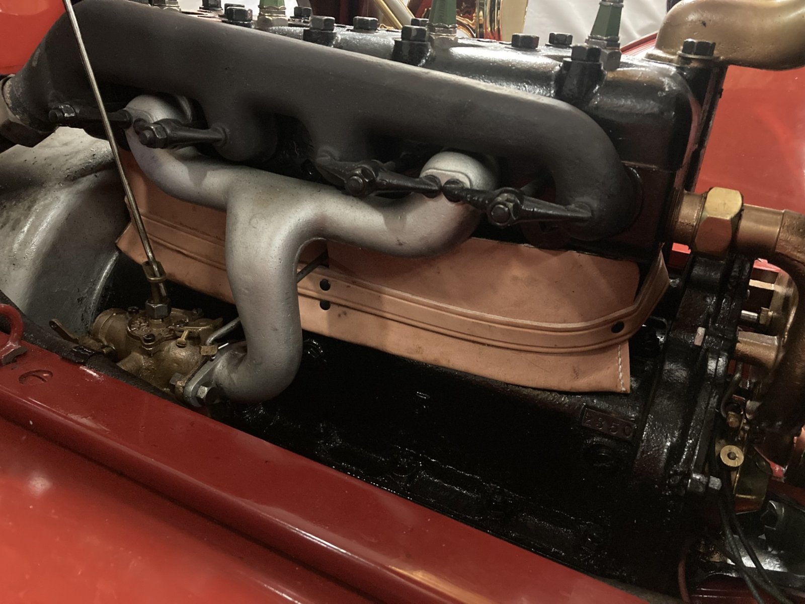

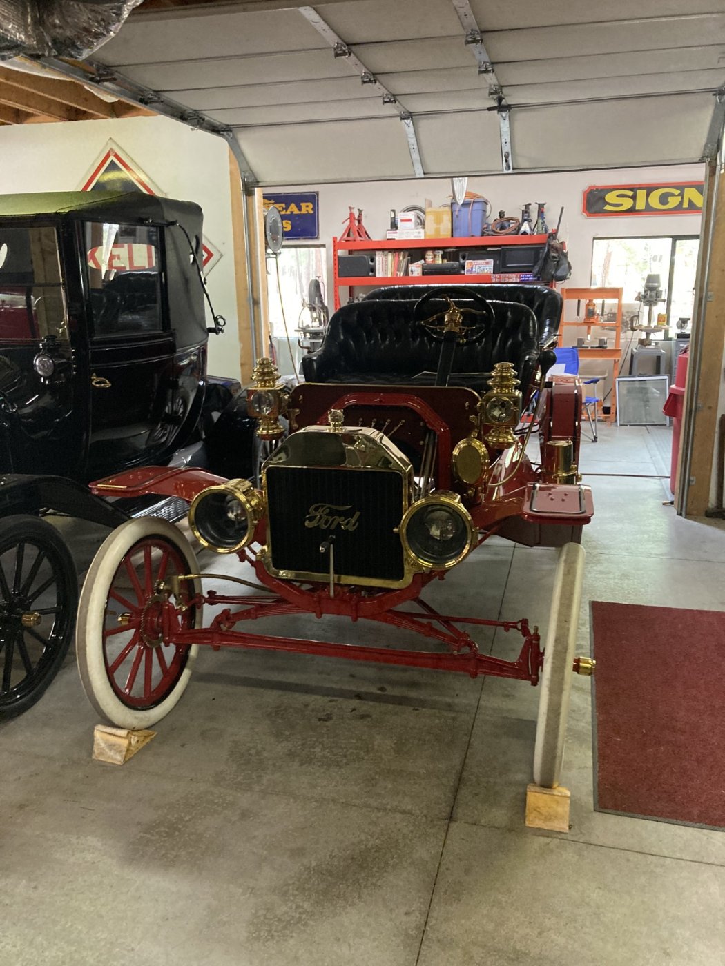

My 1909 Touring has a nasty habit of leaking oil all over the engine bay and undercarriage from the open valve train. Not only is the oil unsightly, but the oil is a pain to clean after just a short drive. To solve the problem, I made a leather valve cover that straps to the engine and the problem is now taken care of!! The leather cover has two folds that hold two absorbant pads, and the pads hold the oil in check. I used a 3/4" leather strap to go around the block to hold the cover in place. The example in the photos will be dyed black tomorrow and will be barely visible when installed. The only bad thing is that I cannot see those eight valves working as the engine is running, but the oil spashing all over the car is a thing of the past! I hope this helps, Russ Furstnow

Would you consider posting a photo tour of this wonderful machine ?

I noticed that your 1909 has a factory water pump which must mean it’s a 2 pedal, 2 lever. Would you mind sharing the engine number?

The car that I own was restored by Mark Cameron. Mark did an amazing job researching and restoring the car. The car won the MTFCI Stynoski Award in 2004, and is one of the most beautiful, and well restored 1909 Fords I have ever seen. I thought Mark would keep the car forever, but he offered it to me at the MTFCI tour in Owatonna. I was very fortunate to purchase the car from Mark in October, and I am enjoying being the car's caretaker. Mark collected many, many blueprints from the Benson Ford in an effort to correctly identify the correct and unique parts used on the first 2500 Model T's. Mark searched many years for the parts to properly restore the car. Mark purchased the engine assembly from the late Chris Eggsgard and the original motor number is #2350. The car number is #1001, and is a three pedal, one lever car.
This is the second 1909 Ford I have owned, and both cars have leaked oil from the valve train. While "o" rings may stop the oil from leaking past the valve lifters, the open valve engines were made to spit oil......so the leather valve cover was made to just keep the car a bit cleaner!!!
