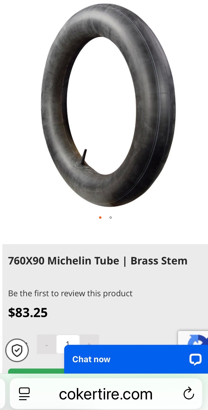

Coker Tire lists the 30” x 3 1/2” brass stem Michelin tube.

The catalogue photo does not show a Michelin tube. That tube has a rubber valve stem. The Michelin tubes have a brass stem mounting vulcanised into the tube. A separate brass valve stem, the same size as the more prevalent Schraeder [Read larger than the original T] stem then threads onto that base in the tube. The metric equivalent shown is the size to fit 30 x 3.5" tyres.

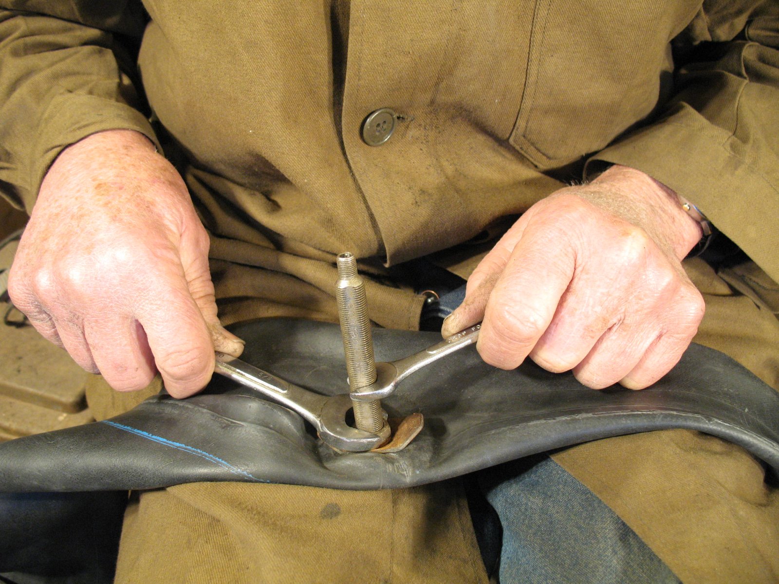

The catalogue photo does not show a Michelin tube. That tube has a rubber valve stem. The Michelin tubes have a brass stem mounting vulcanised into the tube. A separate brass valve stem, the same size as the more prevalent Schraeder [Read larger than the original T] stem then threads onto that base in the tube. The metric equivalent shown is the size to fit 30 x 3.5" tyres. These do actually hold air, unlike most of the stuff presently marketed.

If I can buy a Michelin tube with a rubber stem, that is what I want. I don't want to buy any tube that has an incorrect valve stem! My understanding is that the Michelin tube are better quality than what I can buy from Lucas.
