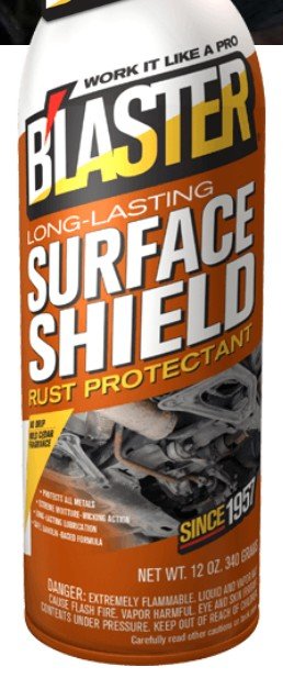

I use B’laster Surface Shield®
https://blasterproducts.com/product/surface-shield/ It is very sticky and slimy so I put it in a zip lock bag after coating.
It can get very messy easily.
And it washes off easily when you finally want to use the part.
A lot of lubricants can prevent rust if put in a plastic bag.
I gave up using while lithium years ago, I blamed it for rust under the grease sometimes.
I could not prove it but I suspected it.
Mike

Mike,
Well, I'll confirm your suspicions about white lithium.
When I tore down my TT in the 80's I had to store machined parts until I had the money to restore. That was one of the recommendations then, greased up and wrapped in oil cloth.
Only to discover later the onset of serious rust after only about 4 years. And that was in arid Calif.
Why I had to ask, figured better options now.
