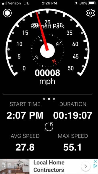

. But, once I’d made a few on the road adjustments, holy cow. It’s night and day difference. Two places I really notice it - acceleration is seriously better and an increase in the top end speed which, frankly, surprised me. I didn’t believe the Stewart Speedo so I got my iPhone speed app out:
Only once before have I been at 50mph and that was in Buelton on the 101 going downhill chasing Brad Lusk with the wind at our backs. This time I was on flat road, no wind.
My maximum top speed with the Zenith on flat road is about 45-47 mph. I’m NOT condoning driving at this speed in this car... but as a former racecar driver you always want to know what Bessie is capable of.

My T has balanced crank, Z-head, 290 cam, etc. Top speed with the NH was 52mph. I put a Winfield 4H on a high-volume manifold, and went no better than 52mph... After I accidentally blew the muffler apart, I went 57mph with a bit more left in it!

Ya And Jillian Robison, this years Montana 500 wining driver averaged 54.34 mph for a total of 495 miles with a Stock T and NH carb that passed the No-Go / Go gage tests!! I do have to say the cam shaft selection is one of the few options.

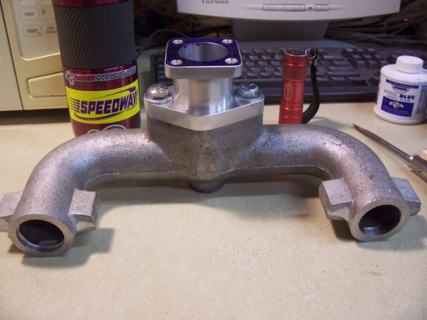

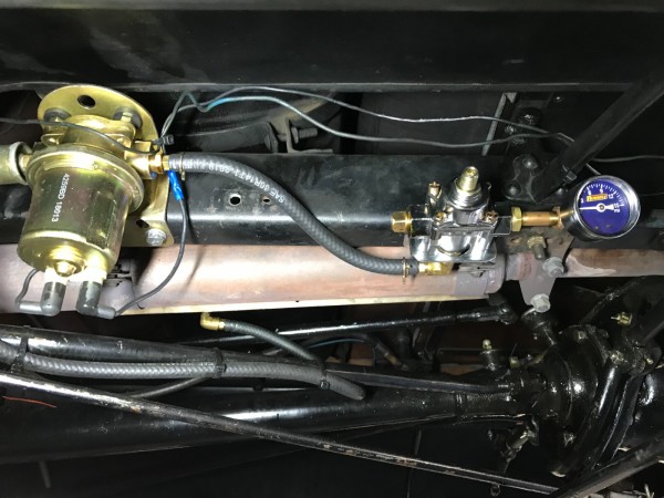

There is a guy in L. A. that makes kits for the SR, good quality. I ran a fuel pump and a regulator on my SR. My reading indicates a gravity float and needle and a pressure float and needle. I set the reg. at 1.5 psi. My SR has an accelerator pump and it works good. I get good mpg and it will idle good. Very good performance. I have to watch my speed as it will run right on up to 50 easily on the flat in this 27 Tudor.

Very interesting intake manifold... I like it. looks like mine was a hacked flange welded on to on a stock NH from what I can tell. Yours looks MUCH better, more volume. Would you mind getting me a close-up pic of it? I might get inspired one day and fabricate one like it.
My regulator pressure is set for 1 to 2 psi as well. Luckily I crossed that nasty bridge a while back when I installed the Zenith carb. I went thru 2 fuel pumps and 3 regulators before getting the Carter 6v pump and the Holley regulator.

The manifold was an unfinished casting that I picked up on ebay. I had to make the carb adapter and the finish work on the manifold.
AdminJeff
Re: Winfield SR vs Zenith S4BF
Wow. Really nice. Do you think the casting was one of a kind or mass produced? Ok I guess I need to start looking on eBay! I thought it was aluminum tubing at first.

I think Smith & Jones used to sell them.
babychadwick
- Posts: 732
- First Name: Chad
- Last Name: Azevedo
- Location: Henderson, TN
I just bought one a while back, Langs sells them.
https://www.modeltford.com/item/INTAKE1.aspx
On mine I increased the size of the mounts so that they can be drilled thru. This allows me to mount the exhaust manifold then mount the intake separate allowing for removal without having to disturb the exhaust.
