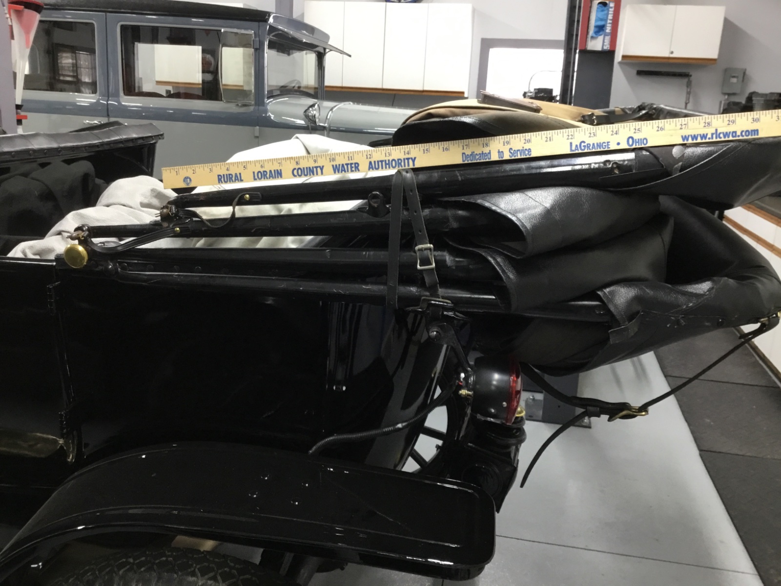

Can someone please provide the measurement of the front top bow from the locking pin at the bottom of the iron to the top of the wood bow? Thank you!

Allen, I believe this is what you requested. It’s 25” from pin to beginning of bow. Tim

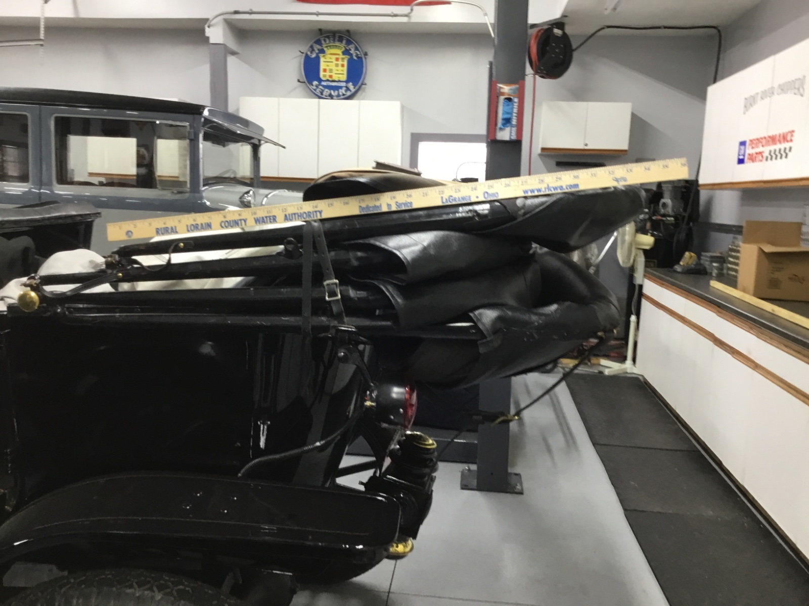

And how many more inches to the top edge of the bow itself? From you photo, it looks like the top edge of the bow is about 34” or 35” as measured from the pin. Is that correct?

I’ll measure tomorrow!

I measured about 36”. Tim
