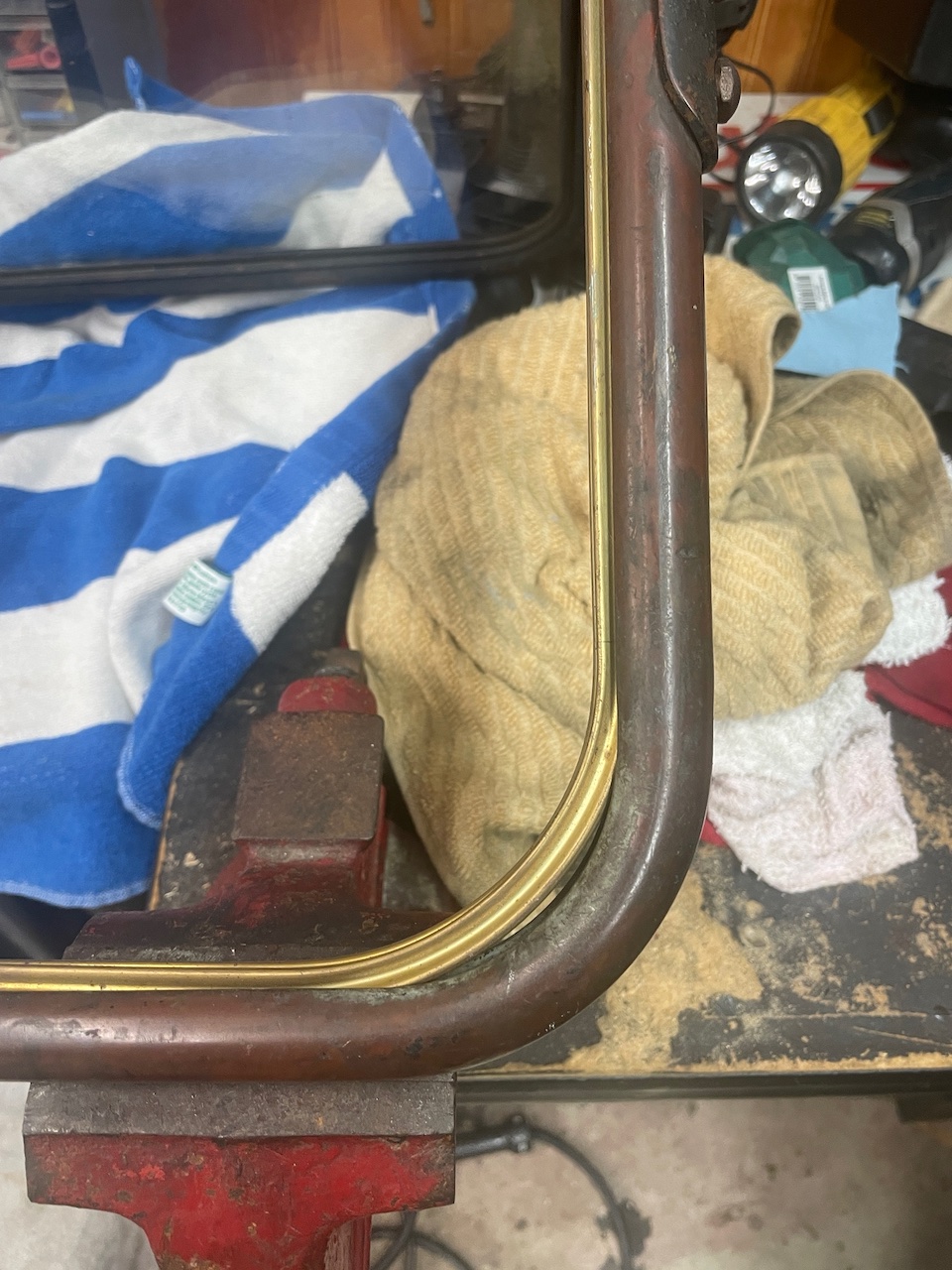

Dropped off a 1914 Windshield Frame along with the brass Glass Channel to mount it in. The shop calls me to inform that their Plate Glass is 3/16" thick however the Safety Glass is 1/4" thick. The option they gave is to have Plate Glass cut and then tempered however he also felt like that was against the law to use tempered in the Windshield location. So what are ppl doing to use the Glass Channel in the Windshield Frame??

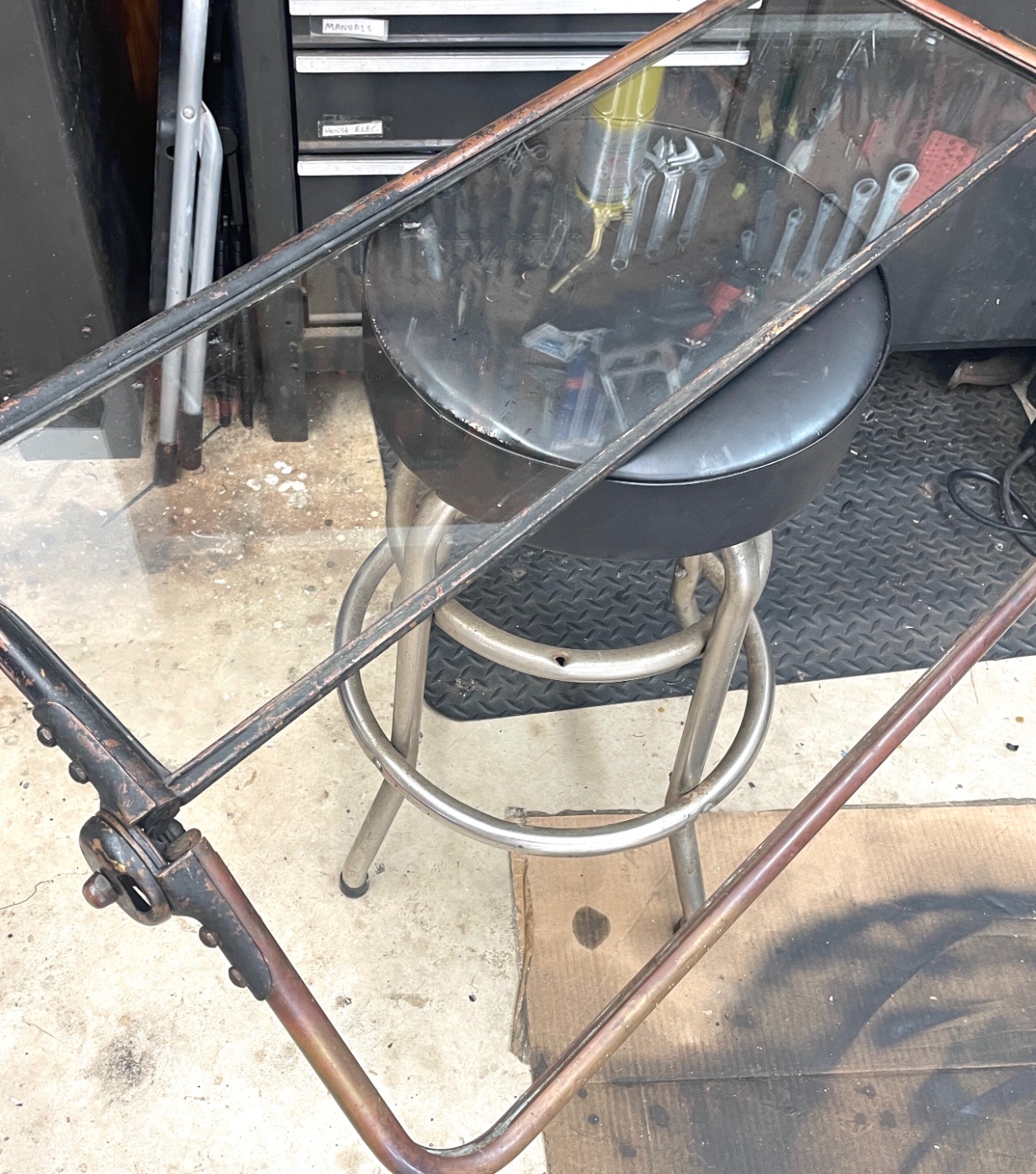

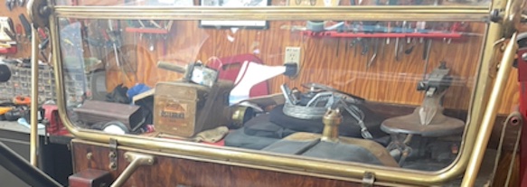

Check with another glass shop. Found this non-Ford brass windshield at Luray. Upper frame missing cross piece and brass channel, so bought some straight channel from Lang's and bent it into place, and used a piece for the top frame.
Used a piece of slightly less than 1/4" thick plywood to tamp the new brass channel in place, with a cut curved piece to mimic the curve of the frame, that helped to spread apart the new channel to match the old channel in the lower frame. Glass shop fitted the new glass just fine, the brass channel grips the glass firmly.
Lee&Cates glass in Jacksonville FL fitted new laminated safety glass in the brass channels, replacing the old plate glass that was 1/4" thick, no issues.

I used the same method as Dan Treace.
I cut a piece of wood a little thinner that 1/4” think and used it to gently spread the channel large enough that the safety glass could fit properly.
I took my old pieces of plate glass to the glass shop and had them use it as a template and I installed the new glass myself.

Thanks everyone. So we are 'singing off the same page of our Hymnals', a little backstory on this Glass Shop. We do well over $5k annually with them cutting glass for vintage automobiles we restore, -and we have used them since I opened in the late '90s. And, I'm sure they install glass for other vintage cars in the area that use flat laminated safety glass. My point is I kinda feel like they have the experience & the same laminated glass as other shops, and so finding another shop with as much experience as they have likely would be difficult. I don't think the problem is them or their glass. I think their issue was being too precautionary with a brand-new piece of channel that is no longer obtainable ...along with a freshly painted Windshield Frame. Prying and forcing delicate brass channel along with expensive glass probably did not seem prudent to them. I applaud their concerns.
Thank you Dan & Ed, I had not considered using something to spread the channel once it was inserted into the Frame but this makes perfect sense now. I'm sure this will do the trick. Thanks again.
