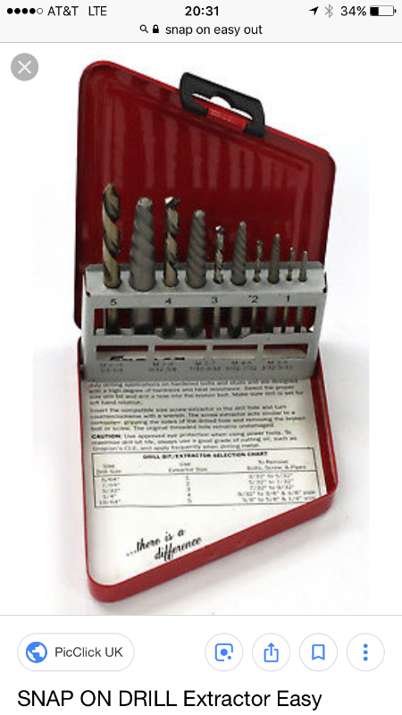

Get a good set of easy outs. Make sure you get the ones with the reversed drill bits.

Well, I found out that a small impact wrench........set on minimum.......will definitely break off a screw head. Dave, I may just take you up on that offer after I try a little drilling tomorrow. I have a set of left hand drill bits that work well in steel or iron, but I have my doubts on this one. Stay tuned! ;)

Why would you need reverse drill bits ,A hole is a hole.I never new they made them.What do you gain?
BobD
Posts: 305
First Name: Bob
Last Name: Doris
Location: Central Arizona Highlands
Re: I have this fan...................
Post by BobD » Fri Jan 18, 2019 11:26 am
A reverse left handed drill bit will sometimes (if you are lucky) grab and spin out the stuck screw without any further action on your part. :)

There's more to it than that..........the left hand bit "rides over" the threads and doesn't dig in. The result is no damaged threads after the drilling is completed. Usually. If the bit is not exactly parallel to the hole, it can damage them somewhat.

True, there is more to it than that. Should have added that before one attempts using a left handed drill for broken screw removal it is essential that one have the part rigidly secured, ideally in a milling machine or good rigid drill press and vise. The hole must be drilled as close to the center of the screw as possible. A center punch prick or a center drill is useful for starting the drill in the center of the screw or bolt. I always use a drill that is smaller than the root diameter of the thread so as not to damage the threads. As George pointed out, the drill must run parallel to the screw hole and not wander otherwise damage to the hole threads will occur. Ask me how I know this. :cry:

Another problem is that tends to harden the bolt, then trying to drill it is tough. I've rounded off Snappy ez-outs, after heating and quenching.
I have used Torx bits as an extractor before with pretty good luck.

By the way, stay away from those spiral (un)easy outs. :) All they are good for is removing bolts that have been broken off from side pressure, not ones that have twisted off. All they do is lock the bolt in tighter as you try to remove it, or twist off making it pretty much impossible to drill it out. The square type easy outs are much better. Again, JMHO after fooling with this sort of thing for 40+ years. ;) Dave
