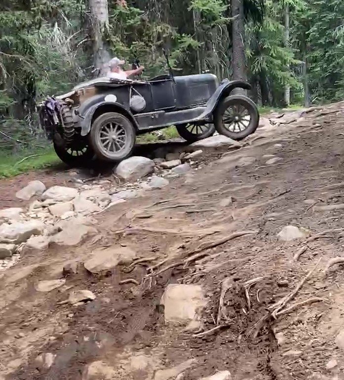

I have been running 525-21's on my roadster for at least 20 years and I love them. With the Firestones it gives you about 3% Hobo Overdrive, improves the ride (especially on wash board roads), with aux brakes it improves your braking with more tire on the road, they last considerably longer and with the 6 plies I have only had 1 flat in over 100,000 miles and that was the tubes fault. That being said, I do a lot of dirt, gravel or less and I does change the way it takes off from a stop and climb hills, if you have a Ruckstell you are in good shape, if not I would recommend going to 4 to 1 gears in the rear end. It will also change the look of your T.

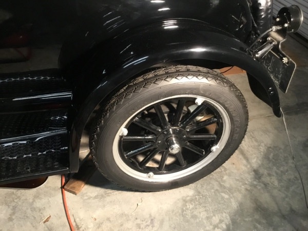

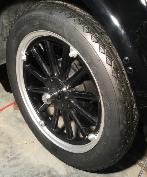

In 2022, I replaced my 52 year old, 21” “Universal” tires, tubes and flaps (purchased from Mark Auto in 1970) on my 1926 coupe with (5) new 21” “Goodyear” tires, tubes and flaps and they are superb. I could not be happier with them. Good luck.
PS. Increasing the diameter of the tire will throw off your speedometer (if you have one). I have a period 1926 Stewart speedometer so I would not consider doing it.
