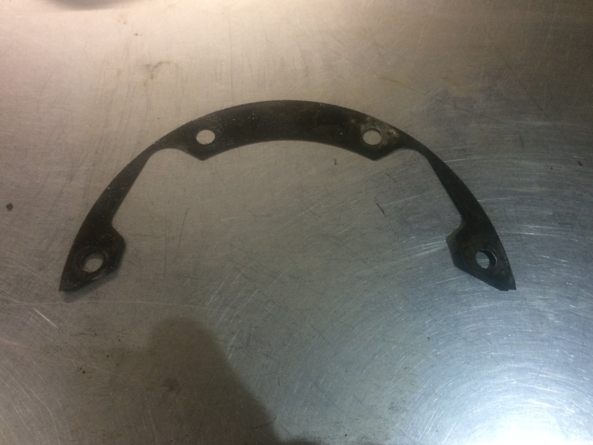

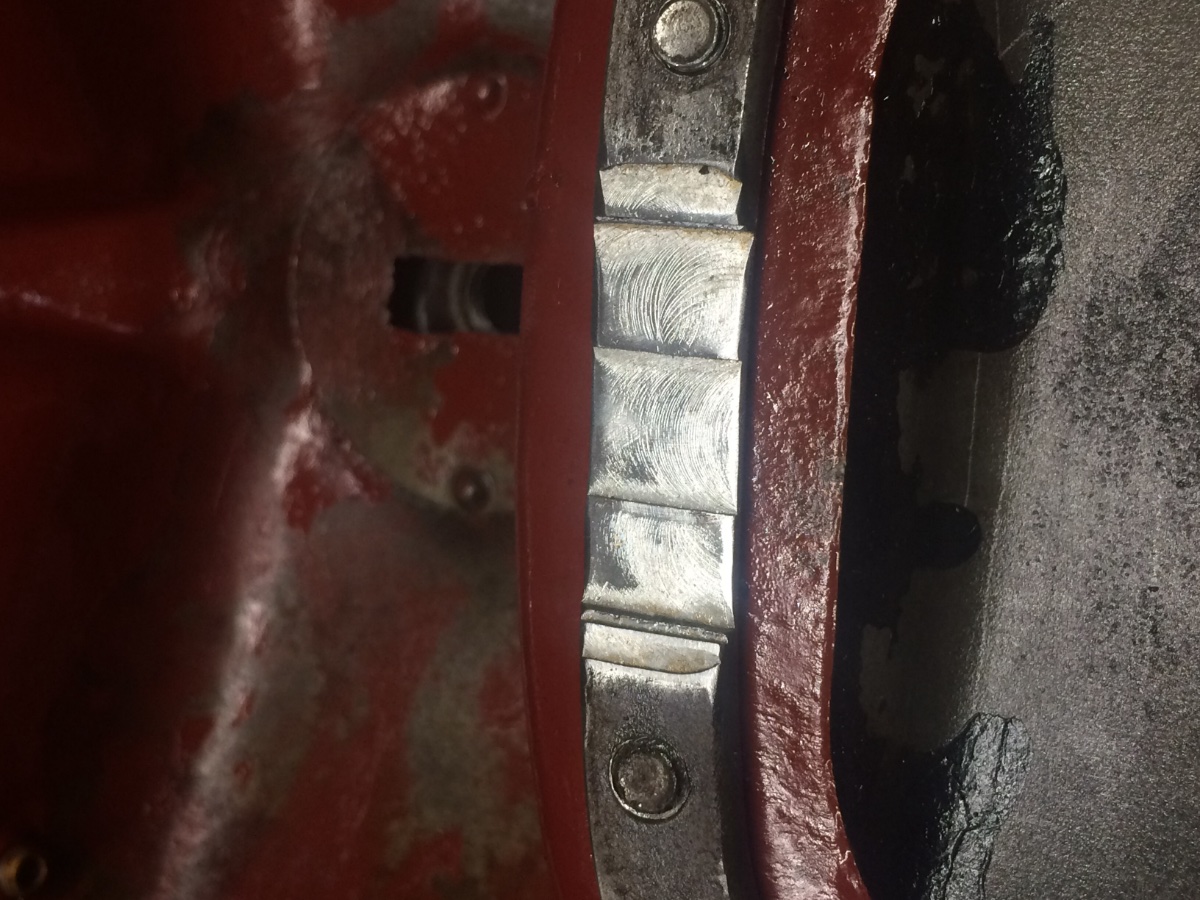

Removal of one shim cured my knock.

So, for further education, why was the shim installed? For some reason it was put there....the result was not to your liking - (nor to the engine's)...is there a lesson to be learned here that you can share with us?

Dave the biggest lesson is 25- 40 clearance loose
25.
The shim I used is a factory shim.
I made it too tight.
Scat cranks have a large radius fillet if I am setting another scat. On the tight end I will check my radius fit with plastigague.
