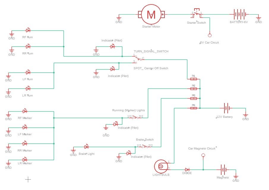

What I do on my cars is to leave the stock 6 volt system intact and add a small 12Volt computer battery under the seat.
Something like this one but there are many, many options out there.
https://www.tractorsupply.com/tsc/produ ... ls-2273564
Add a little fuse panel for charging in and power circuits out.
If someone is interested I could draw it up the circuit, currently the design is only in my cars and my head.
I install all 12 volt LED lights for brakes, turn signals, side marker lights, running lights etc so the maximum load is very low and can run for a very long time without charging.
But I charge the battery using the built in magneto to charge the battery.
The magneto charger is described in the MTFCA electrical book
https://www.modeltford.com/item/RM1.aspx

With my bulb mounted under the hood and it lighting up when charging I get a really cool nighttime effect.
I look like bright shark gills from the side and it lights up my pedals while running along.
Just a very interesting unexpected side result.
I prefer simple, easy, reliable, and something that I can get parts for when I am away from home on a trip.
When you have a problem with too custom of a part you could get stuck if there is an issue away from home.
That is how I do it, others do it differently.
You have to do what works best for you.
Mike

I thought about it and decided to draw up how I wire LED lights for my car.
It is a totally custom made out of parts.
The fuse block uses glass fuses and is brass from a marine supply store.
I make a control panel with the switches and indicator lights.
I mount the control panel in the middle so the driver and passenger can see and work the controls.
Mike
