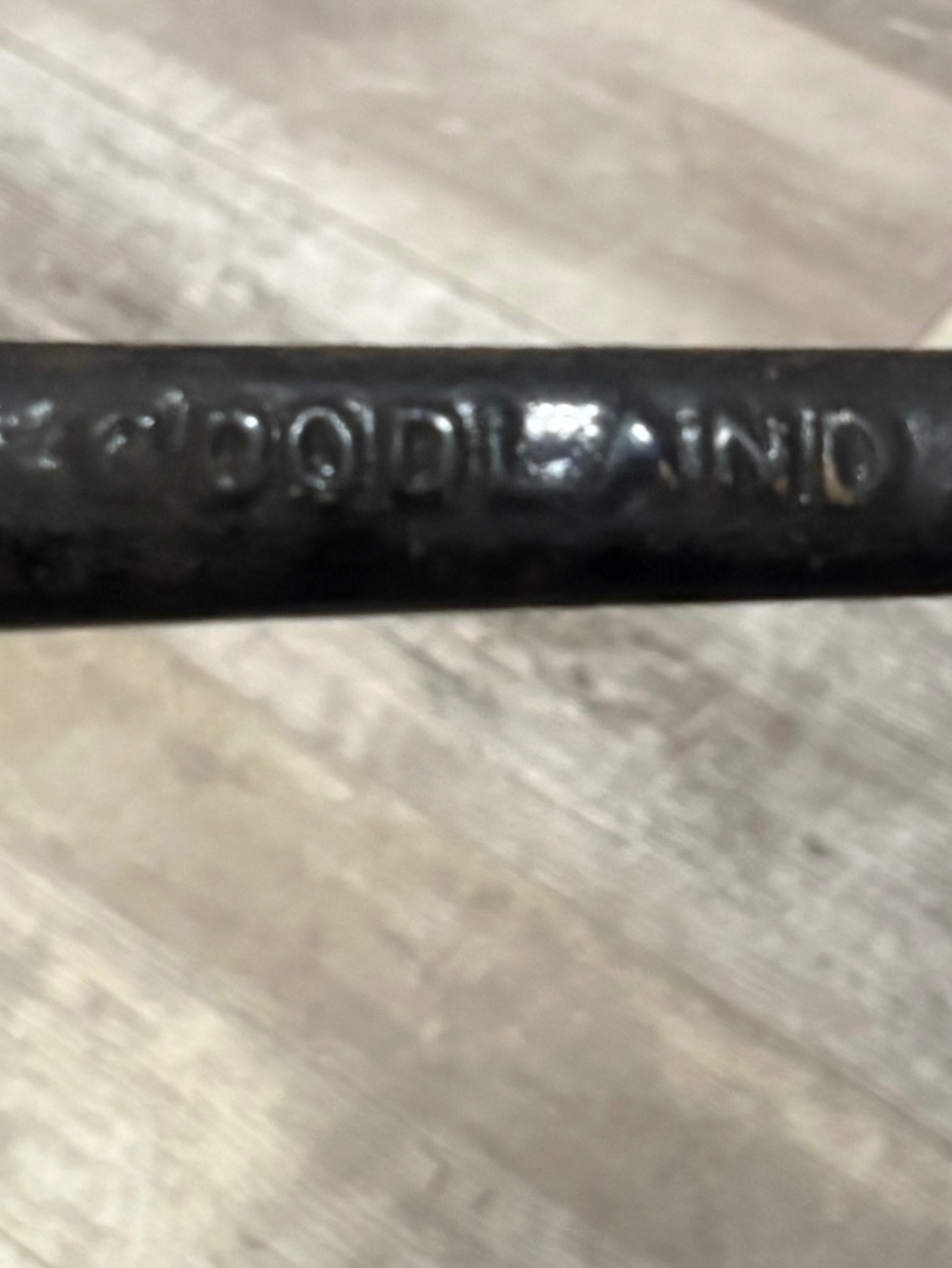

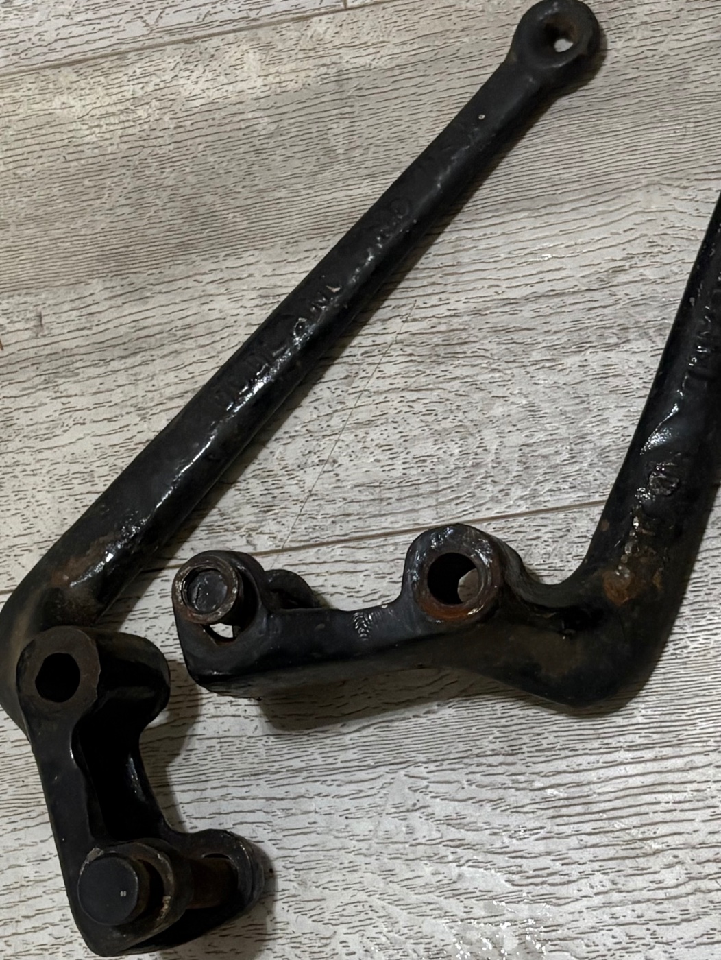

Picked some parts today , Google has not been my friend on some of them . Are these for a model t ? Says Woodland nd on the arm

It looks like maybe an accessory shock or spring that installs like a spring shackle

Here is an example of Lake shock absorbers that I posted a while back which are a closer match to what you have:
https://www.mtfca.com/discus/messages/8 ... 1256526518
When I took them apart, they were completely worn out. They had no bushings - just iron against iron. The non-Ford parts had no provision for lubrication other than just squirting them with oil.

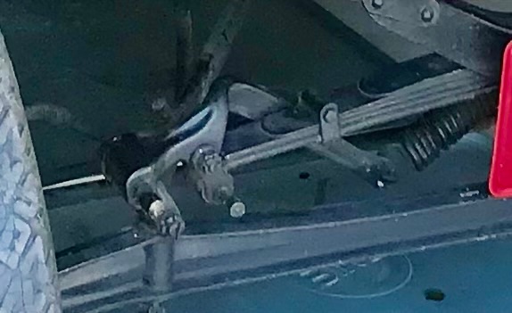

When I bought my T 25 years ago it had accessory front shocks that look similar to those. I took them off.
- Attachments
- IMG_5453.jpeg (66.8 KiB) Viewed 284 times

That looks like them
