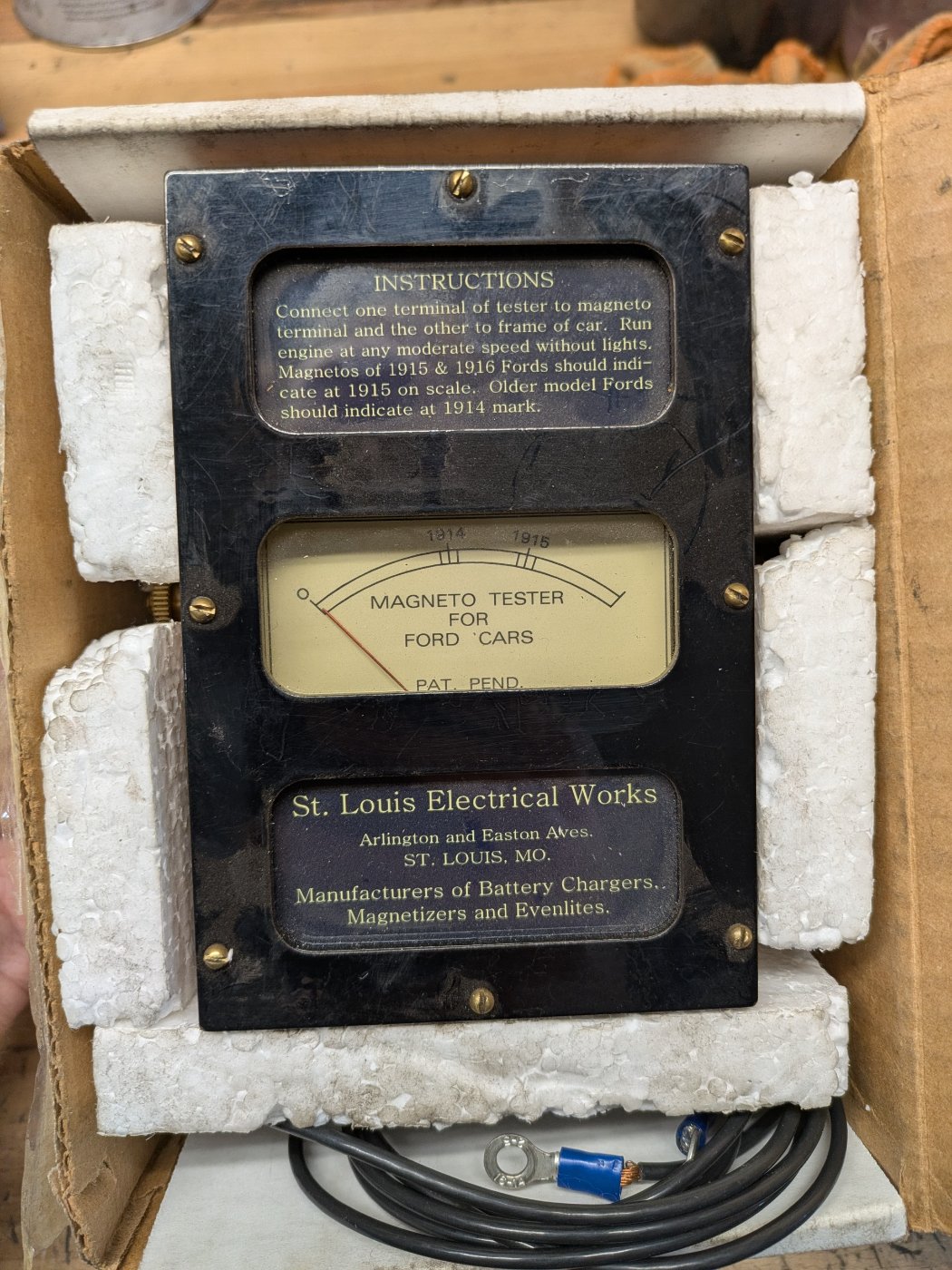

If there are any other Model T owners in your area, see if you can borrow a Fun Projects replica "St Louis Magneto Tester" or Mike Kosser's ECCT with the software to check the magneto output. I can speak from experience, with the replica tester, that it is a great way to determine how healthy the magneto is on your engine. If the reading spikes to the 1914 level while doing a brisk 1/4 turn by hand, then the car should easily start on magneto by hand. I have used my tester when rebuilding T engines after I charged the magnets and got the magneto gap set within Ford limits to make sure that magneto was working properly BEFORE finishing the engine assembly.colonelpowers wrote: ↑Tue Feb 17, 2026 10:37 amI know that y'all will be able to tell me what magneto output should be when hand cranking the engine. I am getting around a volt which seems like it is probably way too low.
With the car running at idle, I get a reading closer to the 1915 reading. I believe for 1915-1916 years, the magnetos put out more because the headlights at that time were also powered by the magneto. That is why there is a higher mark labeled 1915. I seem to recall that later cars that used the generator for lights had reduced magneto outputs, perhaps closer to the 1914 and earlier cars.

The St. Louis Magneto Tester or ECCT Magneto Test are proper ways to judge the health of the magneto to properly operate Model T coils at normal engine speed.
