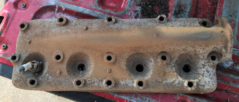

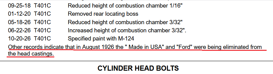

One other not so obvious check is the head.

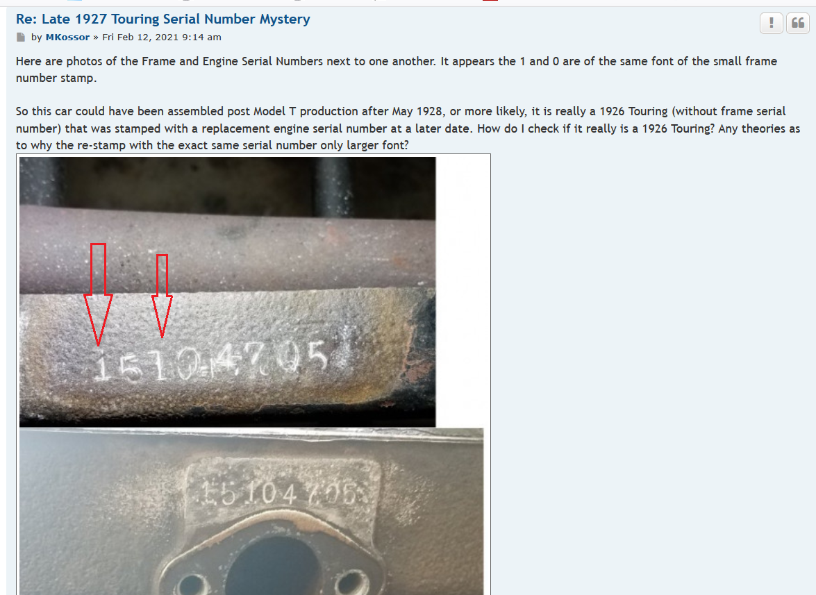

The answer to this posting is that it is likely a replacement engine and the frame was "corrected" to match saving some of the original numbers. Obvious the the the last 1 of 1 5 1 is a misfit

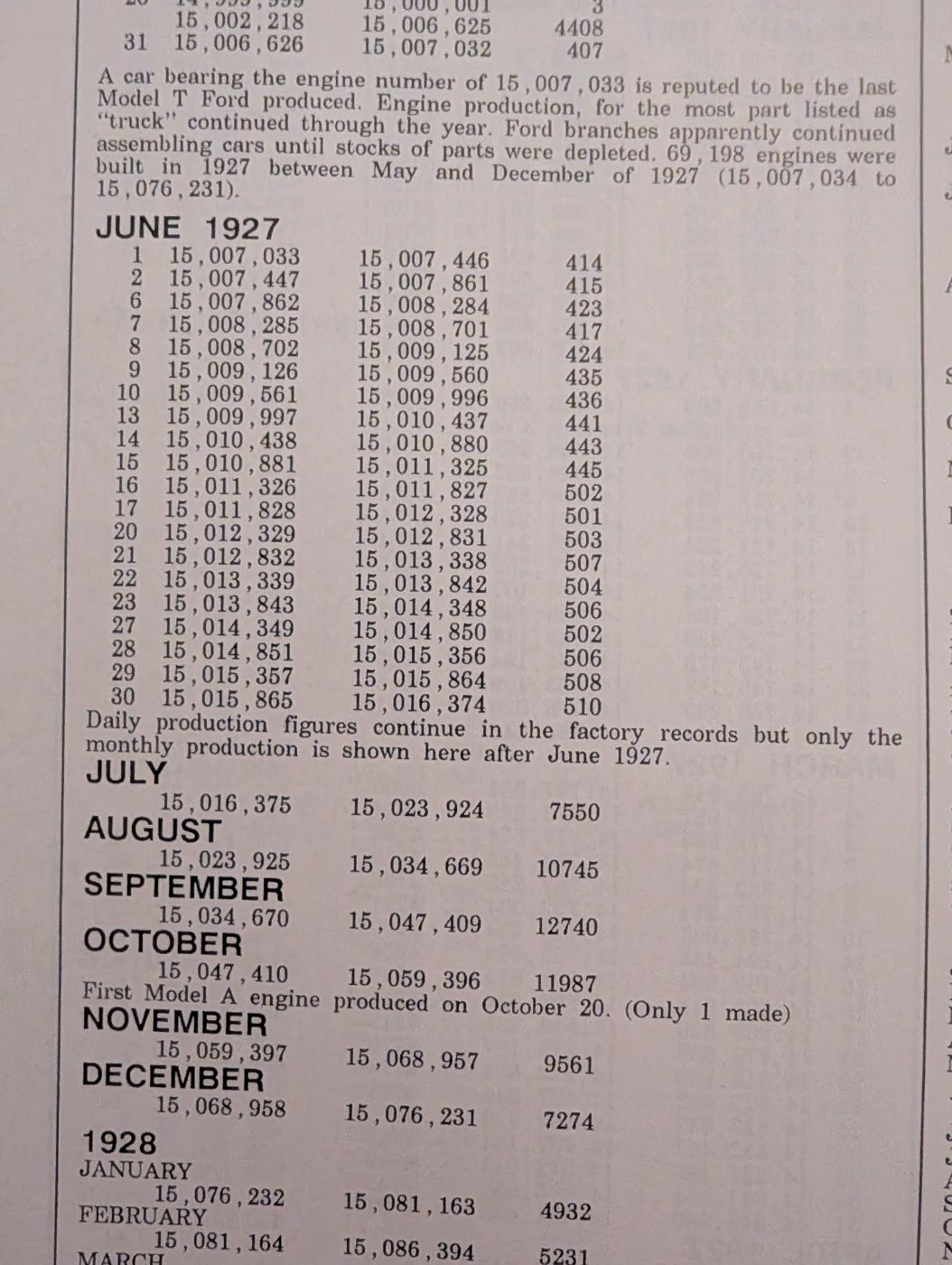

McCalley's book lists the last car engine built, the rest are referred as truck engines..... Your engine could have been made in March of 1928

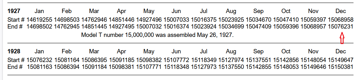

Mike, from the old Encyclopedia list of #'s, your 15,095,965 appears to have been assembled
in April of 1928. The last, #15,176,888, was assembled August 4, 1941.

Somewhere I read that TT trucks were assembled way past the date of the last T car on the assembly line. Seems like they were assembled into the Fall of 1927 when the change over to Model A production was in progress. I know this to be true because last year, a local club member sold me a late 27 number block which he said he was told by the person he got it from, came out of a truck. I was hoping the number was near the end of car production, but when I looked the number up, it was way past the last T car number. Months after buying the motor, the club member who sold it to me, asked if he could buy it back, as he had a 27 roadster with no motor. I didn't need the motor desperately and hadn't done anything to it, so I sold it back to him.
