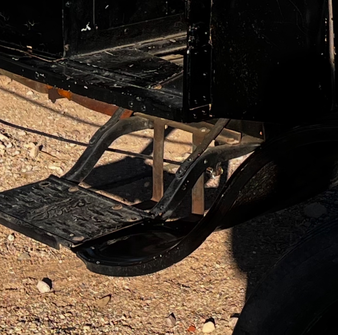

I second George. My TT actually has battery holders on both sides since it used to have 2 batteries but now I only use the holder on the drivers side since I converted it back to 1 six volt. This is the best picture I have of it currently. Hope it helps.
