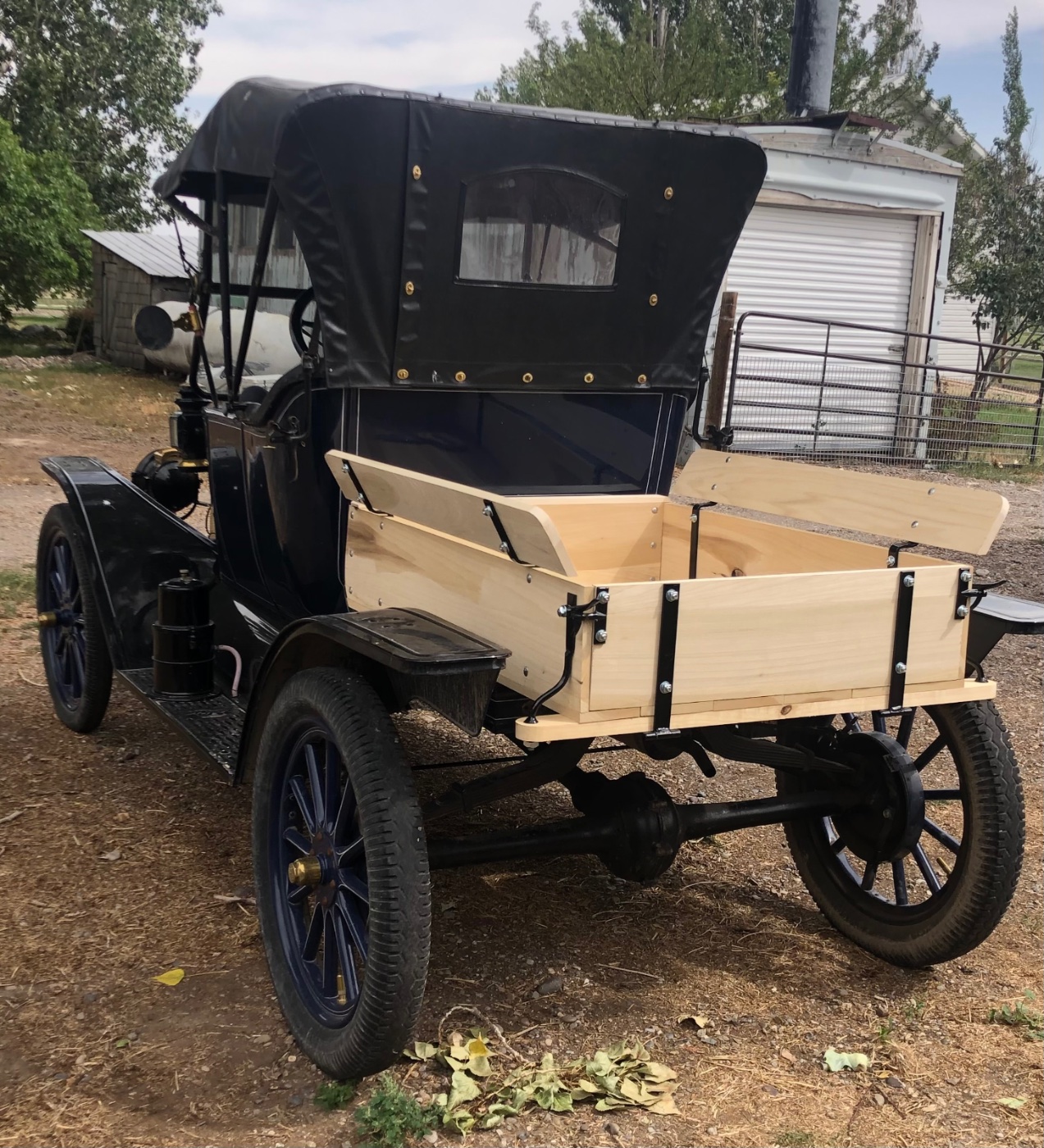

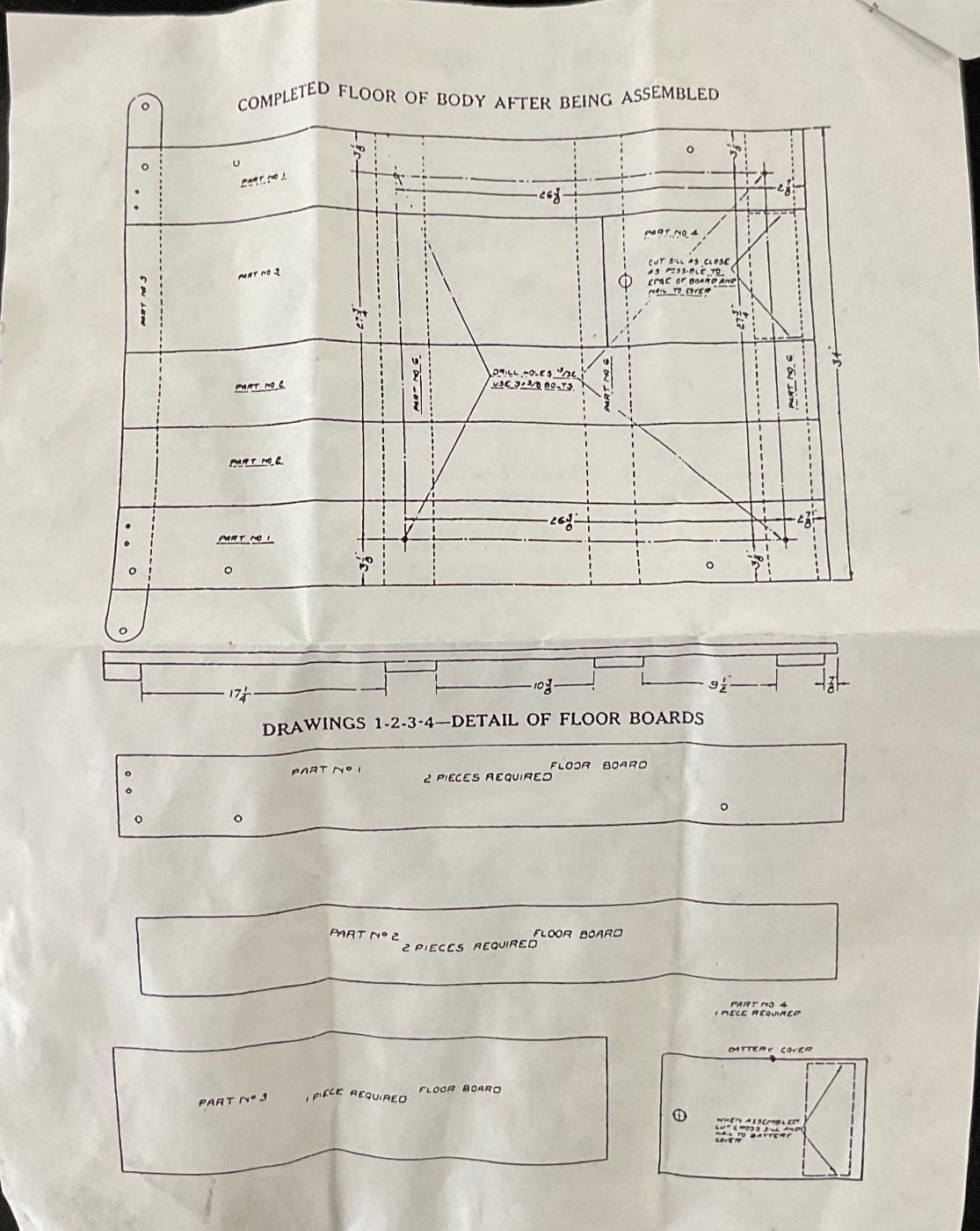

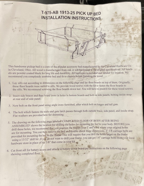

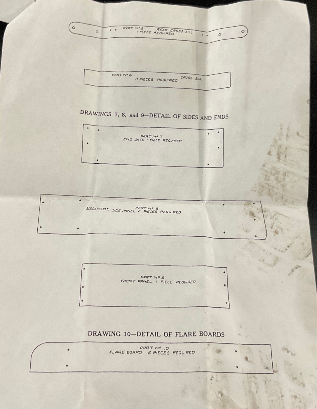

These are the directions that come with the bed that my wife bought me for Christmas ( great wife!)
It took an afternoon to build and install, they are well built products.
I can take pics of it installed if that would help.
