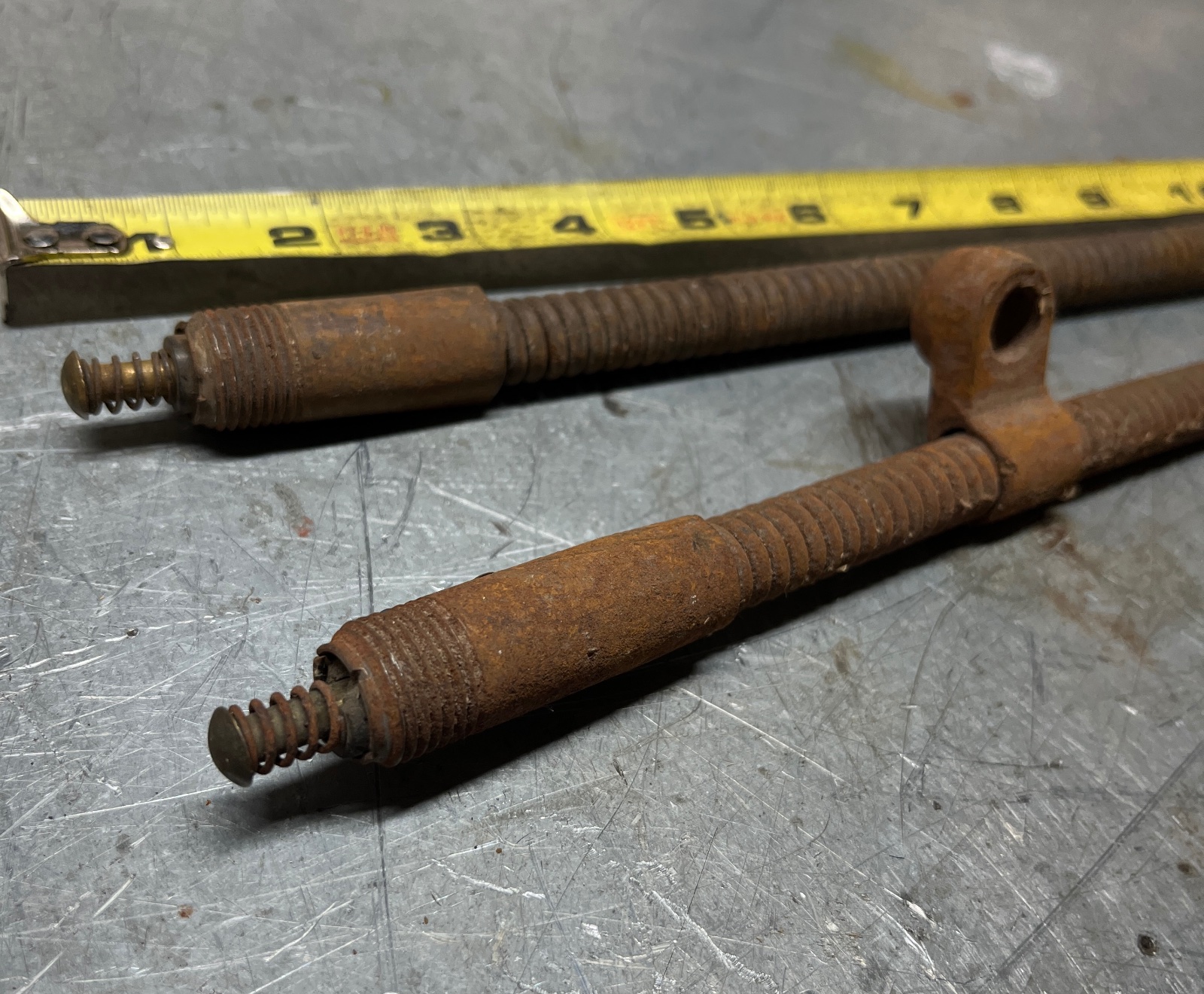

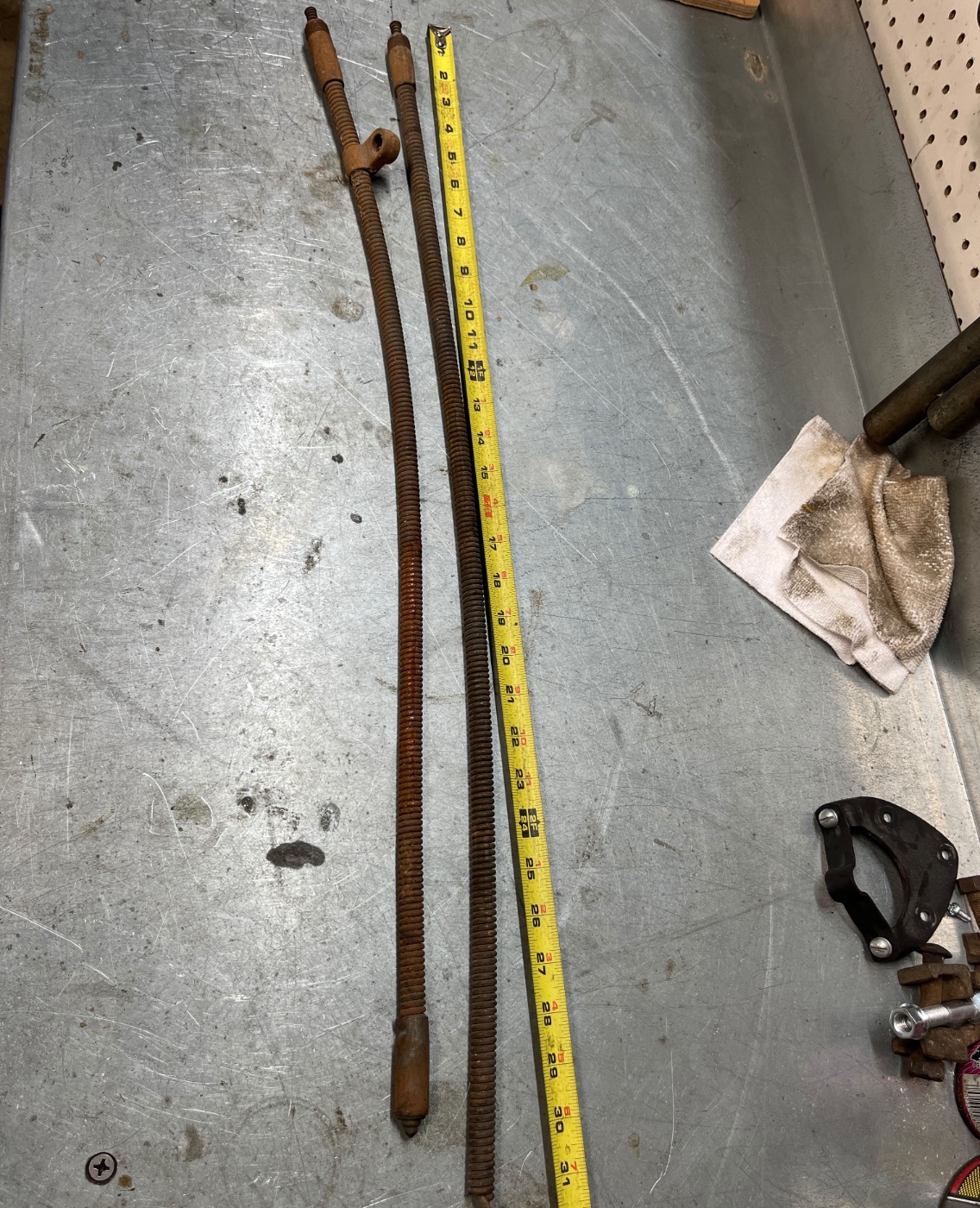

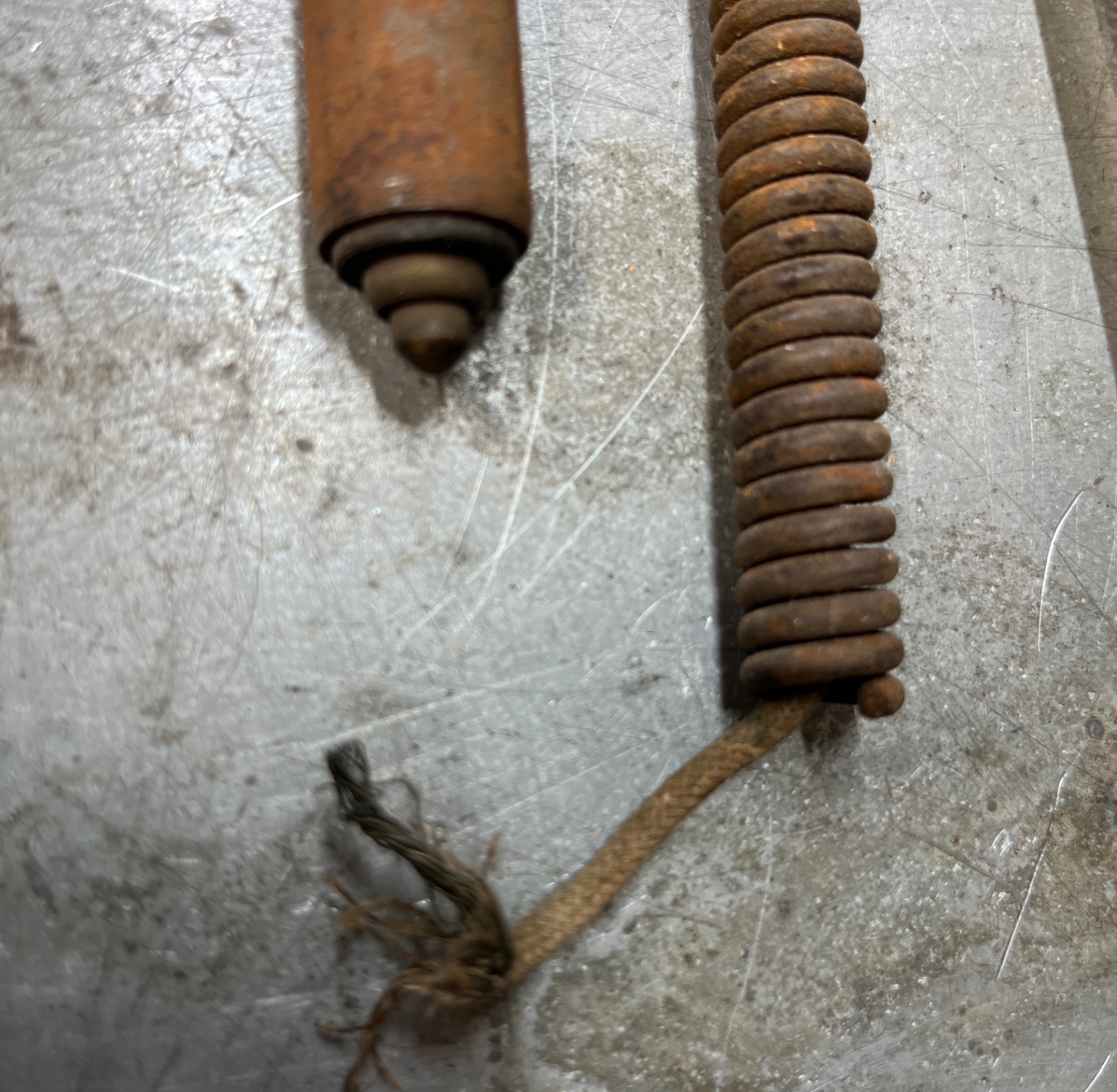

Hey guys, need some help identifying these two wiring cables. One is a few inches longer than the other. They have a spring and a brass contact on the ends. If you guys have any idea what these are for let me know. Thank you. Appreciate it.

Ford Model A Pop-Out Cable, from the switch to the distributor. The one with the forged clamp for the head stud is earlier.
