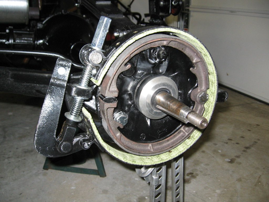

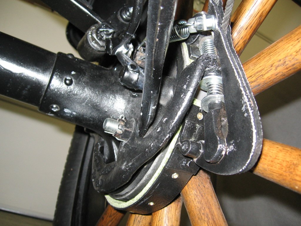

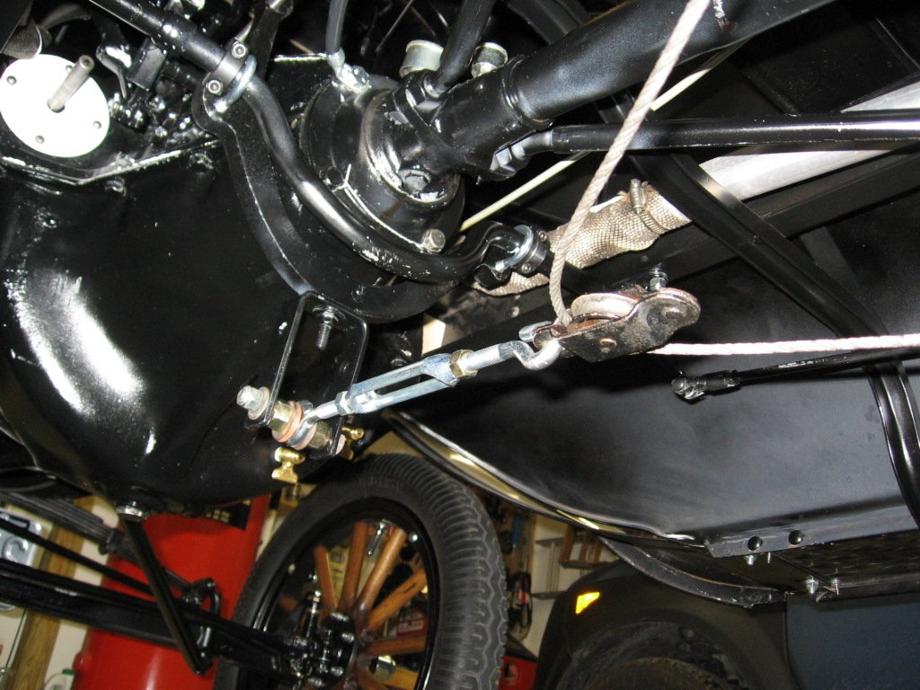

I use one to actuate my homemade pulley & cable setup that goes to my original AC brakes. Works well for me.

The original RM & other brands used a cable set up & equalized by pulling the center of the cable with a pulley. No additional equalizer needed.
Vendors offer an equalizer to convert large drum parking brakes to a service brake. The lining surface is close to equivalent to a RM outside brake lining set. Great way to save money & they work in both directions. You will have to assure no grease leaks onto the linings.
As far as converting lined small drum parking brakes to a service brake. Its doable, but you would want to sync your transmission brake so they work together. I have a small drum outside lined brake band (like an AC). The transmission brake is synced to it. They work excellently. I still have lined parking brakes as a separate system.
I would not convert a small drum parking brake to a service brake. You have no backup on an already marginal brake system.

A-C's rod version used an equalizer, which I think would be a good idea with rods. Even better would be to have the equalizer have limited travel such that if one side failed, the equalizer could only pivot so far and then still pull hard on the remaining rod. That would take a little detail work to tune in but doable. The cable over a pulley solves this problem, though.

I use the original pulley and cable arrangement that Rocky Mountain supplied when new. No problems. This is for the small drum brakes. I can't say I've ever seen an original equalizer made for the 1926-7 Rocky Mountains.
