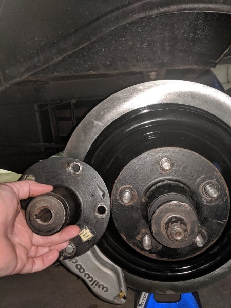

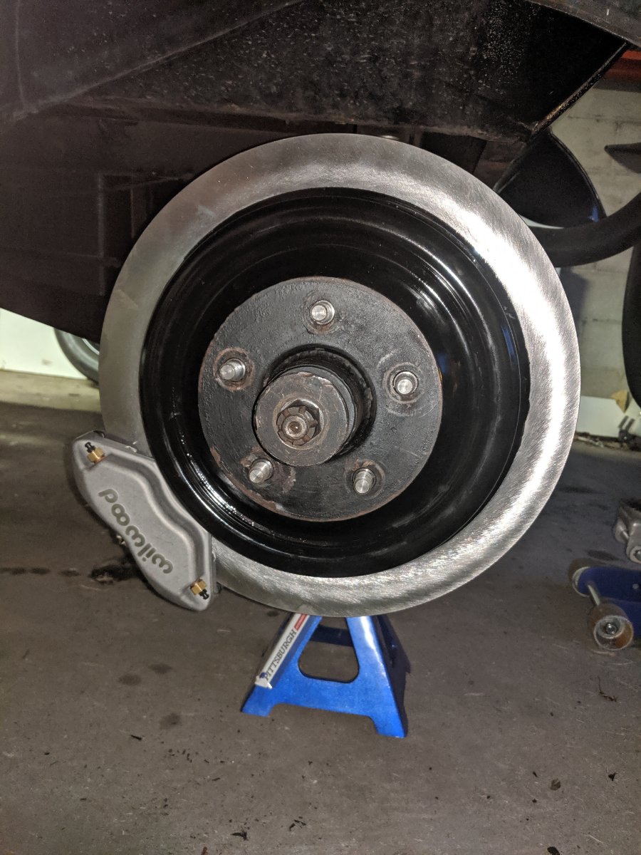

So there I was last Friday beginning the installation of my new disc brake kit. I had made good use of the 10 days since I sent in my brake pedal for modification by gathering my tools and preparing the work space, so when the kit arrived on Thursday evening along with my modified brake pedal I was ready to jump right in on Friday.

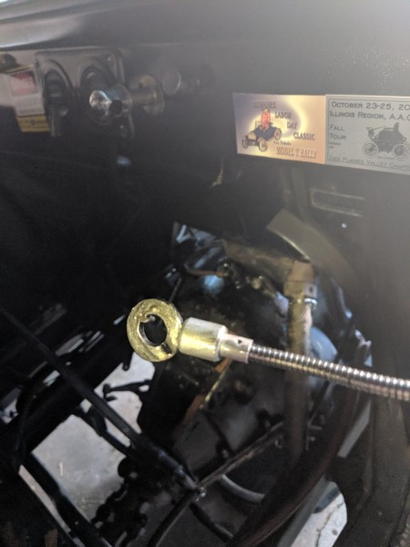

Having learned my fate, I went and bought the only two such telescoping magnets in stock at my nearest big box store, one large, one small. I bent the shafts to get around the drums and spent the next two hours fishing around to no avail. I stopped trying when one of the shafts split and I was afraid of it breaking off down in the transmission.
Next, I drained the oil to try and drive the washer down to drain hole. This was particularly annoying because I had just changed the oil last weekend and had only driven about 15 miles. I crammed my fingers in that hole to feel around but found nothing. I used a strong magnet all around the bottom of the pan to try and drag the washer to the drain hole. No dice. I shoved a stiff wire in the hole to feel around, trying to locate the washer. Nothing.

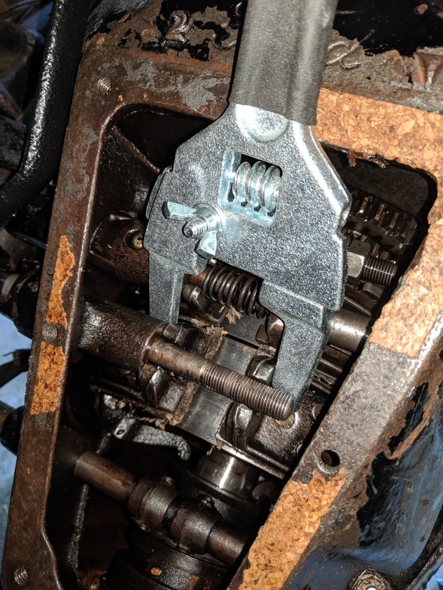

Before removing the hogshead I searched everywhere for a flexible shaft magnet and found one in stock at a big box store 30 miles away. When I got home I fed it into the transmission and began fishing. The flexible shaft was much easier to work with and got around in there much better than the telescoping shaft.
And I began to get aggressive. I was annoyed, angry, and despondent and I wanted that washer out NOW. You know what happened next.
The flexible shaft magnet got hung up towards the front of the transmission; it would move down a little bit, but would not come back up. I stopped, stepped away from the car and put my head down.

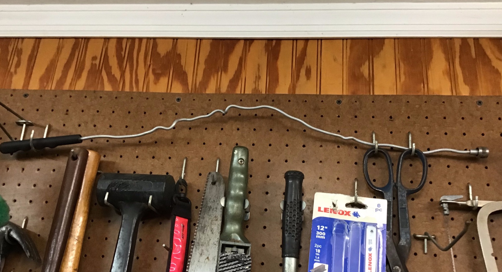

Use only floss now, but with two strands on each nut and washer over the abyss under the trans. cover.
And keep that tool at the top of the pegboard, like a fire extinguisher, just in case

Re: "Pride Goeth" or "The 15 Mile Oil Change."
Maybe try a camera for tight spaces. Thats a pretty big object not to see with a scope camera. I have dropped things and spent hrs looking for it to find it later on the other side of the shop.
Only one guy claims that he saw it fall in there, hmmm? Did he maybe then sit on a bucket drinking beer while you were rooting around in there looking for it?Jed wrote: ↑Mon Jul 15, 2019 1:05 pmWe managed to drop the "Shift nob" for the Ruckstel shifter into the transmission. yes, we amateurs that we are, had the cover off. We have drained the oil, made wire grabbers and pushers out of coat hangers, and felt around with our fingers from the top and up the drain hole. We cannot prove to ourselves that it is even in there and my partner swears he was it fall in. Our T sits on a concrete slab with nothing near it, so we would have seen it if it fell somewhere else. I have been under the car and looked and felt everywhere. Please, does someone know something else we can try before we have to pull the transmission. Could the knob have made it's way into the pan ?
Seriously though, I don't see how there's room for a shift knob to fall all the way down in there. Seems like it would at least get hung up on the clutch forks or the side of the drum.
Here's a few annoying questions: Did you check the lip between the base of the Ruckstell shifter and the transmission? How about under the car resting on the inside of one of the tires? (The knob is black and it might blend right in there if you're not looking for it.)
Like Dallas says, maybe try a borescope.

Quick update on the install of the disc brake kit install that started this thing:
I got the assembly installed on the driver's side without incident.
Passenger side hit a snag though. The hub is a slightly smaller diameter than the drivers side and the lug holes are a smaller diameter than they should be so I can't press it onto the new drum/disc. And there's a tag on it that says "Made in Hong Kong."
And everybody seems to have wire wheel rear hubs on back order. So there's that.
I've been thinking about taking this hub over to a pretty good machine shop over here and having the lug holes widened to the correct size.
