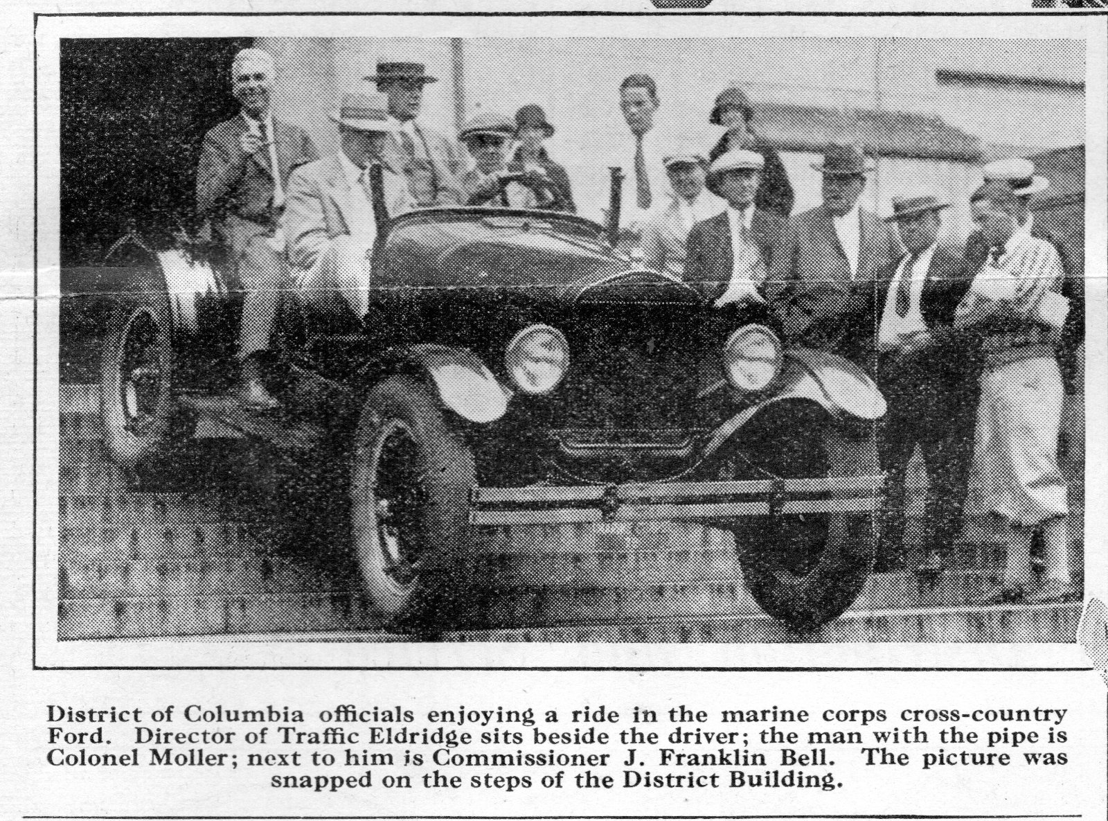

It seems that problems presented here by some were not problems at all. No great modifications were needed to the steering, the disc wheeled balloon tires gave extra height to the vehicleand better ride over rough ground, the disc wheels did not clog with mud easily and no alternative steering box was needed to replace the Ford one. A larger steering wheel and a strengthened drag link was used and it was decided by the Army and Marines that the cheaper 30 by 5" balloon tire was satisfactory so the airplane Balloon tire version was eliminated. As the Army spent several years (1920 to 1926) and ended up with a balloon tired Ford with very capable off road features the system obviously worked.

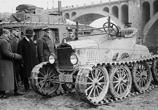

These vehicles were a further experiment after the Chase tracked Ford offered to the Army after the war proved unsuitable. The track design prevented fast speeds and tires were quickly destroyed by the track. At the time materials available to make the tracks were not good enough to handle the forces involved. You have all seen the Chase track Ford at Ford Benning,
This led to the Army going a different way and the Ford was the most suitable chassis to make what was first called the "reconnaissance" Ford but later changed to the "cross country" Ford. The Model T was cheap, strong, light and already proven in war for its toughness and reliable and extra parts to improve its capability such as extra gear boxes for better climbing and heads to improve power were available. The Army used accessory Ford products available to improve their vehicle capabilities so purchasing the Buffalo disc wheels was an easy fix. The Army design made alterations to help the vehicle perform better, they lifted the frame added canvas mudguards for certain variations and had different body configerations depending what exactly the vehicle was meant to do. None of these vehicles had imput from Ford they were redesigned to do a job for the Army/Marines in case of war. The exercise was to have available a vehicle which soldiers could use on the battle front. After the final designs were shown to government the specifications were filed as in 1926 no one saw any hint of a future war. 1939 changed all that and with advancments in engineering a new specification for the Jeep was developed and sent to contract and the Model T was long gone.
Included in the Jeep specifications - light weight, high ground clearance, short wheel base etc was "4 wheel drive". Jesse Livingood always believed the Army (or by someone who passed it on to them) had stolen of his 4 wheel drive Model T in Chicago as he had been told it was sighted at the Aberdeen proving grounds, the same place the Army's cross country Fords were developed, so did the Army add 4 wheel drive having tested it with Jesse's 4 wheel drive Ford and knew it was a distinct advantage to have it included.
Here is a copy of the Marine version of the cross country balloon equiped vehicle as well as the Chase tracked Ford.
The balloon tires on disc wheels have a demountable rim with tire mounted on the side of the vehicles which would make it easier to change a flat tire if required. No one was trying to mount balloon tire on rims for high pressure tires, the balloon tire had their own disc ( and wire wheels) made for them, thats what the Buffalo wheels were advertising - a new better softer riding wheel for the Ford and other makes.
