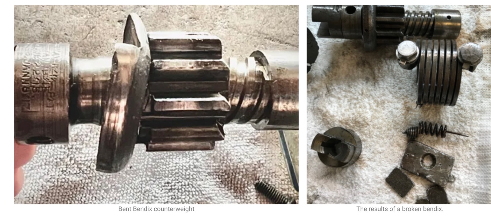

Is the starter a regular Ford T 6 volt starter? If so, using it on a 12 volt system is likely to result in damage to the starter drive and perhaps to the flywheel. There isn't a good way to reduce the voltage to the starter when it is first engaged, which is when the reduction in voltage is most needed. A 6 volt starter can be converted to operate correctly on a 12 volt system, and starters that have been converted may be available. New, non-original 12 volt starters are available.

It's credibly said that the resistor method will do little to reduce over-strain on the starter drive, since the applied voltage will be 12 volts when the starter is first engaged and before the starter motor is actually cranking the motor. It's normal with a 12 volt system for voltage at the starter to drop to around 10 volts when the starter is turning the engine. Under the same circumstance, a 6 volt starter operating on a 12 volt system will cause the voltage to drop lower yet, owing to its having far less internal resistance than a comparable 12 volt starter.

It's worth noting that the flywheel ring gear is not easily replaced if damaged, and broken starter drive parts can cause serious damage to the transmission and the magneto. Beyond that, even if the starter drive does not fail outright, operating it on 12 volts can be expected to generate an abnormal amount of metal particles which will circulate with the oil to all parts of the engine and transmission. I'd use the correct starter, or use the hand crank. The 6 volt Model T equipment works very well, especially when paired with a modern voltage regulator and LED lights.

Over the years I have seen different attempts to drop the voltage from using a bendix spring, to undersized cables, to longer cables, to resistors and they all do something to varying degrees.
I have also seen people who just run a 6V starter on 12V and hope.
They will all work for a while and eventually be an issue.
They will all work for years so the owner will declare them as no problem.
Even the original 6 volt setup needs repair eventually.
A good starter setup at 6V has worked fine for over 100 years now.
Personally I just leave them stock, and if there is an issue with using 6 volts, I fix it.
I don't consider the risk of damage worth feeding a 6 volt starter with 12 volts even with one of the "fixes".
The harder impact of using 12 volts will wear out parts faster.
And I don't advertise to everyone that I use 12 volts every time I start the car from the sound it makes. They sound wrong to me.
But I will admit that a couple rare instances forced the car to 12 volts and I have converted the stock starter to run 12 volts.
Given the difficulty of converting the starter there needs to be a very important reason for me to do so.

Resistive solutions, such as using a starter spring as a resistor, don't do much to protect the starter drive since the starter motor doesn't draw much current UNTIL the starter drive is engaged and the engine is actually being cranked by the starter, at which time the current draw goes way up. Another drawback is the fact that the spring/resistor doesn't have much resistance until it gets hot, which it will only do AFTER the starter drive has slammed into engagement and starter is cranking the engine. If the engine does not start readily, the resistor spring may get so hot under prolonged cranking that it actually reduces the voltage at the starter too much, thus making hard starting even harder.

Here's what happens when you shove 12v into a 6v starter.
. The Bendix spring reduction "hack" to reduce current from a 12v battery into a 6v starter is a waste of time. V=IR, I=V/R and it always will. A Bendix spring = 0.00000001 ohms (therefore useless) when you first engage the starter foot switch slamming your Bendix into your ring gear like a speeding bullet. All those "parts" in the lower right of the pic shouldn't be laying at the bottom of your engine after your Bendix self destructs...
I'm sure others have pics of destroyed ring gears from using 12v on 6v starters.
Anytime someone calls me to ask about buying a 12v converted starter, I try and talk them out of it and keep the car at 6v. Fix & upgrade your electrical wiring first. I make more on 12v converted starters and I've sold over 75 of them, but they are unnecessary. That train has left the station, and the horse is dead, no sense beating it now in this thread.
That said, I seem to be selling as many 12v converted starters as 6v rebuilds these days. I'm building 3 right now.
Jeff
