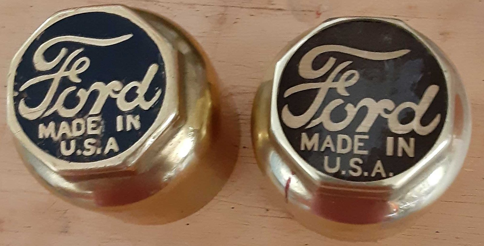

[image][/image] Then here are 2 - 1915 hub caps. One is an original, one I made. After some 30 years I finally ended up with 4 original 1915 hub caps. Ditto early 1910 hub cap wrench. One of these days I may end up with an original but until then I have a reasonable looking faux wrench

Re: early 1910 Hub Cap Wrench
