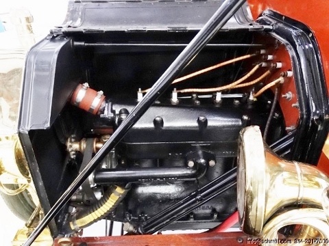

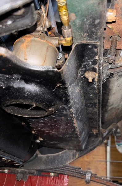

I don’t recall ever seeing much discussion on engine splash pans on these boards over the years. Just curious whether anyone has researched them, and if there is a chronology that attends changes in their form.
Question arises from an original condition ‘23 centerdoor with this pan, in 64 years of “T-ing” I have never seen one like this.

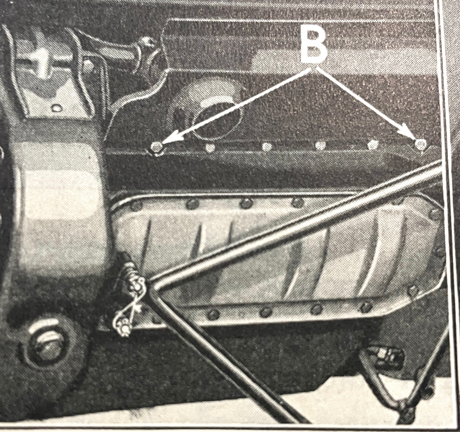

My 24 roadster had a set as shown, which was built in Nov 1923.

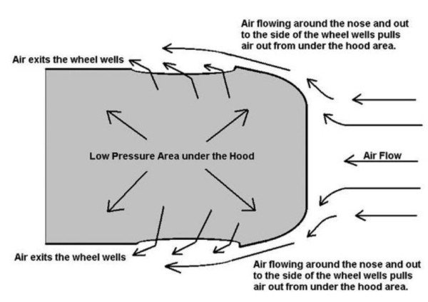

The Engine pans serve two purposes: Obvious is to keep debris (water, mud, rocks) out of the engine bay. The second is to forma negative pressure area to increase air flow through the engine bay. Thinking back: pre 2000 American cars didn't have them, now all car have pans on the underside for the same purposes.
While some think there not needed & others do. Unfortunately we have no numbers on how many cars that have had over heating problems had them on or not.
Previous discussion https://mtfca.com/phpBB3/viewtopic.php? ... ns#p366463

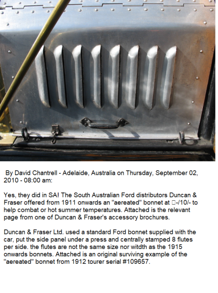

The air flow through the radiator and out through the louvers. Early hoods had no louvers, then more were added with he 1926-27 having the most

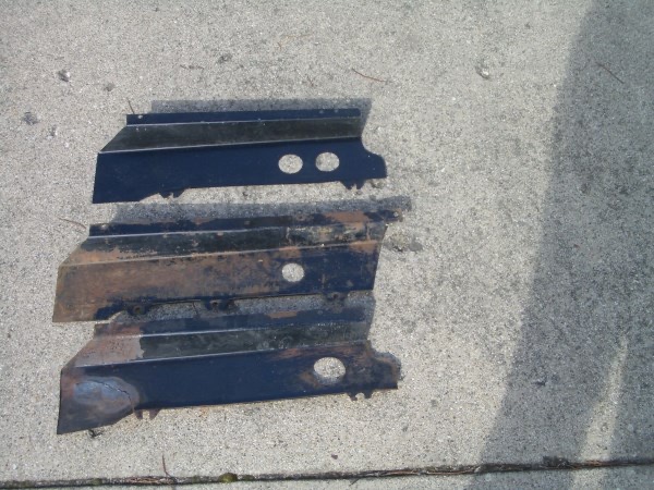

Looking at some earlier posts about engine splash pans I found a photo of 3 of different designs. The discussions had come to the conclusion that there wasn’t a clear timeline of the differences that occurred. There is one that has the oval bowl shaped into it like in the photo that’s posted that’s close but the bowl may be more shallow.

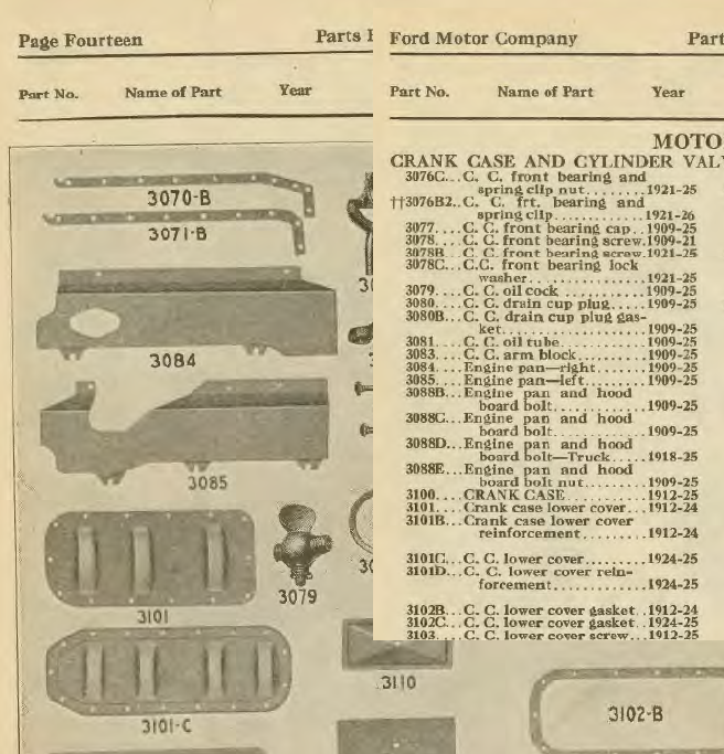

- Posts: 6586
Re: Engine splash pans

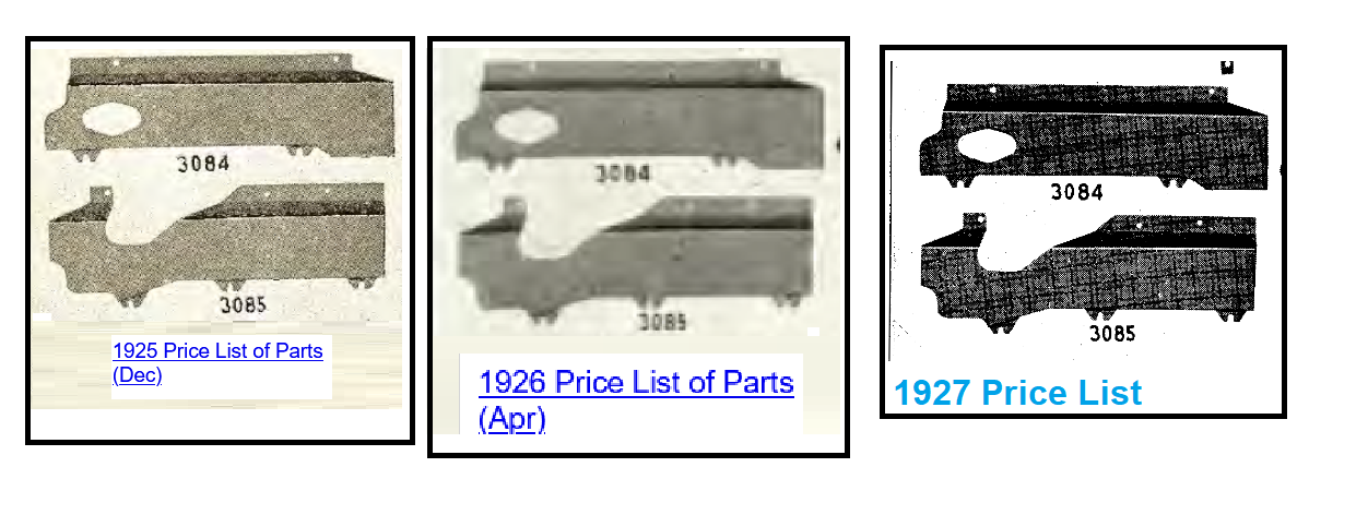

Differences
Note dates for Engine Pan in Ford parts manual (December 1925)

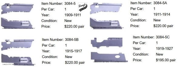

The vendor provided pictures are not complete, but instructive anyway. The vaporizer pan is not shown.
There would be a pan with the drain hole more forward OR a second forward hole.

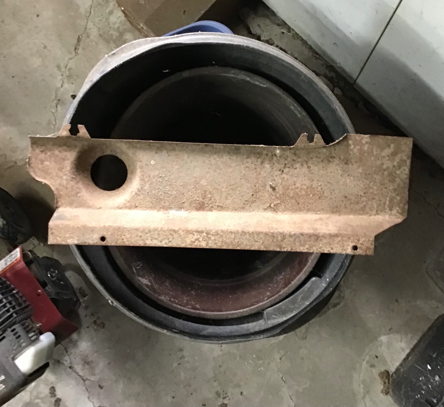

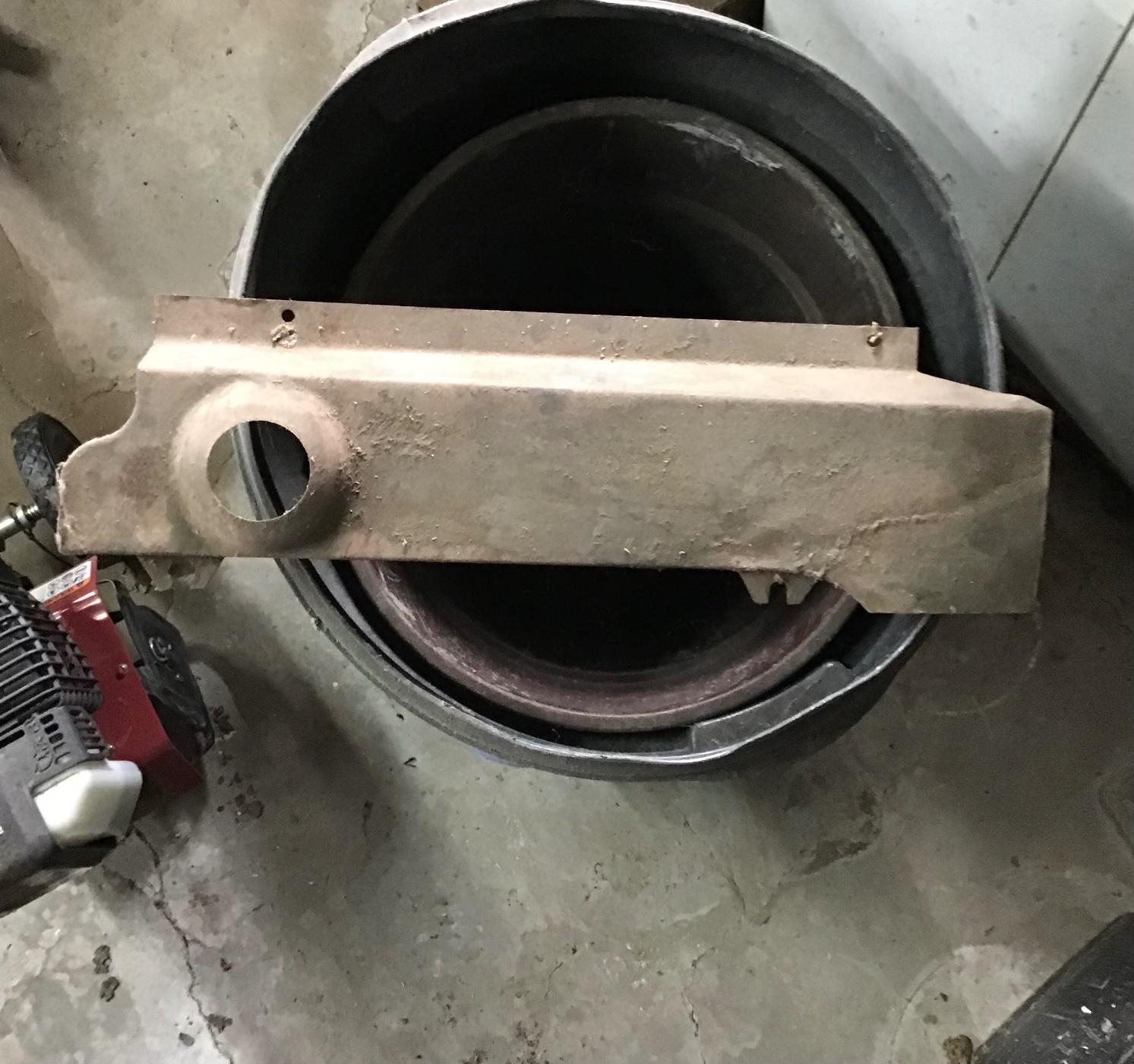

Here’s the carburetor side engine pan I’ve had since the 70’s when I bought a garage full of T parts. This pan has the round bowl pressed into it whereas the reproduction ones from Lang’s don’t and the one from a Ford parts book isn’t round or has the oval. The repos doesn’t have the round bowl pressed in the because of the cost of the press die and etc. I’m assuming.
This looks like the on that R. Bingham posted to begin with.
This seems to at least in a way from the post I found that even back then there wasn’t a a concise shape exactly for the different year T’s. I guess sheet metal makers that Ford used made the parts a little different like the body makers did. They were real close but not quite.

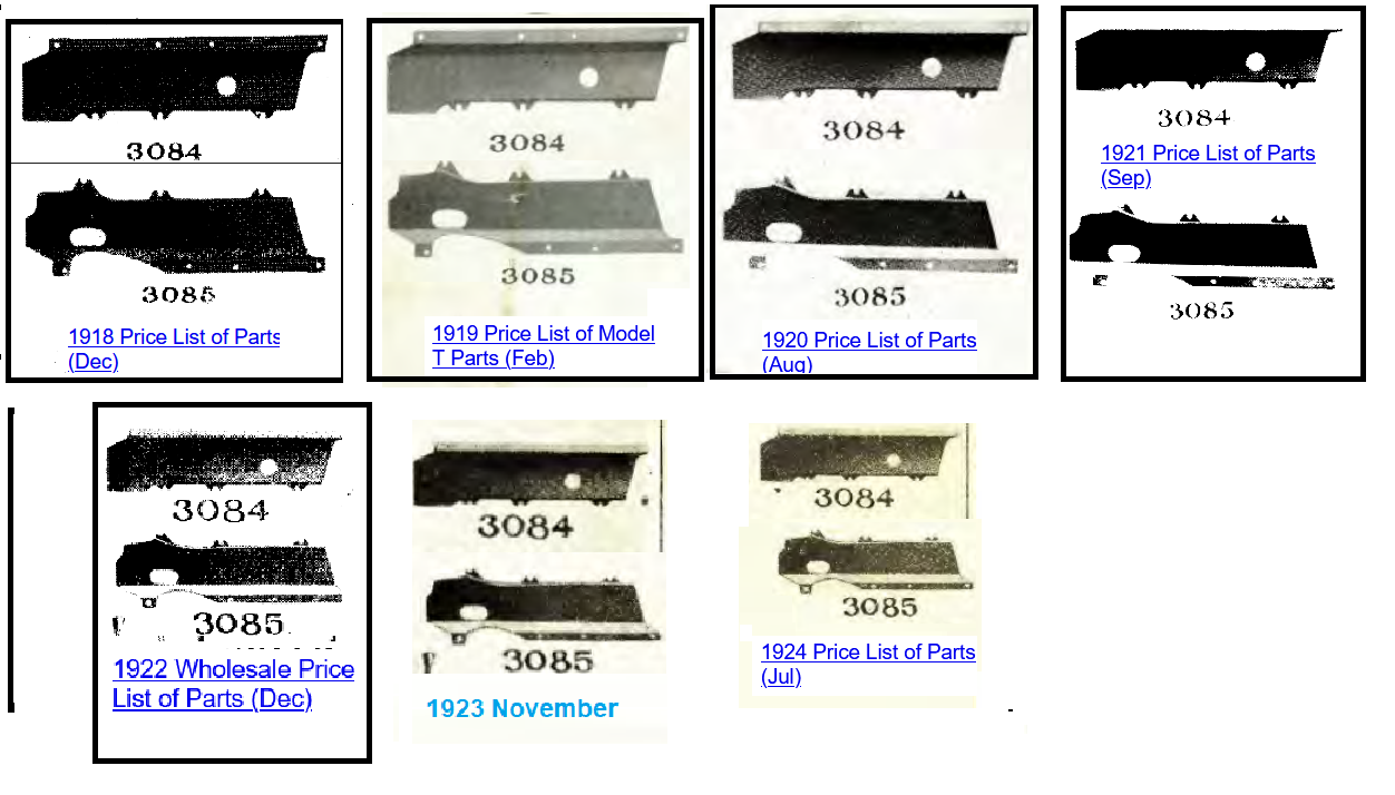

- Posts: 6586

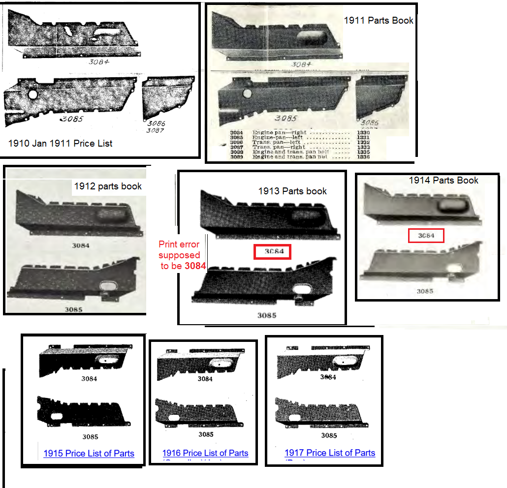

Curiosity got me to browse through all the parts books to see differences in engine pans. It appears that there are 5 variations.
Not sure how accurate parts books are
1. 1910 - 1911
2. 1912 - 1914
3. 1915 - 1917 --
4. 1918 - 1924 --
5. 1925 - 1927
1. 1910 - 1911
2. 1912 - 1914
3. 1915 - 1917 --
4. 1918 - 1924 --
5. 1925 - 1927
