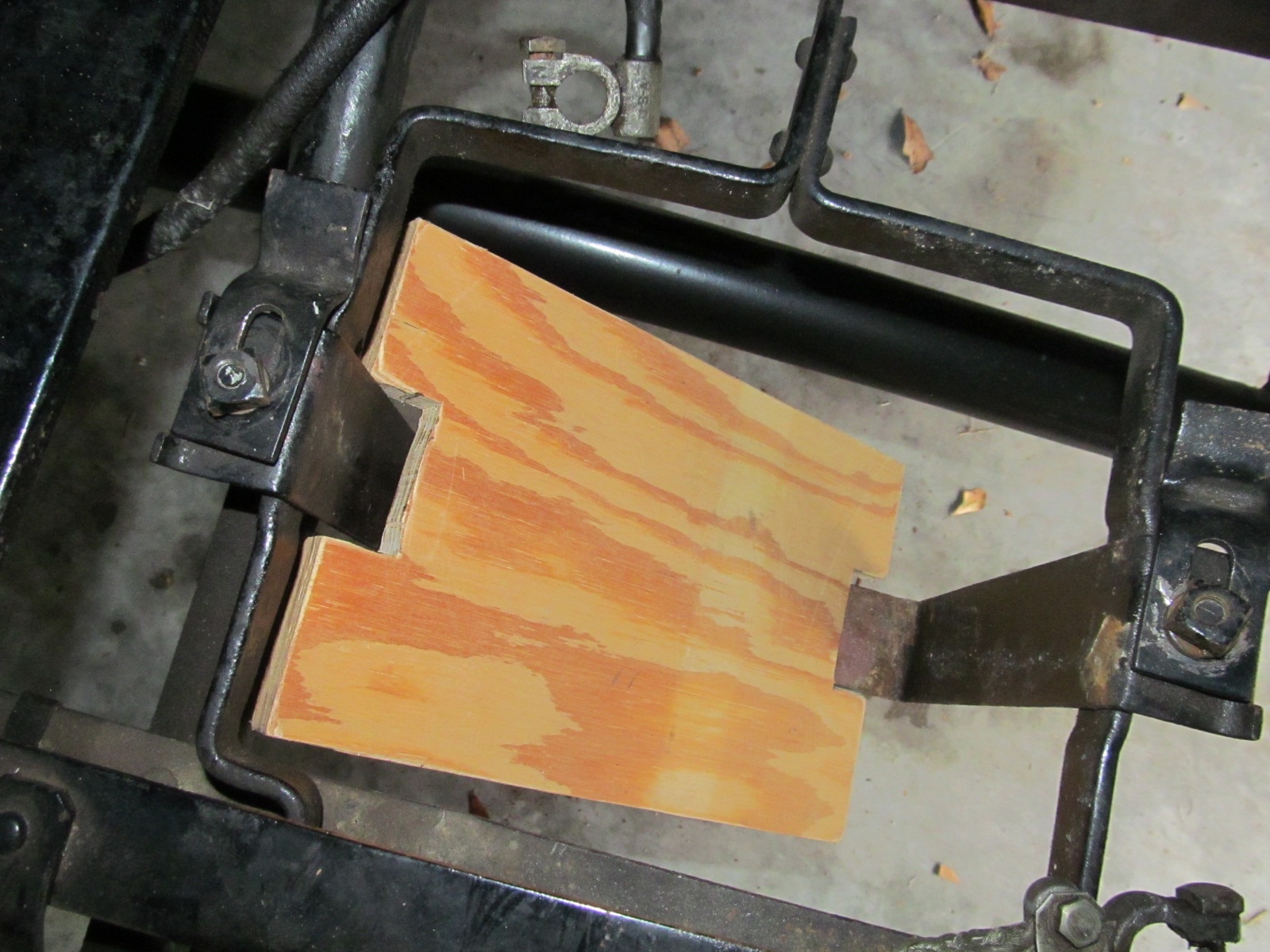

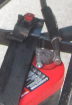

Post by Jerry VanOoteghem » Wed Mar 18, 2026 2:35 pm
I would be really concerned about the POS battery terminal coming into contact with the battery hold-down.

Post by Oldrusty26 » Wed Mar 18, 2026 3:51 pm
That’s not my battery photo, I do have the correct springs installed . I have different spindles etc , so no issues to change them out , was just questioning the spindle height difference in the stance .

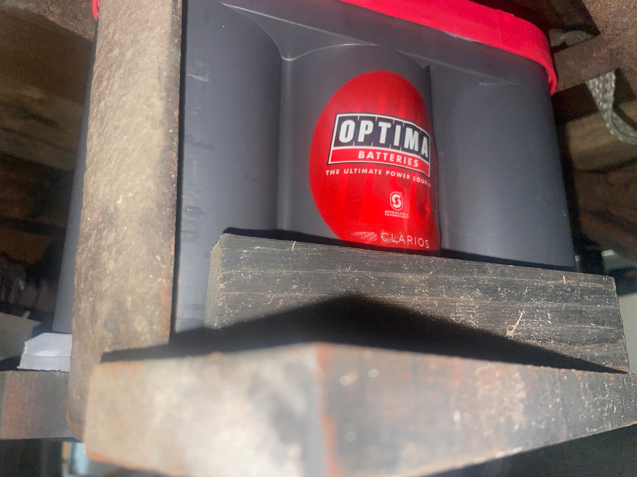

Posts: 4109
Re: Working on my 25 roadster
Post by DanTreace » Wed Mar 18, 2026 6:04 pm
Jerry
That is my photo of a '24 I did and later sold. Always have used Optima 6v batteries and make a holder to secure these oblong cases.
The lower holder is a 3/4" thick board with notches to lock into the straps of the Ford battery carrier. Then wood side braces are screwed and wood glued to the base board..... being added to prevent the oblong battery from moving, the upper wood bar then is used to lock the battery in place. The Ford battery box clamps are used to secure the wood bar.
When locked in place the battery won't move.
I learned my lesson as a teen, put a 6 volt battery in the frame and didn't secure it, figured that dang heavy battery would stay put......well it walked just enough to allow the + cable terminal to hit the battery carrier frame! Like you concerned about....agree with your concern too :o , but I have always since then secured a battery in that Ford frame. ;)

Post by Jerry VanOoteghem » Thu Mar 19, 2026 6:25 am
Jerry
... the upper wood bar then is used to lock the battery in place. The Ford battery box clamps are used to secure the wood bar.
Thanks, Dan. I incorrectly assumed that the upper hold-down was metal, and not wood. You've done a great job, as always! :)
