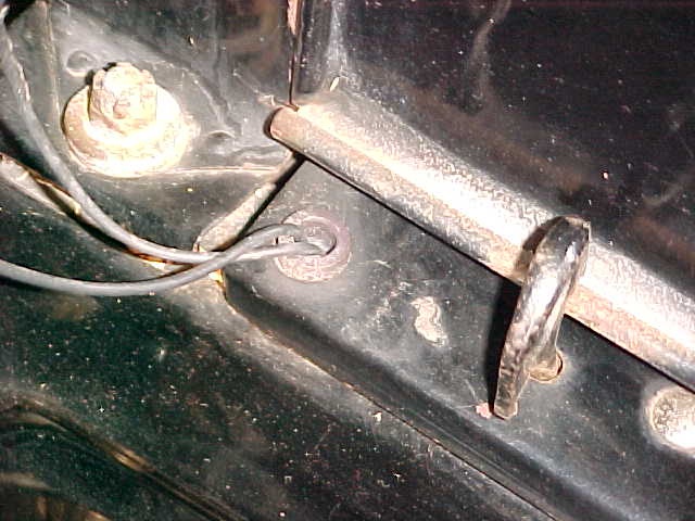

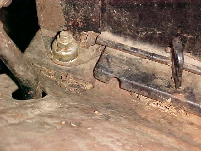

How do I run the headlight wiring through the body to the headlight on a 1920 roadster? Without the Hood landing on It.

Run under the hood shelf.
Later shelf with notch Earlier ones with grommet

On our Canadian sourced cars, the hole in the top of the hood shelf, with the hard rubber grommet, is the last incarnation. Earlier cars had the notch in the side.
