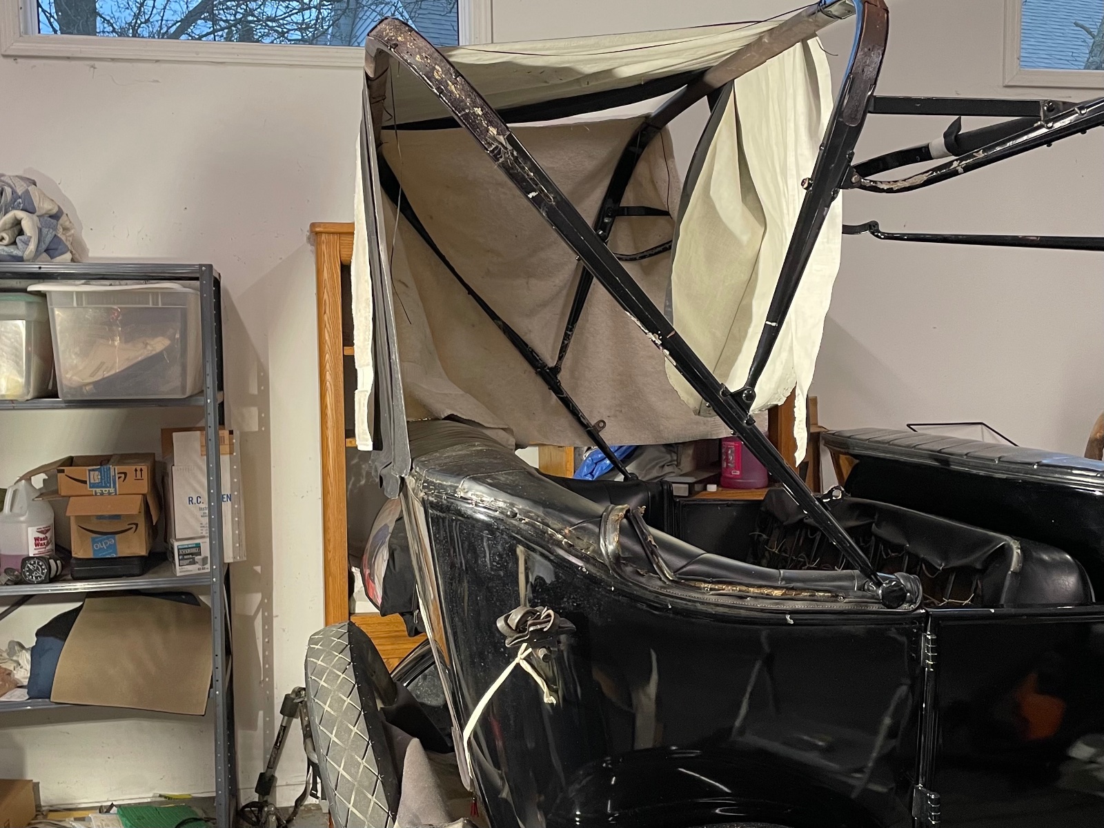

No problem PorkChops; that is my plan, starting now. I’ve never done a top before, or any upholstery for that matter, so if anyone sees me going astray please speak up.
I started today (Tuesday) by replacing the windshield stanchions with a nicer set than those that came with the car. The old ones looked nice enough, but when I wire wheeled them in preparation for repaint I found that they were badly pitted and had been repaired with body filler. I found a nearly pristine set in the classifieds here a few months ago, and got them cleaned up and painted last week.
I then started to pull staples.
Upon getting the main top panel loose from the front three bows, I noticed there were no straps between the second bow and the header, none between the rear and second bow, and no straps inside the pad covers, as called for in the Classtique kit and all videos I’ve seen on the subject. The only fore/aft structure was the pad covers, and the only structure between the rear and second bows was the rear panel itself. The top always stayed neat and tight (except for the broken bow), so I’m guessing that whoever installed this top was good at upholstery, but wasn’t very familiar with Model T’s.
Before removing the pad covers I raised the top and reattached the header bow to the windshield so I could take measurements to compare with Rick Duquette’s sketch. The rear bow is a full 4 inches higher and nearly 5 inches further forward than it should be, and the 3rd bow is 4 inches higher than it should be. Fixing these discrepancies should improve the look, and maybe lower the top enough to go in my enclosed trailer with the top up.
This last photo is where I ended up tonight. After removing the rear panel I’m going to remove the bow assembly from the car so I can clean and repaint it, replace the 3rd bow, and wrap the bows.

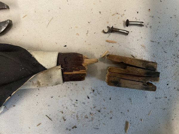

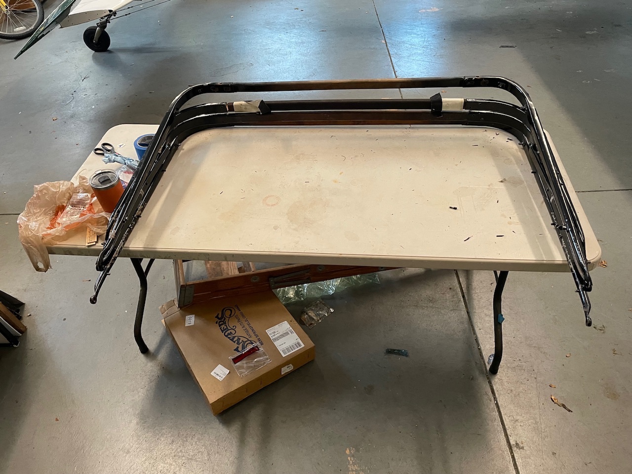

I got the top frame off the car today and removed the broken third bow. One thing I hadn’t noticed before is that the bows are slightly arched over their length, about 1/8” on the front and rear, and about 3/8” on the middle two. My plan was to buy some white ash stock and have a friend with a wood shop plane it to size and round over the edges. Since the third bow (counting from the rear) is nearly horizontal, would it even be noticeable if I left it straight?

- Posts: 4496
Re: New Classtique Top for my ‘24 Touring
Miles,
When I replaced the front bow in my Touring car, I purchased a full set of bows and used only the front one. I have two left. One is 41-1/4" long and the other is 40-1/4" long. They appear to be white ash and are trimmed down at the ends to fit the bow sockets. If those dimensions suit your project, you're welcomed to them. Let me know.
