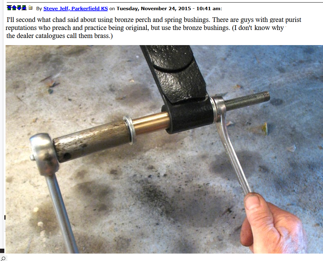

I use the Steve Jelf method for perches, springs, tie rod, etc . Bolt nuts & washers to size. works great

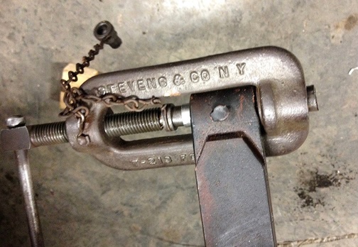

Stevens “Force out tool.” Here is picture

Beating them in with a hammer, even with a 'driving tool' never worked for me. As Steve Jelf says, "It ain't rocket surgery", use his method, simple cheap, effective, and inexpensive. Check the OD of bushing and ID of the part, I like them the same or at most half a thousandth interference. Be sure the bore is free of burrs and rust, if needed, gently ream but don't enlarge the bore more then the OD of bushing. Use a 'high pressure' lube like wheelbearing grease NOT WD-40, very slightly taper the entering end of the bushing, and go slow initial alignment is essential. Good luck.

Personally I have never used the brass bushing so I may not be of any help, I have not had a lot of trouble installing them. I use the
All-thread & washers method unless the parts are loose & can be placed in the press. If they don't want to start by hand or a little tap
I throw them in the lathe & take a little off one end to start them straight. Make sure the spring eye or perch is clean of rust & burs
Throwing the bushings in the freezer is never a bad idea (That is why you told the wife you needed a fridge in the garage wasn't it) I also
use that nasty Never-Seize stuff, that is one reason they make it. On both parts & the threads & washers on the All-Thread.
Craig.
