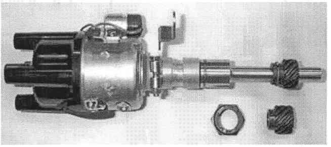

Thanks for the help. So yes it is a repro front plate that replaces the front cover with a 009 distributor. The gear fits onto the camshaft with teeth that mesh and the nut to secure it.
Jerry are you advising to use motor oil on the felt under the points assembly, and this will lubricate the rotor shaft? I'll check the dist to see if it is so equipped.
I may need to pull the cover again and verify the nut is on correctly or just peen the threads. [image][/image] the attached image is a screenshot from Chaffins website that is the dist we have.
- Posts: 4485
Re: Lubricating a bosch front plate distributor
Chuck,
Much of my advice was based on an original Bosch distributor. I'm not familar with using and maintaining a 009 unit. It turns out I was also mistaken on the one-piece nut/gear. What you have is the original style nut & gear arrangement for a front plate unit.
