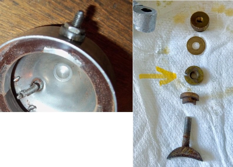

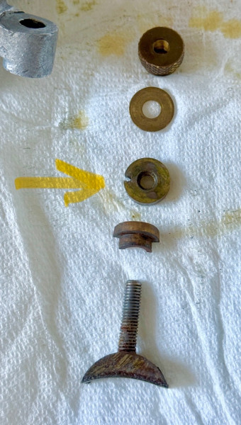

Just a "heads-up" - the starter switch installed in your photo is NOT a good reproduction - it might work a few times, but the button rivet usually comes from together & launches the button or gets stuck engaging the power - not a good scenario !

When I took the picture I thought to myself. “I wonder if anyone will say anything about my starter button” LOL! Yeah I bought that when I got the car before I joined MTFCA. I have read the stater button topics. Yet again I will be re engineering a part…. Unless a good original shows up on the classifieds.
