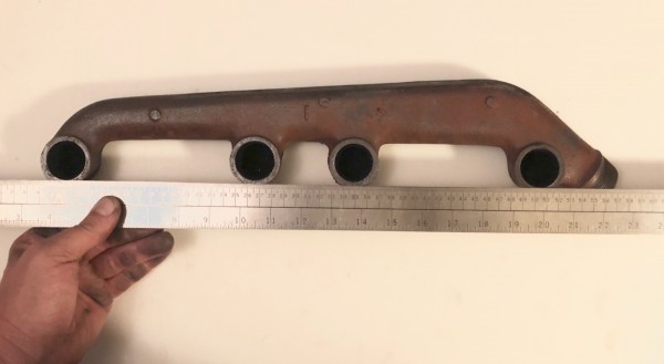

I hear ya Bruce. I went through all of that. It’s an NOS exhaust manifold and a well seated intake manifold so I don’t see any way for a vacuum leak unless there is a crack I can’t see. Stan made the float the way he makes all of the ones for the U&J. So, I don’t think it’s anything related to Stan’s rebuilding and I don’t really mean to imply that. Might just be this particular carburetor and I only thought that maybe tweaking the jet might be an option. Are you interested in giving it a try?
I did like the NH straight-through carb a lot, but this U&J does give me some more hill climbing ability and the idle is very low and even.
