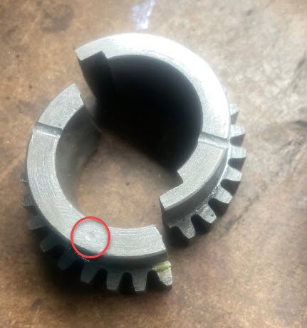

Thought too the triple gears, so when inspecting after disassembly, every thing was pretty ok, clutch spring and drum ok, the turbo discs without wear, but when revolving the drums, there was a bit of catch as the brake drum was rotated.
Peaked at each gear revolving and found this :shock:
Click on photo to enlarge.
So lifted off the drums and took closer look.
Haven't had this occurrence before, the new driving gear cracked in two pieces, right at the key slot corners. That was the jerky rattle alright!
At least the flywheel recess kept the two pieces together, not sure how long it ran before both sides let go, perhaps the gear ran for a while with one side cracked?
So fix will be to replace the gear with a new one, not sure why this driven gear failed in short time, engine built and put in service May 2022, had about 3500 miles or so on it. Couldn't find a Ford marking on its so guess its a repop gear.

You had me worried for a moment, that drvien gear appears to be an original. I say that because of the brinell hardness test dimple that is visible in your picture. Brinell testing is how FORD checked the heat treat on the transmission gears. Hope that helps!
