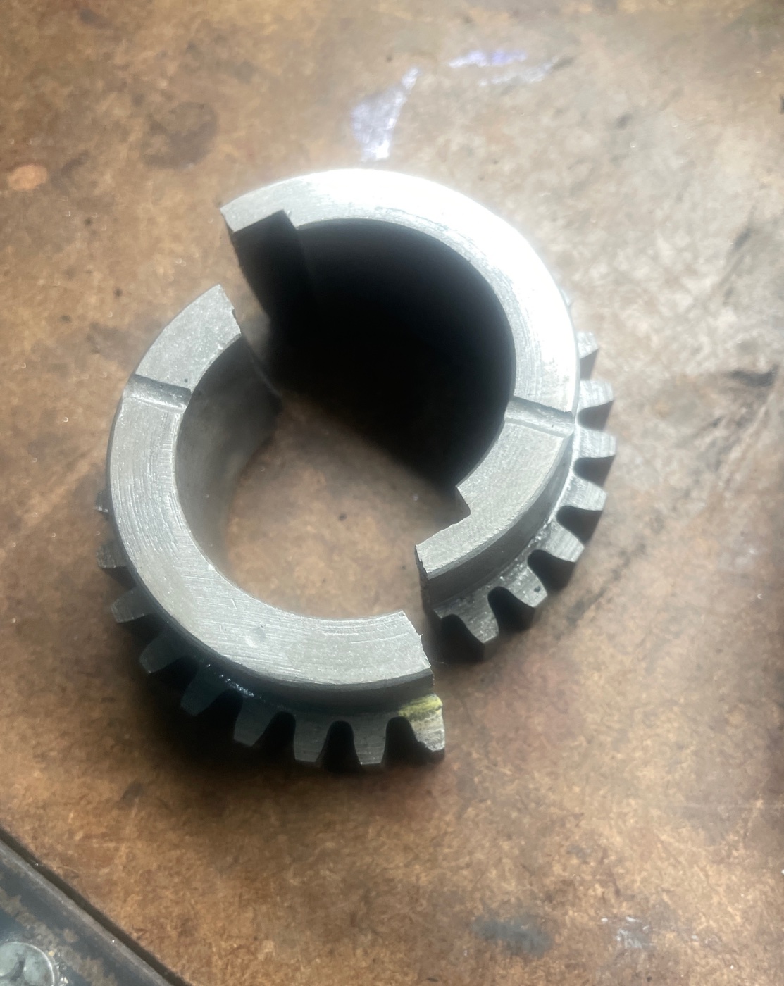

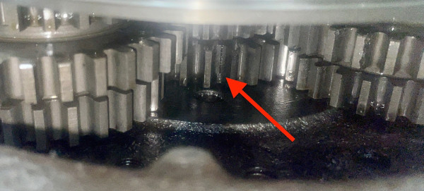

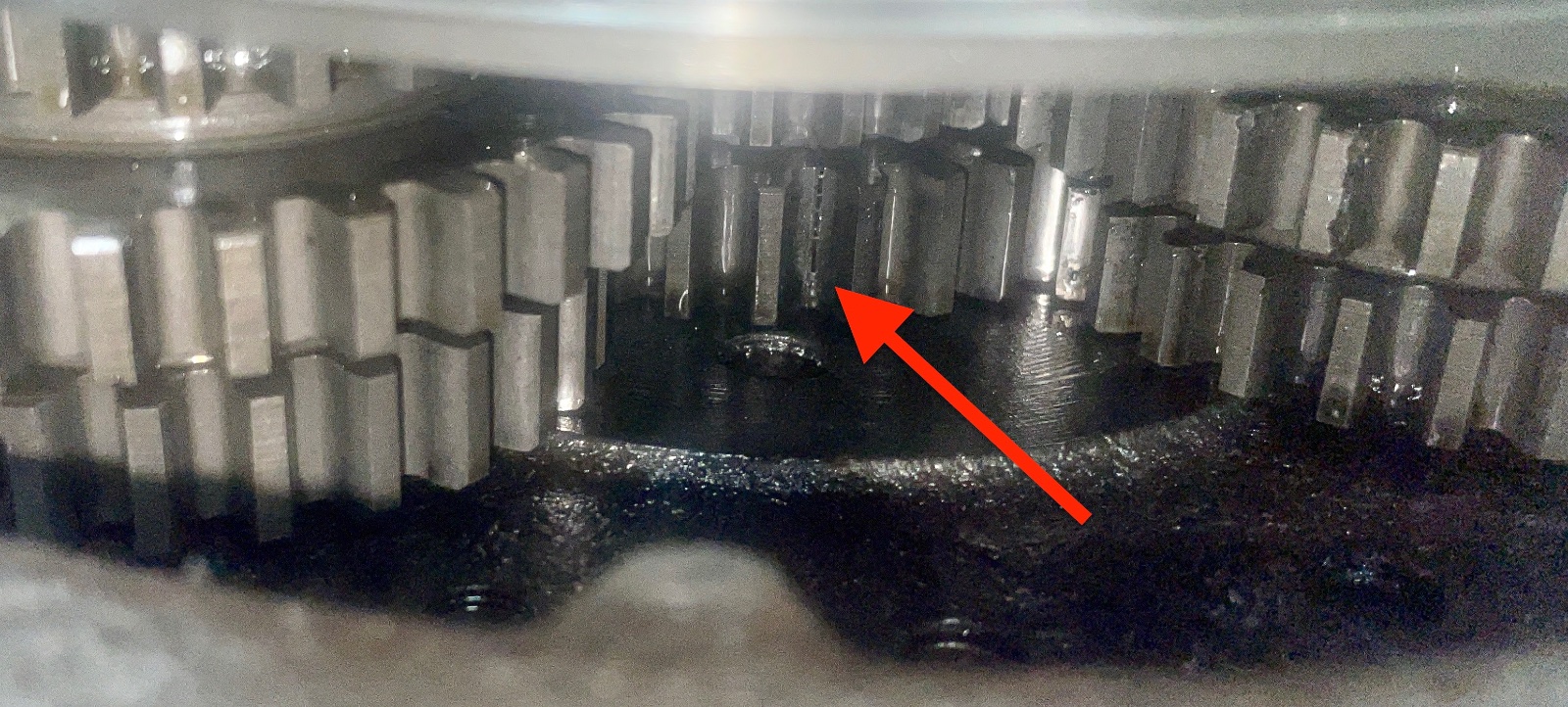

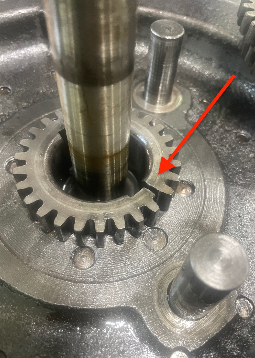

Thought too the triple gears, so when inspecting after disassembly, every thing was pretty ok, clutch spring and drum ok, the turbo discs without wear, but when revolving the drums, there was a bit of catch as the brake drum was rotated.
Peaked at each gear revolving and found this :shock:
Click on photo to enlarge.
So lifted off the drums and took closer look.
Haven't had this occurrence before, the new driving gear cracked in two pieces, right at the key slot corners. That was the jerky rattle alright!
At least the flywheel recess kept the two pieces together, not sure how long it ran before both sides let go, perhaps the gear ran for a while with one side cracked?
So fix will be to replace the gear with a new one, not sure why this driven gear failed in short time, engine built and put in service May 2022, had about 3500 miles or so on it. Couldn't find a Ford marking on its so guess its a repop gear.
Posts: 8679
Re: Trouble in the transmission, what's up?
Post by TXGOAT2 » Thu Mar 19, 2026 10:13 pm
It may be that the gear was defective, or it could be that a problem in the u-joint, driveshaft or rear axle put a shock load on it, causing a fracture. I'd do some checking on the driveline downstream of the new transmission.
