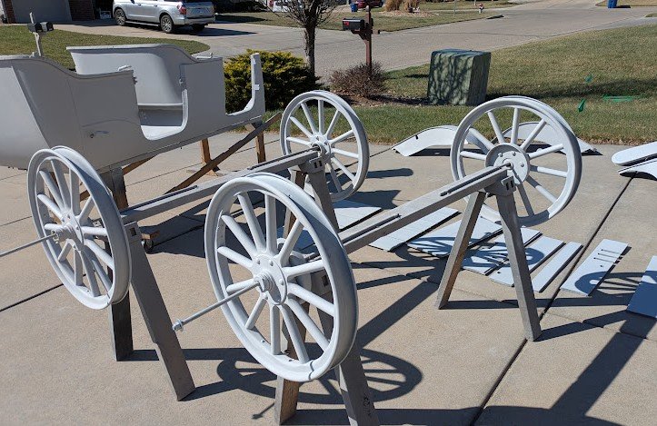

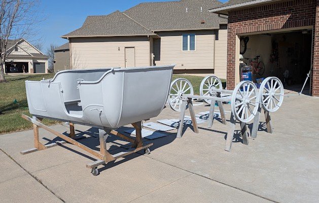

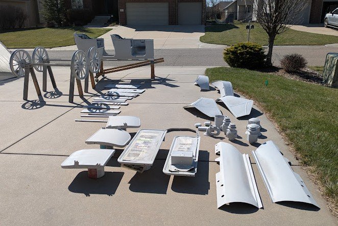

I decided to make a vertical wheel painting stand, using my saw horses, 1/2" all thread and fender washers and nuts at the end. The nuts and washers were a good idea as the wheels tended to migrate down the all thread, and that kept them from falling off and really ruining my day. I used copper pipe clamps to hold the far end of the all thread to the saw horse tops, as there's quite a load pushing down on the all thread, especially if the wheels are a foot or more way from the end of the saw horse.
I primed them yesterday and today, as well as a bunch of other T parts. The stand worked well, but boy, is the saw horse heavy with two wheels on it!
Here's a picture of the stand, as well as the many parts out drying in the sun. A neighbor lady walking by thought that I was working on a sleigh!
