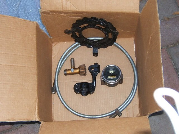

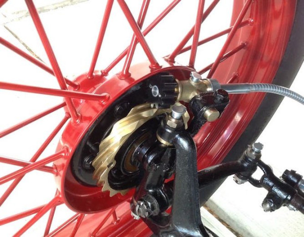

If I see correctly, the drive in the two pictures (which I found on MTFCA) has 16 teeth on the gear on the hub and 11 teeth on the gear on the speedometer cable. Correct me if I'm wrong; the pictures are blurry!
If I start with the rolling circumference of the tire and calculate the gear ratio, I get almost exactly 1000 revolutions per mile on the cable.
If I were to use a 56-tooth gear on the hub and a 24-tooth gear on the speedometer cable, that would result in approximately 1000 revolutions per kilometer.
Wouldn't my Stewart Warner then display km/h?

You will need to buy a set of gears made especially for the 490. As you can see in the photos the gear ring that mounts on the wheel has spiral gears while the gear that mates up to it is a gear with regularly spaced teeth. If I am counting correctly, there are 11 teeth. The photo of the 490 in the cardboard box is a photo I took before mounting it on my1926 Coupe. I purchased it from Russ Furstow about 20 years ago.
I have 21” wheels and my 490 indicates mile per hour and miles driven. Being so small, the 490 is the only speedometer that will fit into the 1926 dashboard (with cowl mounted gas tank) without an adapter.
