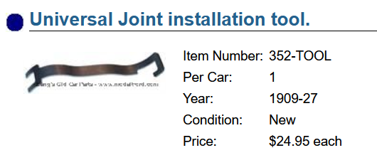

As stated above you'll need help because the end of the u-joint has a mind of its own when aligning with the transmission ball cap. While not necessary they do make a tool to support.. DIY? .
