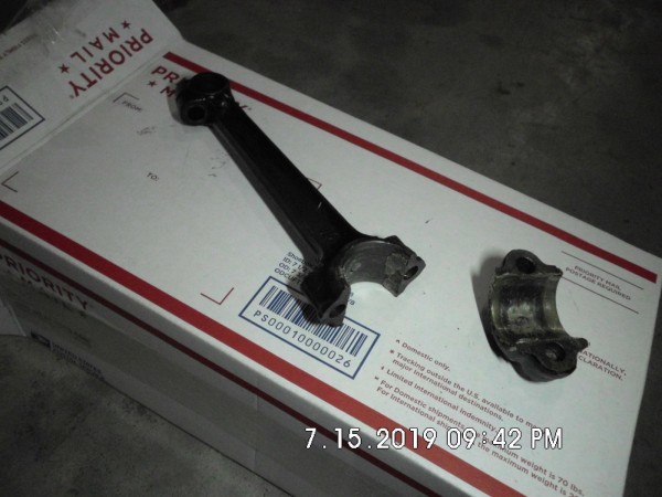

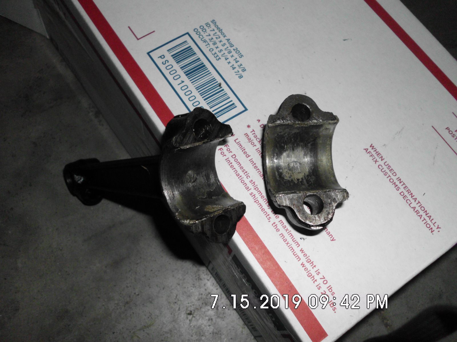

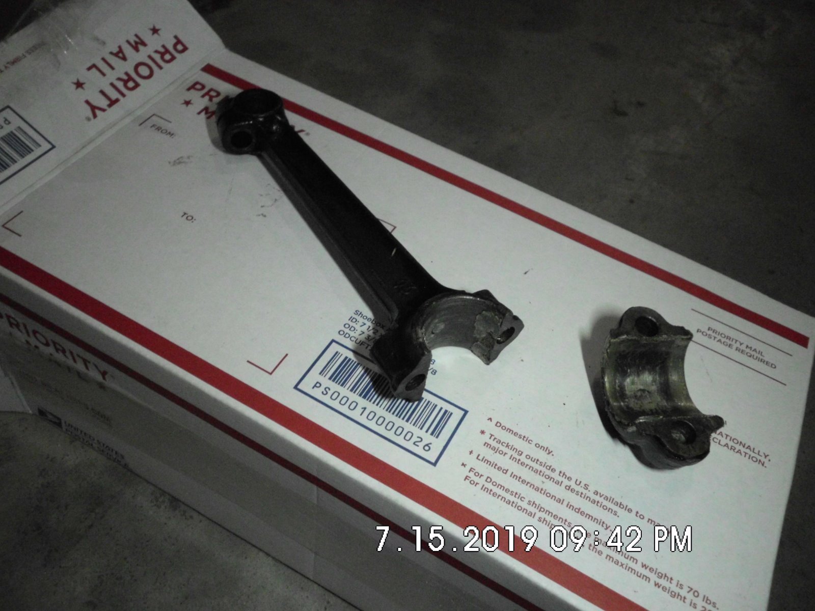

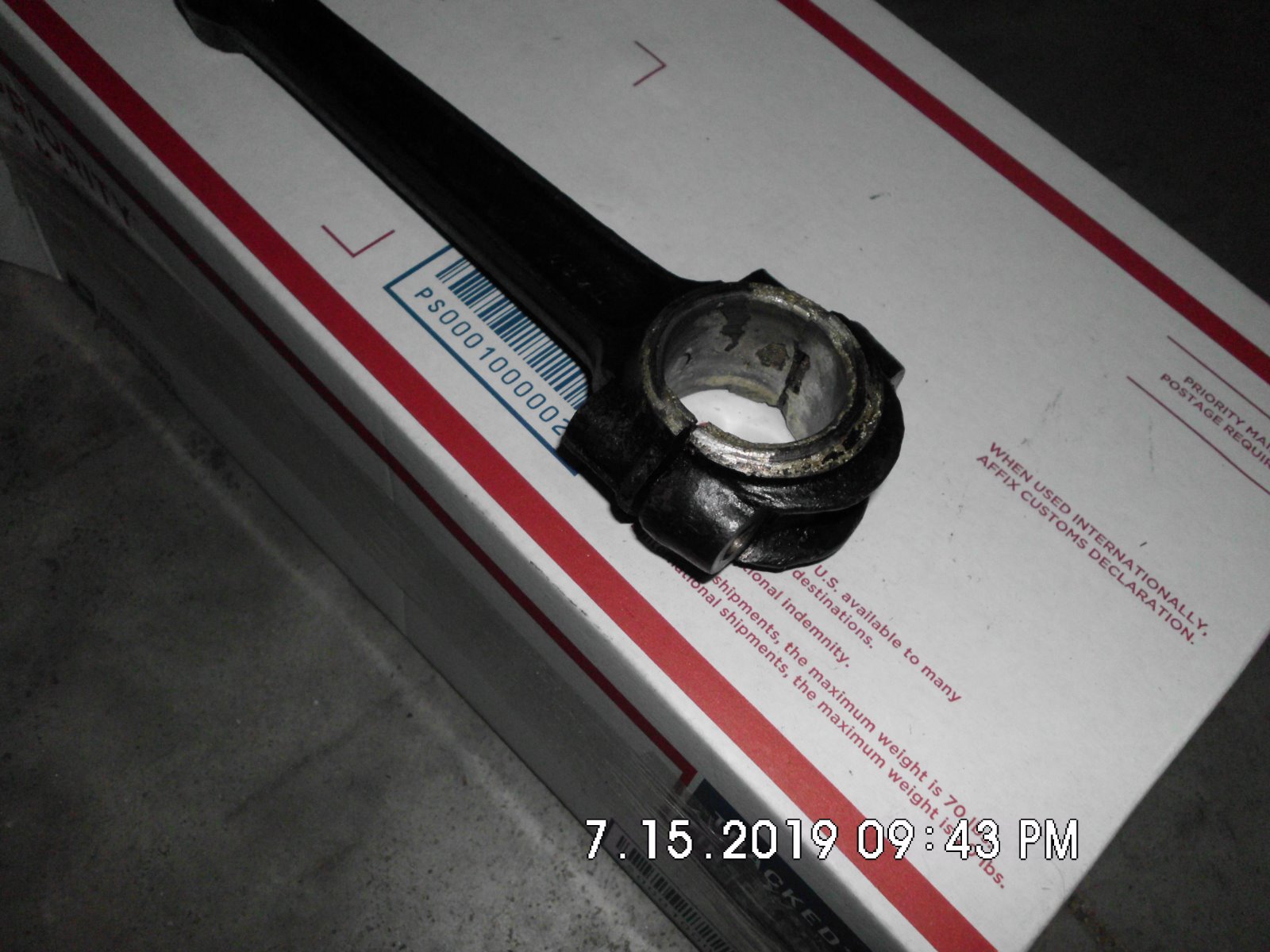

You don't want those things to open up while driving down the road or worse yet fall out. My top petcock worked open on tour some time after we left Dayton Ohio and just outside of Richmond Indiana and dumped 3 1/2 quarts of oil out of that little top hole in less than 50 miles. We found it after the #1 rod started hammering and most of the babbit turned to small chunks in the bottom of the pan. I just got it back together last week and drove it today for the first out of town run. Now I jump at every rattle or odd sound. You wouldn't think that much oil could ever be thrown out of the top like that but it happened to me. Someone even got a picture of me checking and adding oil in Dayton before it rattled open. I use a checkrod from the side to open and close them so hard to know if thy are loose.

Here is what happens when one of those little springs wont hold it closed on a 50 mile drive down bumpy roads.
