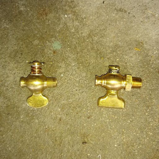

Post by DHort » Wed Jul 17, 2019 7:28 pm
On the left is the OR (original) petcock and on the right is the RE (reproduction) petcock.
The original petcock would turn about 2 1/2 times and the reproduction would only turn about 1 1/2 times. I applied Megaloc thread sealant and installed the petcock. I then used a crescent wrench to tighten it some more. It definitely will not come out and i doubt that it will leak.
Thanks to all for their input.

Post by Allan » Mon Jul 22, 2019 7:00 am
