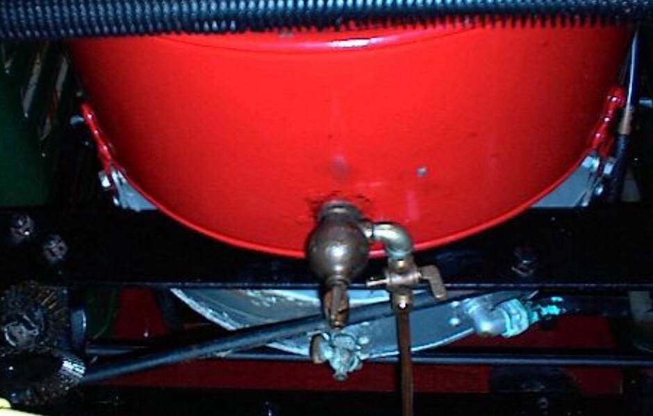

Re: Sediment Bowl Year(s) ID
Post by Dropacent » Sun Jul 14, 2019 4:46 pm
This is a model F ford sediment bulb. I made one of these tanks years ago, but forget which . I think this is rob heyens baby now. If you want to sell, I think I have a friend that would buy it.

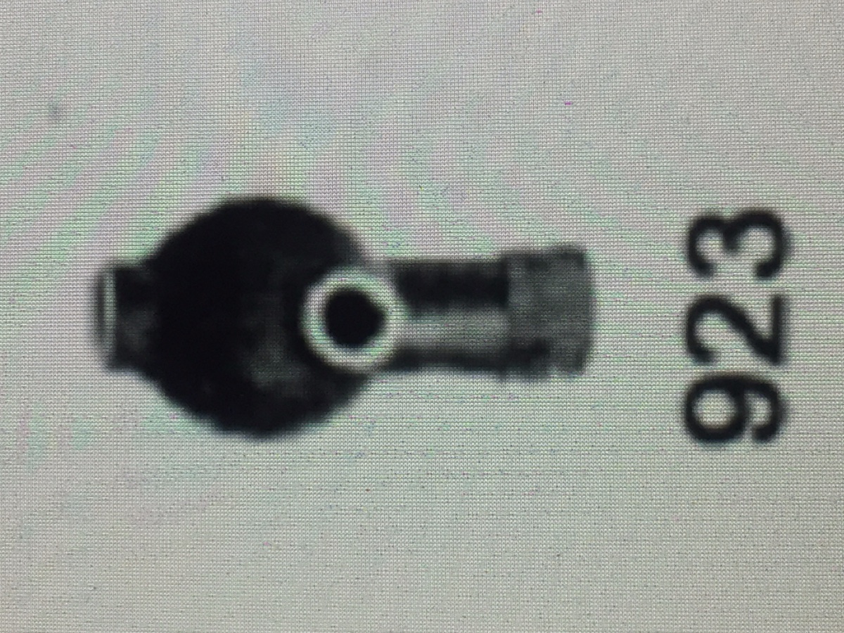

Posts: 4114
Post by DanTreace » Sun Jul 14, 2019 4:49 pm
This photo from Parts and Price list of the N,R,S Fords. Similar shape of round bulb, but no shut off lever built-in.
N,R,S sediment bulb

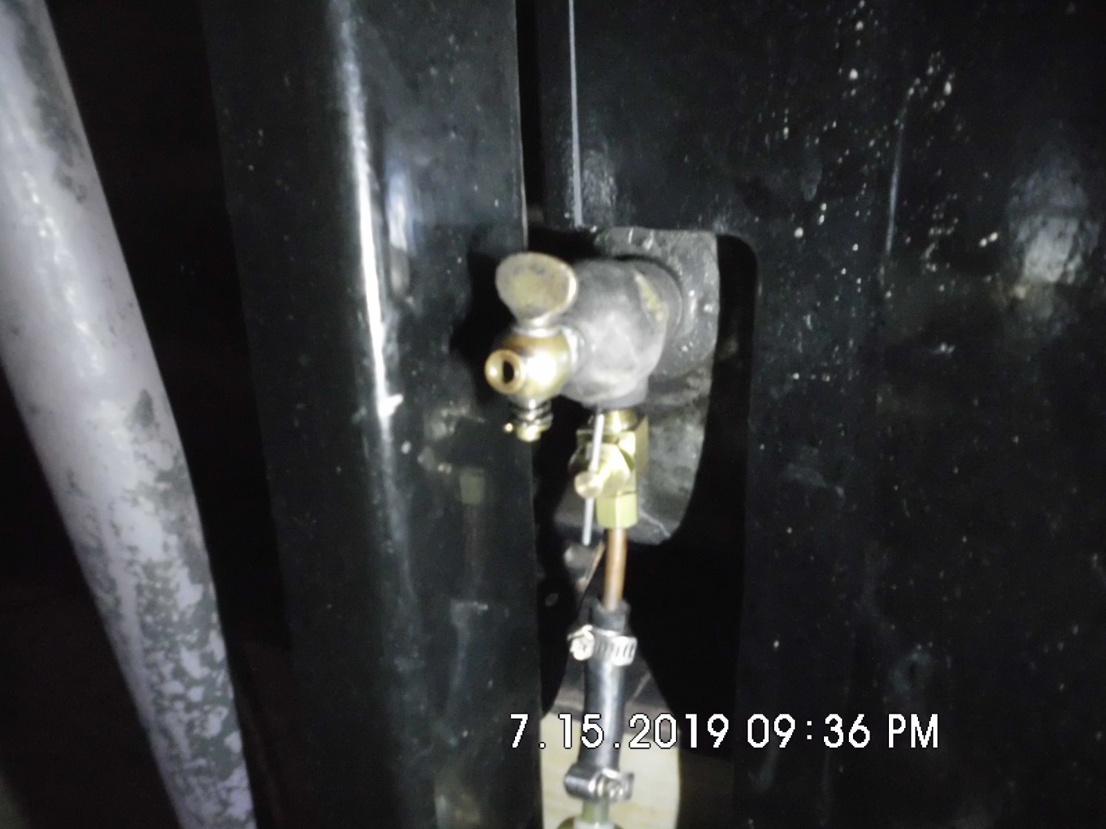

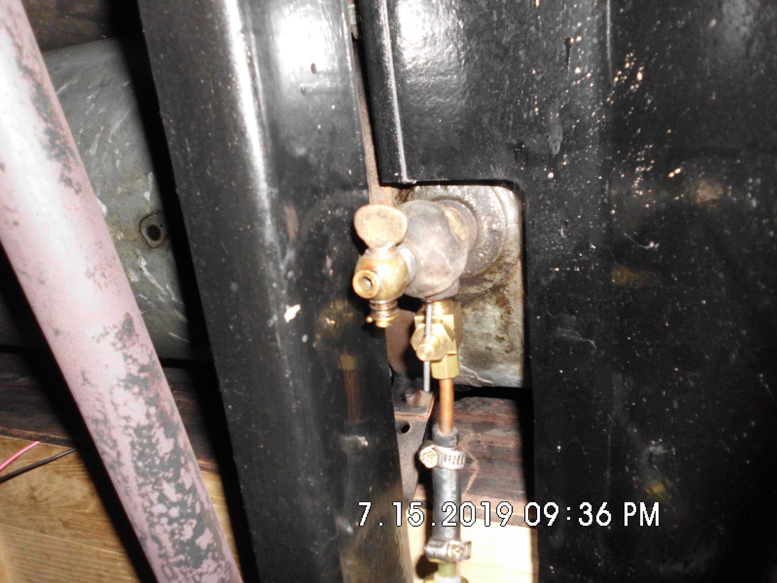

Post by Bob McDaniel » Mon Jul 15, 2019 9:04 pm
Today I needed to move the 09 and noticed that the sediment bowl is round and about the size of a large walnut but I didn't see a shut off on it. It is mounted outside the frame and no room to reach between it and the frame so it will need another look on a cooler day and no way for me to know if it is correct for an 09. Another item I had not given any thought to before this post came up.

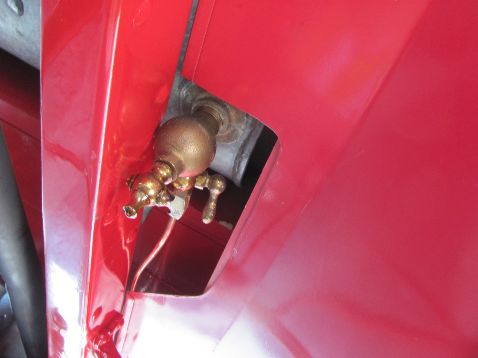

Posts: 4114
Post by DanTreace » Mon Jul 15, 2019 9:12 pm
Bob
A 1909 sediment bulb, taken at show, award winner. The shut off valve is a threaded on separate item, same as the petcock. All brass.
Post by Bob McDaniel » Mon Jul 15, 2019 9:59 pm
After seeing Dans picture it made me go out and get a picture of what I have. Other than the newer style shut off and fuel filter it looks the same as Dans picture. Yes mine is brass too.
