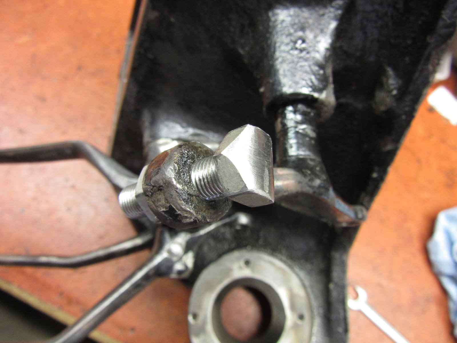

Rob ; I do it this way .
- Posts: 4085
Re: High speed adjusting bolt question.

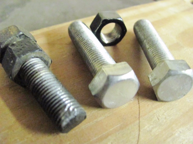

That is what I have found best, to turn the bolt over from the Ford way. Puts a nicer wide bolt surface for better leverage, and add some grease for a smooth gliding contact. Put nut on top to lock the position of the bolt.
A Grade 5 bolt is just fine, hex head 3/8" x 24tpi, 1 15/16" length, hex nut for locking.

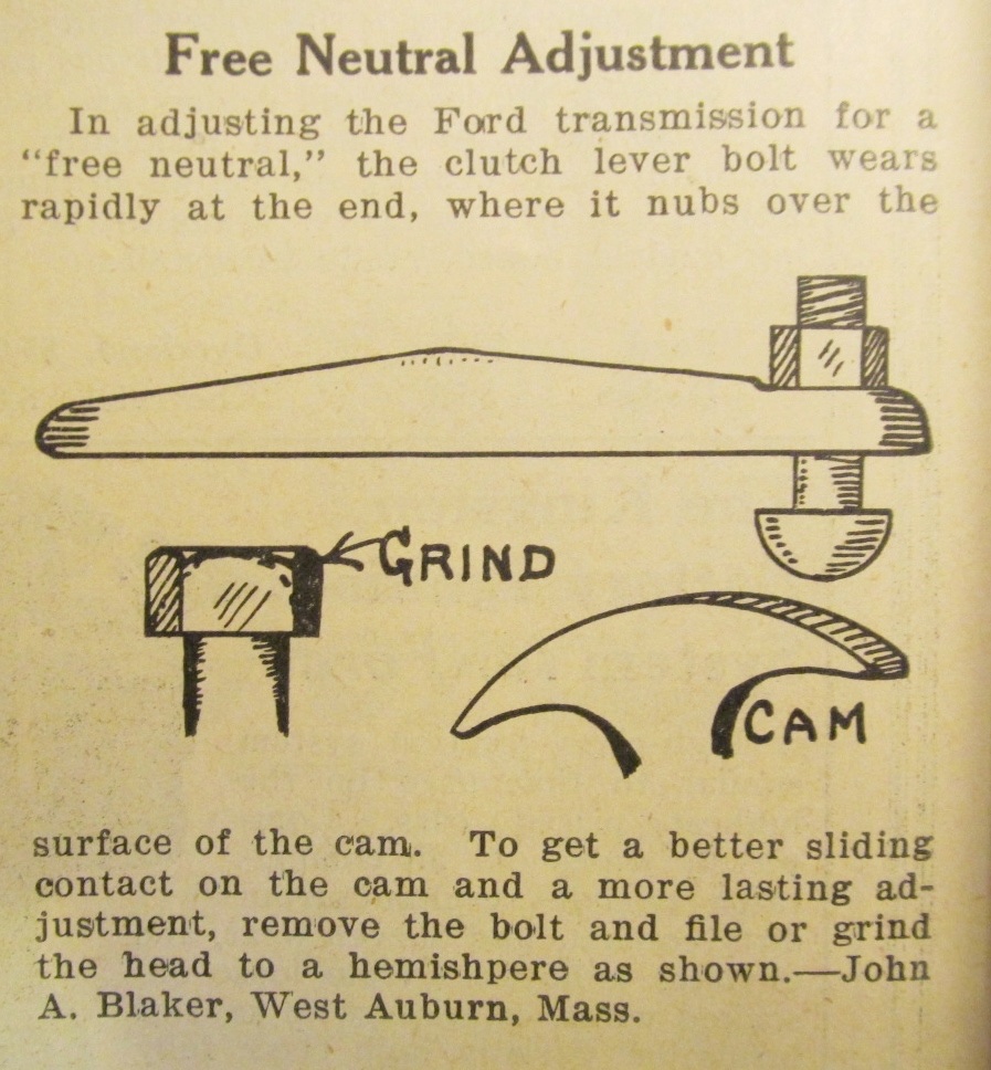

What the Ford way looks like over time, mashed threaded end of bolt on left. New bolt in center with rounded hex. Just grind what shape you wish, the globe end in the old time sketch seems excessive to me, and make future adjustment tough to put a wrench on the round end, but would give a ball bearing slide

Rob ; I use the same bolt as Dan , with full tread .

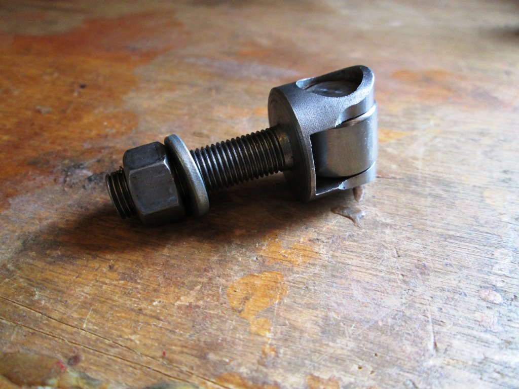

- Posts: 5594
There was an "old-timey" master machinist in the Tacoma M.T.C . that made a run of these for his "buddies" - they work just fine !
- Posts: 6800
Steve
he did indeed do very nice work, even for such an esoteric part!
Now Rob has a very nice baseline to shoot for. Good of you to post.
- Posts: 5545

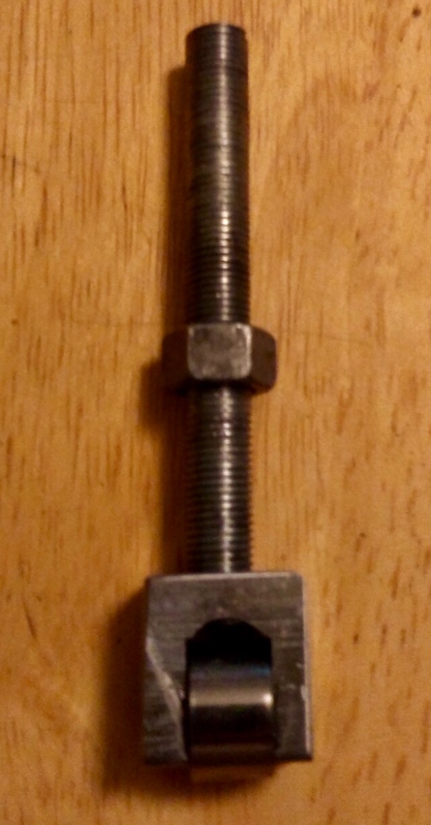

Very nice looking roller setup.
Rob
Topic author - Posts: 1595
- First Name: Rob
- Last Name: Heyen
- Location: Eastern Nebraska
My friend Bruce just put this together and sent a pic. He said it takes about an inch:
Quickm007
- Posts: 1202
- First Name: Mario
- Last Name: Brossard
That's really cool. I would like to have one if it is possible.
