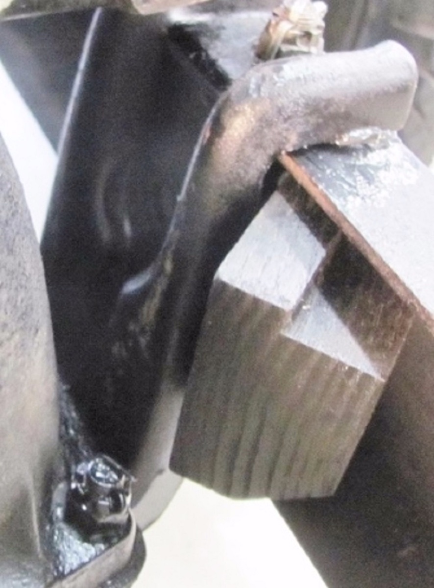

If the top bolts are taken up tight before installing the wood blocks why is the top of the block cut to hold the bolt head while tightening?

Not sure but I thought that was for a space to run wiring.

The top of the wood block is notched so it will clear the bolt head when you insert the block. The bevel at the bottom of the block creates a space where the gas line runs.
