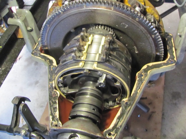

Like others would check under the chassis, around the outside of the hogshead, against the frame rails, etc. Search the T anywhere but the opening of the hogshead to rule out other locations of that bouncing ball knob.
Then really check the floor, I like to lay down and sight along the flat surfaces, find things that way..
Then, maybe the knob did fall into the trans, would be unlikely for it to fall into the magnets on the flywheel, but if it did would be hard to reach, like a ball on a roulette wheel, between a pair of magnets perhaps.
Other places would be under the bands, as it could roll off the bands and fall below. Or on the rear of the hogshead, under the clutch spring, but that part of the pan is tapered towards the sump, so it would be in the sump then.
About the only suggestion I have is to drain the oil, fold a length wise shop towel in and hand crank it over, hoping the wad of towel will scoop the knob up along side the flywheel. :roll:

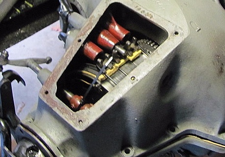

I wish our transmission looked as nice as the one in the pictures.

First, I'd respectfully suggest that a shop towel is not the way to go if the hog's head is installed. I do not believe that the knob will pass the pan at any dimension, and you may simply jamb things up if the engine is rotated the "wrong" way and the knob is indeed there.
If the nut routine shows that the knob may indeed be in there, yet is not visible, you may have to remove the hog's head. The knob should become visible and at that point, if you need a rag to "sweep" it up, then (with oil drained), a rag or rags can then be dragged safely into the cavity by the ring gear teeth. I'd never put a rag into a transmission and turn the engine over unless the hog's head is off
I'd remove the spark plugs and put the car in high gear, jack up a rear wheel and have someone turn the wheel over slowly one direction of the other as necessary to bring that sucker up. Annoying, but not a tragic deal.
