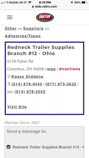

Redneck Trailer Supply is a good source for parts.
There is a location in Columbus off I-70.

FJ - I'm not too sure that a "Redneck Trailer Supply" store would be very easy to find in the Columbus, Ohio area!

Harold
I've had business in Newark, and stayed in Columbus. Honestly, without Jim's ad, I'd have said that ANY trailer supply would have been Redneck Trailer Supply.

"FJ" & Scott - I'll be darned! In checking Google, there's a Redneck Trailer Supply in Fresno, CA. that serves all the west coast too! Guess that'll teach me, huh?
