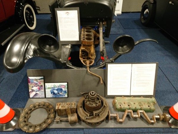

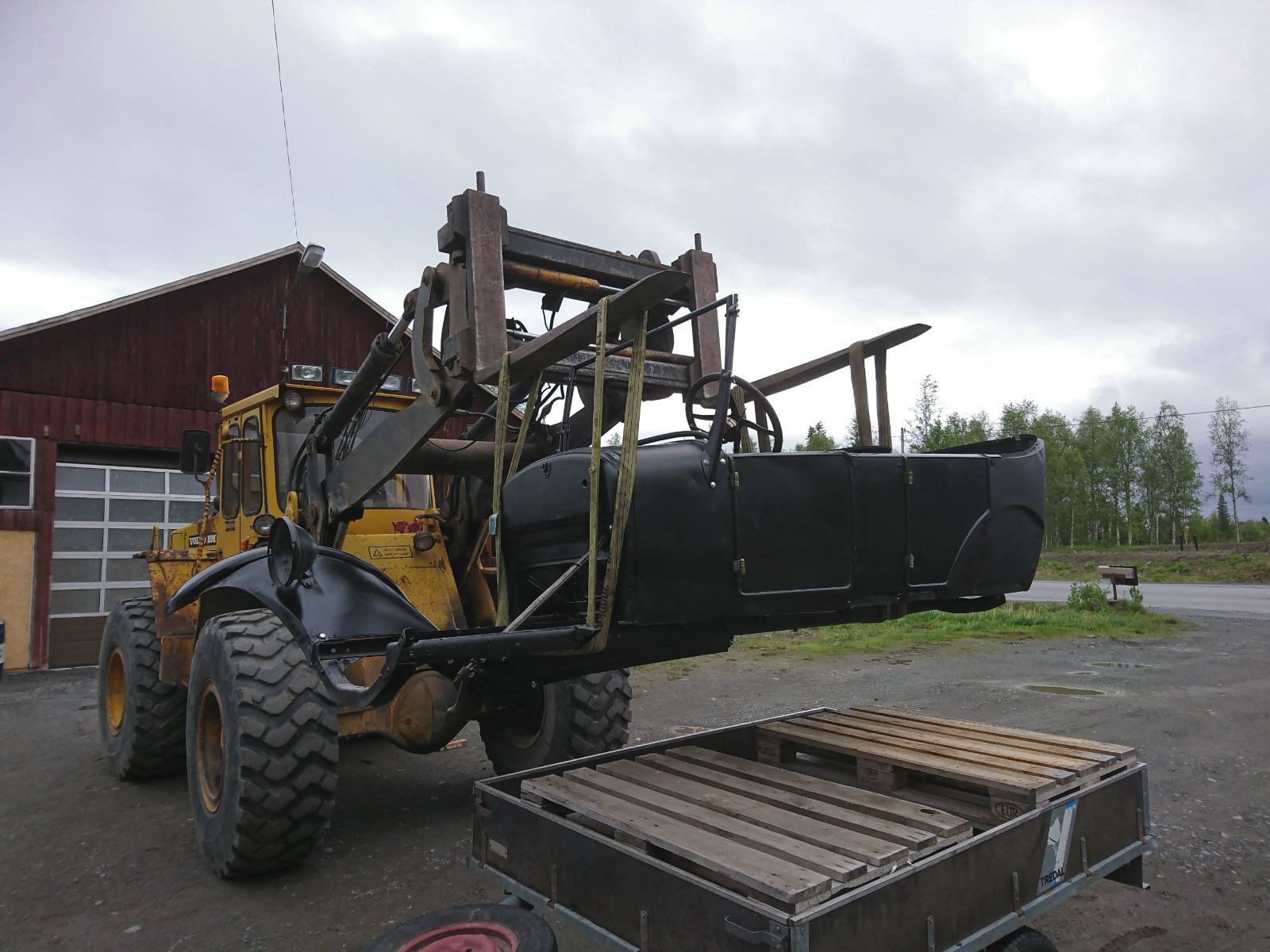

Got the opportunity to buy back my great grandfathers old 1926 touring in May last year. It's a complete restoration object, dad still says "had you not told me I still could not tell if it had been a car or a plane wreck". I'm a complete novice at this kind of project so I have a workshop to do the welding and getting the body assembled and once a time in the future the paint job. Would have been cheaper to buy a working car but then I would not have the history as I have found up to now, this is still work in progress. The mechanical things and assembly of engine I want to take on myself.
I think I have traced all previous owners and according to my time line my great grandfather was the fourth owner (1935-1972) and I'm now the seventh owner (2018-). The car went out of traffic december 31, 1957 and sold to a man in 1972 that was supposed to restore it. In 2010 that man died and an Model T enthusiast bought the parts to save it from ending up as scrap.
The enging block and the frame has the same number, 13.509.103, is it possible to trace the day of production of engine and assembly of the car?
Sadly there have been some water inside the water channel at the top of the block that has corroded the metal. That crack I found on the outside of the block turned out to be just thin metal when a specialist tried to weld the crack. It is possible that I post a new topic on that matter later, would like the original block but not at any cost.
As of who sold the car my best lead as of yet is a Norwegian mechanical/steel workshop in Namsos that I am told at least before the first World War bought cars in wooden crates and assembled the cars in that workshop. Anyone know if its possible to trace buyers from any records in the USA?
Grateful for any answers.

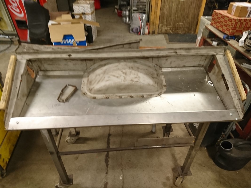

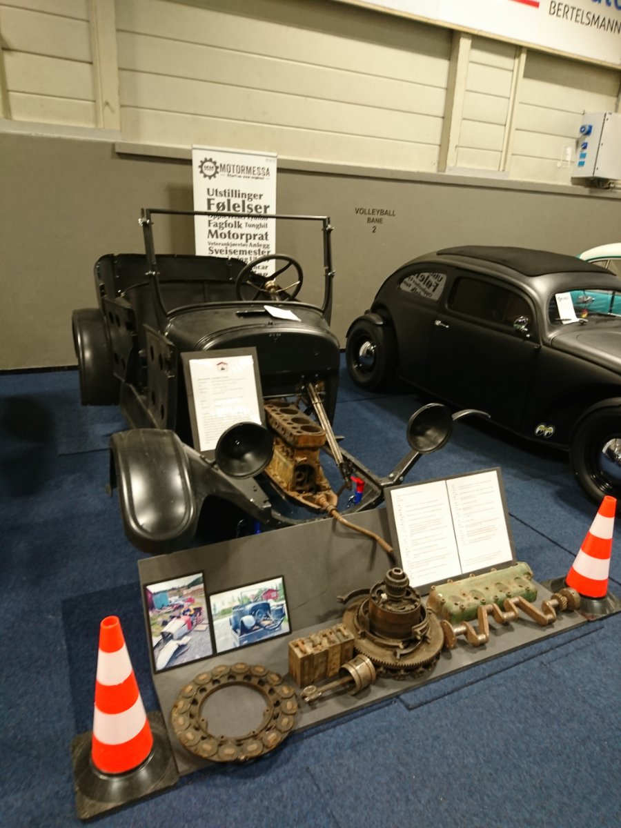

Thanks guys :)
I have a lot of stories about the car so I am thinking of starting a blog or it's own Facebook page if that's allowed.
I found out that it will be a car show in the region where my great grandfather lived and contacted them to hear if they was interested in displaying the project. They were thrilled about the history of the car so in june 22 and 23 2019 it will be displayed at the show as a project.
I am currently writing down a timeline for the car and my relatives in direct line.

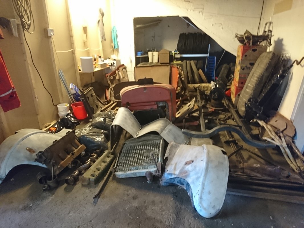

As for body parts there is a story of it's own for that.

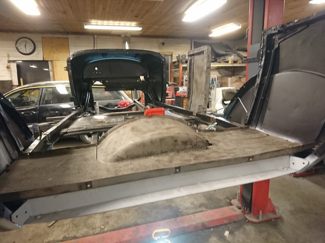

The picture shows the parts placed out on the floor of the workshop boot floor that I and my dad is letting. I placed the parts as I thought they were connected.

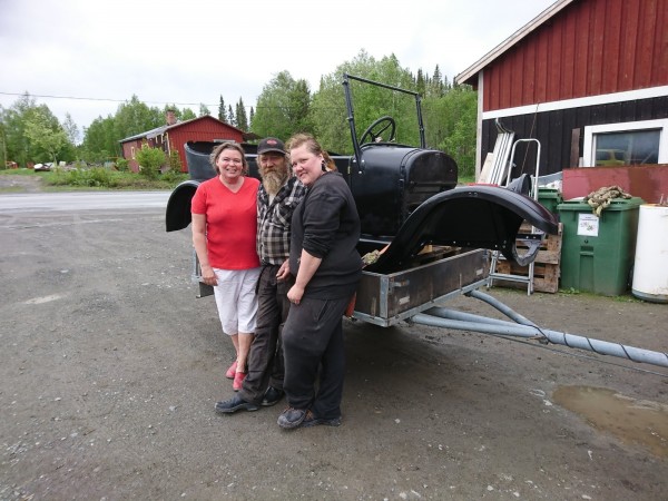

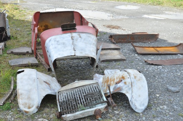

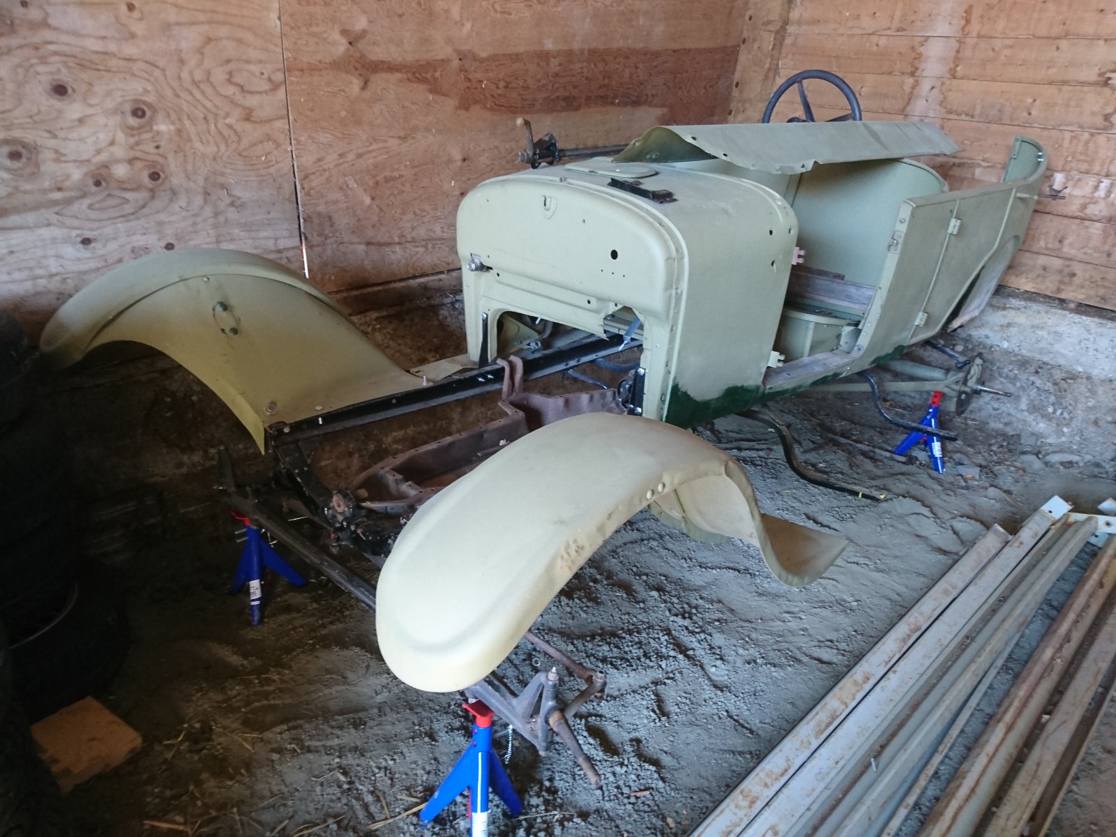

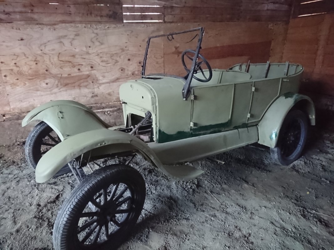

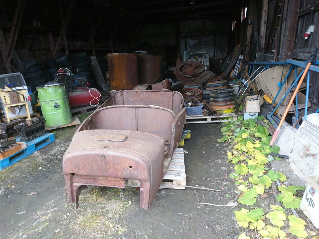

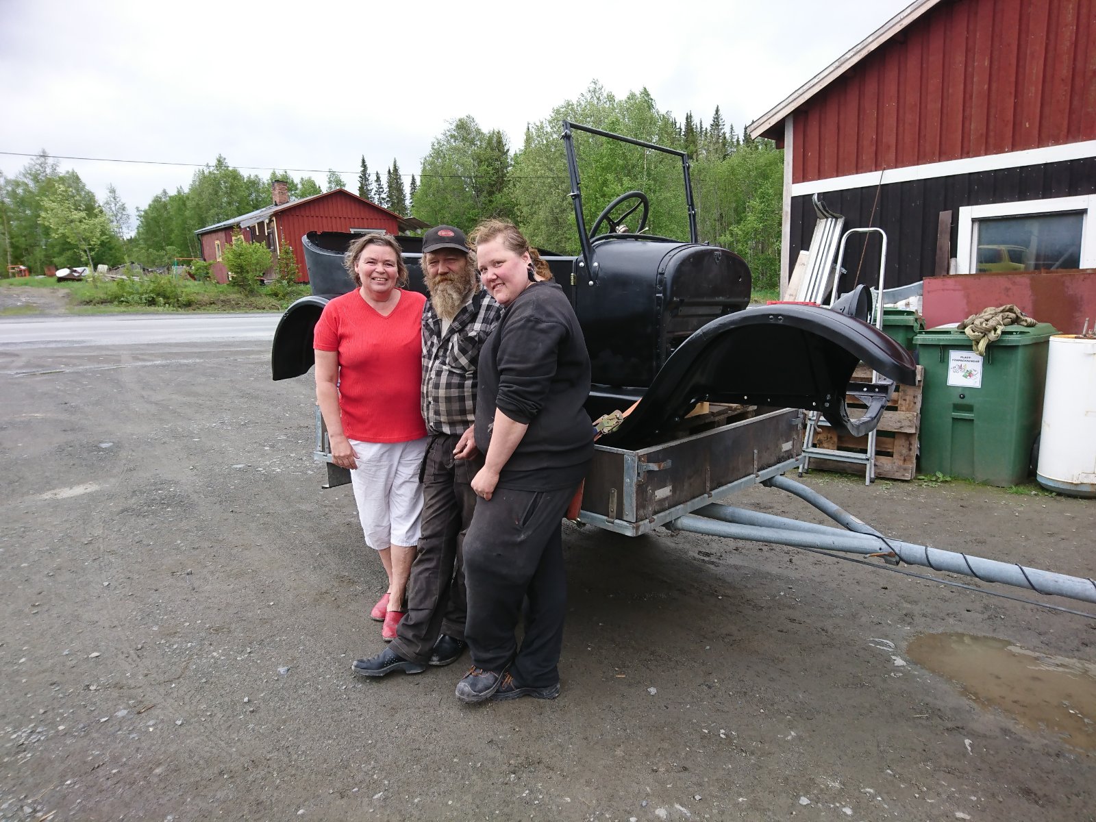

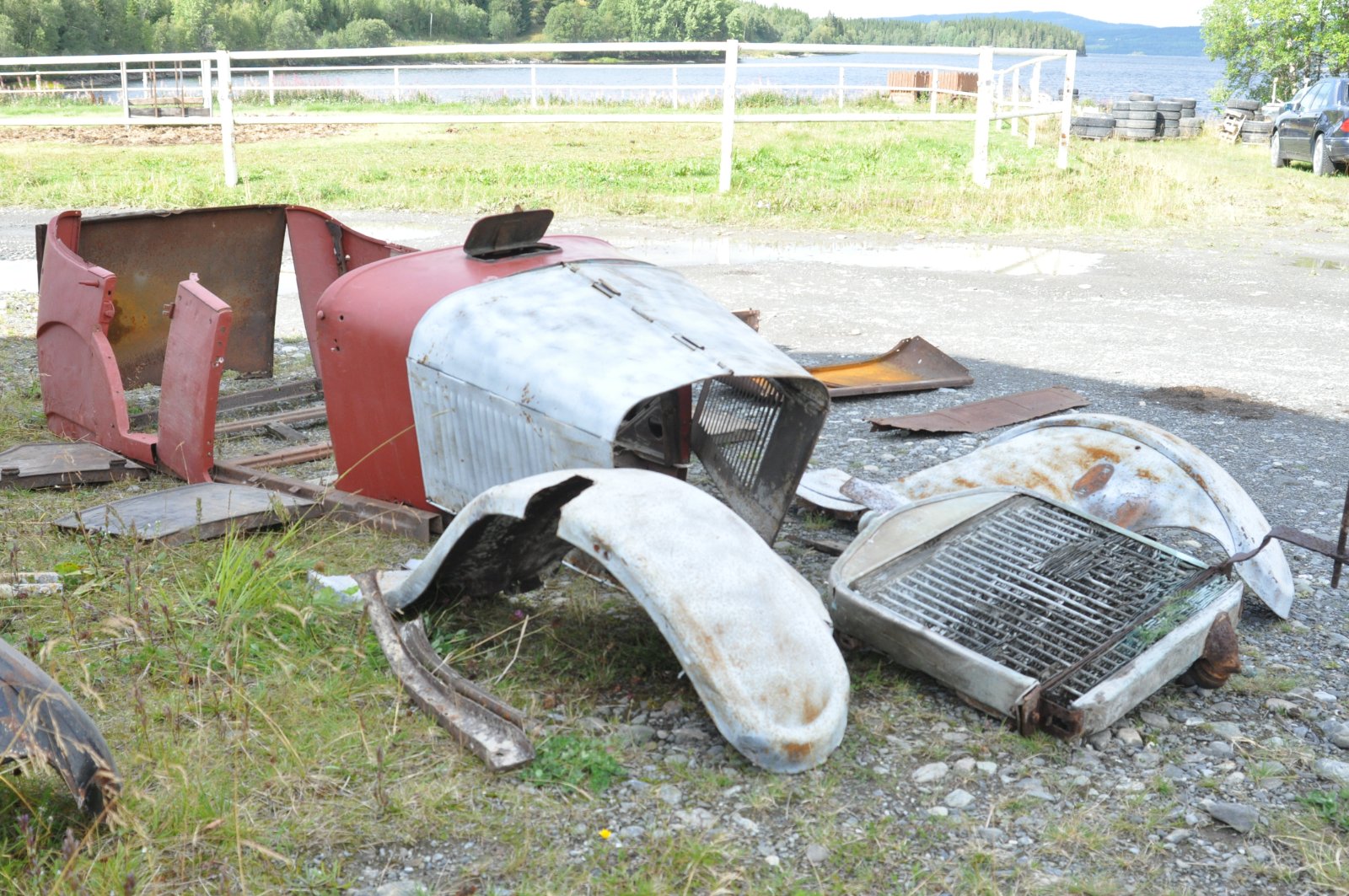

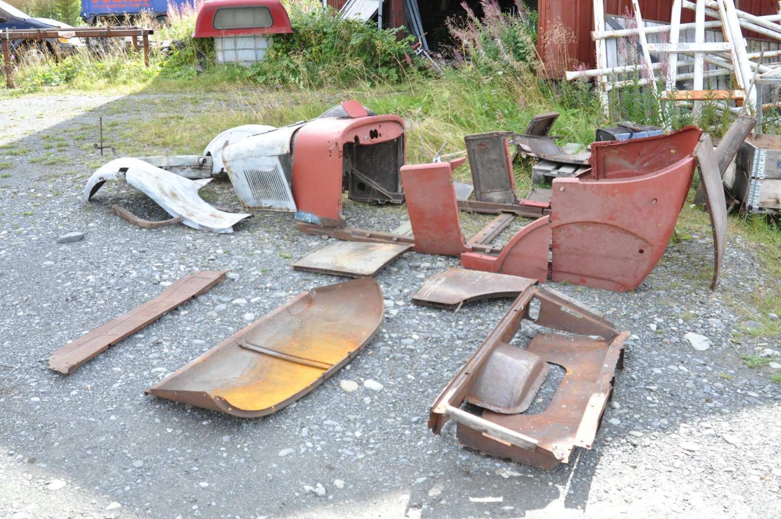

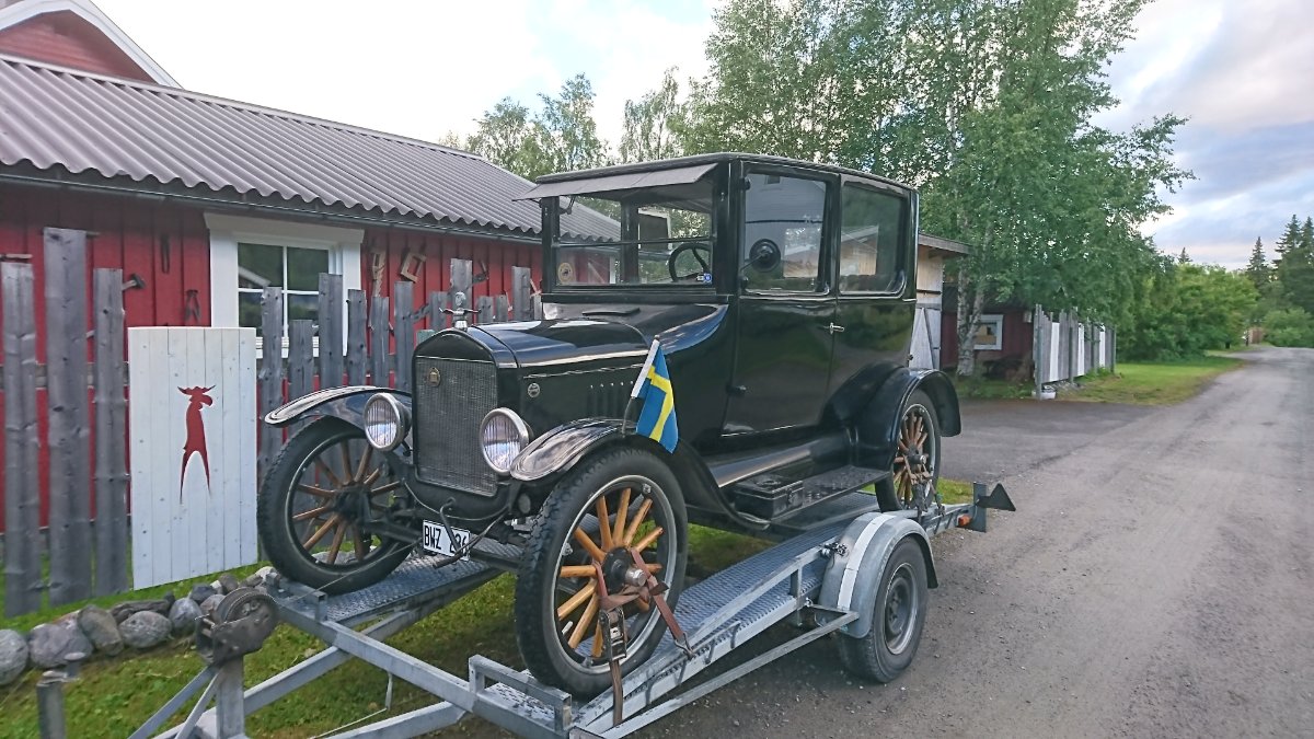

As for the parts.
My dad has a cabin in Åre, Sweden. It's 180 km and a two and a half hour drive from Trondheim and in Summer 2017 I was walking around among the permanent housing area on the other side of the main road E14 when I saw an old car on a car-trailer. As a complete novice I hadn't a clue what car this was so I took a photo, attached, and showed it to my dad that bursts out that this is a T-Ford. In Norway and Sweden we call them T-Ford and A-Ford.
A few weeks later I walked in the same area and when passing the same house i saw a couple covering an another car than I saw earlier in the parking space in front of the house. I started talking and found out that they own 7 Model T's in total! I told them I was thinking about buying back my great grandfathers car back, the man starts smiling an tells me "buy it!"
After that I have been at several visits to them that rarely lasts shorter than 3-4 hours.
Last summer I was contacted by this man saying that he got a call from someone who wanted to sell off all of his Model T parts. Turned out this was all 1926 touring parts and a project car that has been under restoration since 1974.
After summer I bought the lot and ended up with a project car, see photo, 1 body that was complete but rusty, 1 body that was cut i three parts and rusty. I have so many front axles that I don't care, several steering columns, 2 engine blocks, lot of wheels both wood and steel.
I haven't touched that project car but the workshop are using the best parts of the lot for my body.

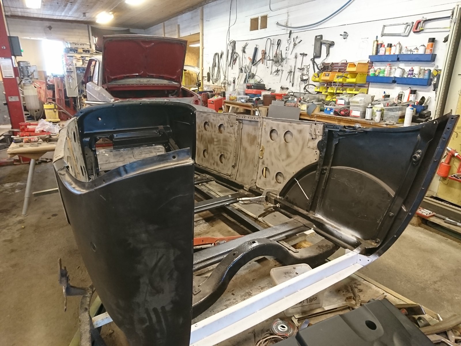

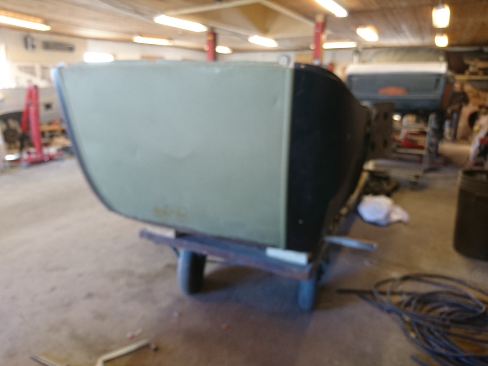

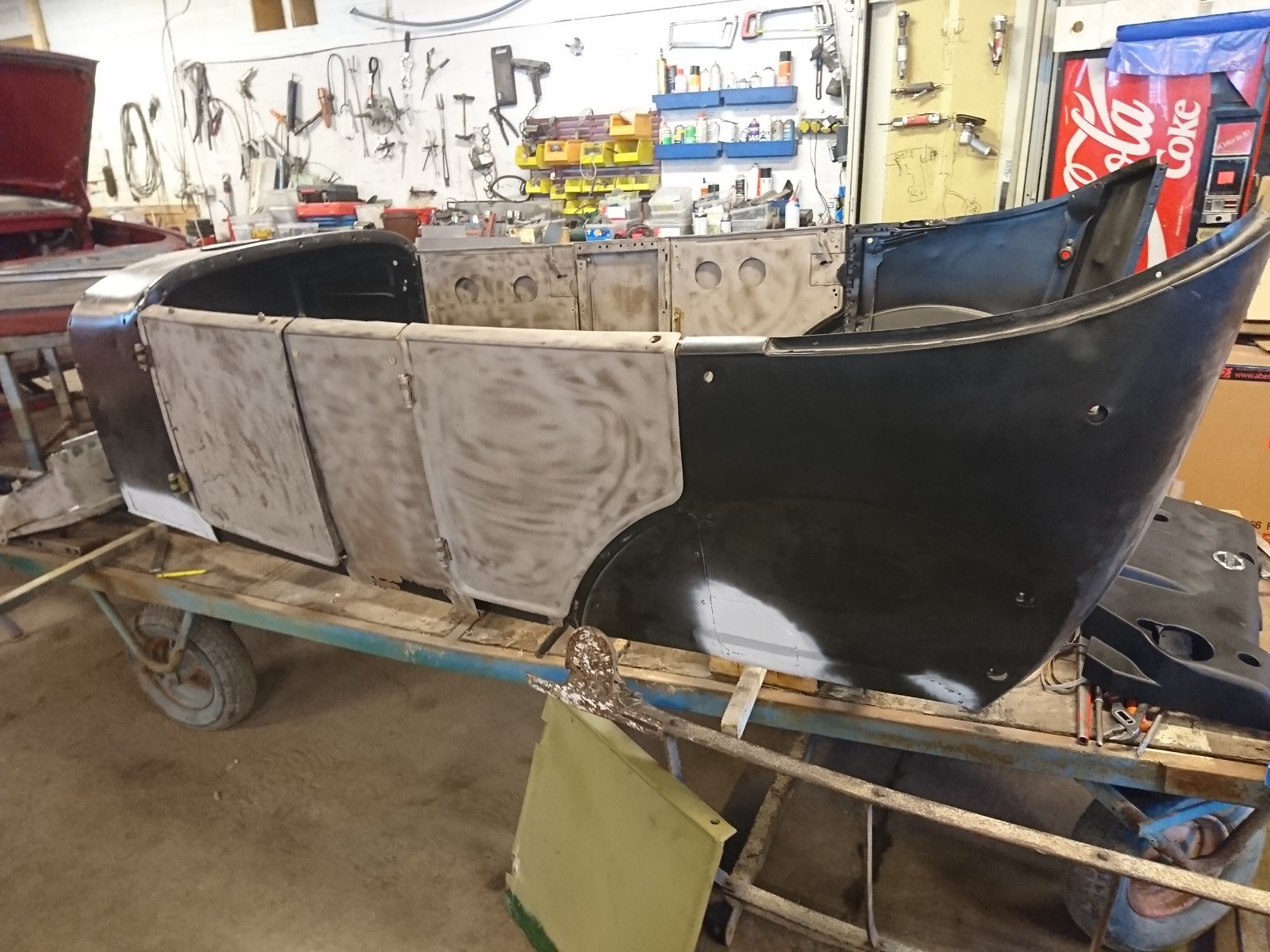

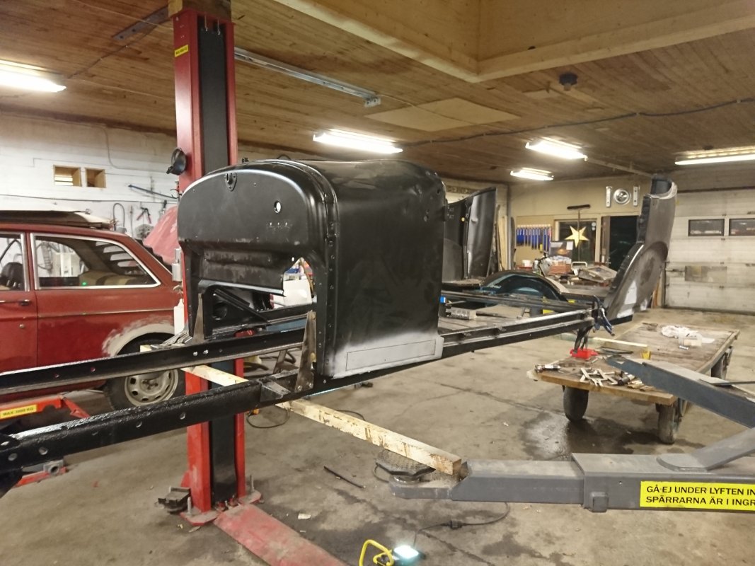

Here is a few photos of my car from last weekend when I visited the workshop.
Note that the red Volvo 142 is my dad's car bought from my great grandfathers youngest son and he has driven my Model T.

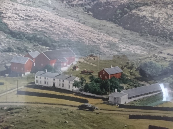

Here is a photo of the farm where my grand mother was born, must be in the 50's (most likely) or 60's I reckon. The Model T used to be parked in the farmyard in front of the red "Eldhuset" (washhouse) to the right with the headlight towards you looking at the photo. When the car went out of use 30th of December 1957 it was parked in the outbuilding in the back to the left. This outbuilding and the outbuilding in front of it was demolished some time in the late 60's I reckon and then the car was parked outside. The kids used the car as a playground before the car was sold 21st of April 1972.
The farm at Ramstad in Nærøy

Fint bilde av gården! Typisk langstrakt trøndervåningshus.

Post by Vbl » Sun Apr 21, 2019 6:18 pm
After my '26 body was postponed slightly by the workshop due to other projects, it is now full ahead again. The goal is to have the whole body temprarily assembled but all bodyparts, fenders, windshield frame, running boards etc. to have been sandblasted and black epoxy coated to the fair "Trøndermarkedet" 16th of June and to the car show "Motormessa" 22nd of June.
Because of missing title of the green Swedish car I ended up to take the rear center body panel and the rear wheel arches and sills from that car to use them on my car. I also took the windshield frame from this car and the rear fenders too. The steering column probably also ends up in my car.
The Swedish car without papers

Post by Vbl » Sun Apr 21, 2019 6:48 pm
It has come a long way from when I brought the parts to the workshop. Here we have placed the parts as we assumed they would be.
After I got the chance to buy the green car and all the other bodies we decided to take the best parts for my car. The plan was to leave the green car untouched but as the other bodies was bad I ended up taking the few missing parts to get the project going.
The project started in September/October 2018 I reckon.

Time for an update at last.
Was at the car show Motormessa in Rørvik the weekend 21nd to 23rd of June. It was an success. Got a lot of good feedback and people thought it was a cool project. Talked to several people that thought that the crack in the original engine block was possible to fix somehow, just got to find the right person to help me.
Assembled the body and fenders temporarily for the show and made a timeline and a short story to display.
Upploading at the workshop in Sweden
Workshop family business; Lisa, Stefan (owner) and Jenny
Stand at Motormessa
Stand at Motormessa
Just over 6 months difference between photos displayed

When I saw the large hump panel in the rear underseat panel, I wondered what the story was. Then the exaggerated arch in the rear frame cross member showed up in later photos and I can see why. That arch appears way taller than anything I have seen on our Canadian sourced cars. What do you fellows see?
Posts: 4086
Re: My great grandfathers 1926 Model T touring, Norway

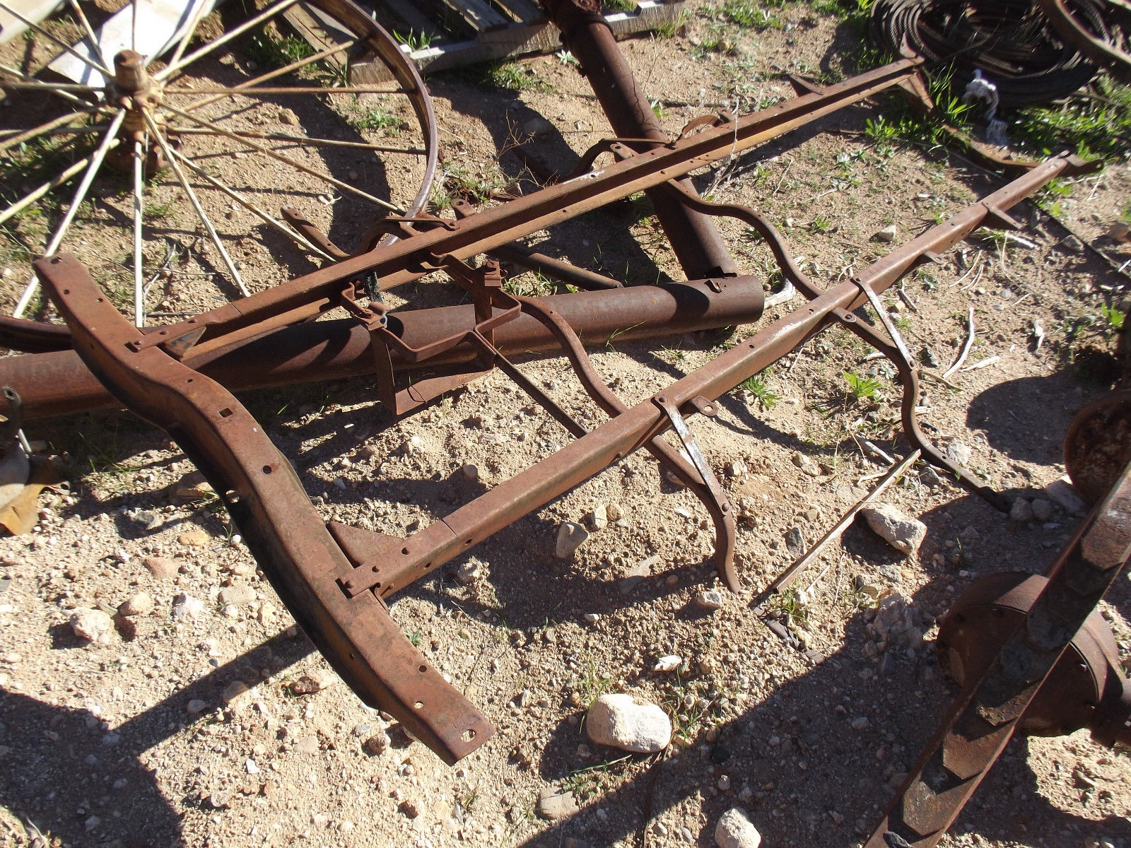

Post by DanTreace » Sun Jul 14, 2019 11:36 am
Noted that high arch in the rear crossmember, remember reading that many T's mfg. overseas, like England for the Improved Car, got lower chassis stance.
Must be same in the Sweden Ford plant, lower chassis. You can see that arch in his photo, compared to the USA made '26 frame. That would require that large pan under the rear seat.

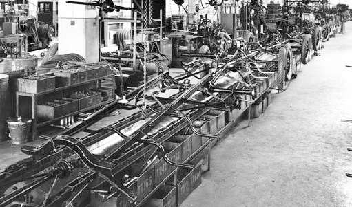

And found this saved file of photo from Sweden assembly plant, you can see the taller rear crossmember, this is one of a series of original photos on eBay a while back.
Chassis frame on Sweden assbl line.jpg (125.42 KiB) Viewed 23981 times

As we've found out by now is that northern European cars sits lower on 1926-27 models than American models. We have been talking to a Swedish oracle that told us that because the body sits lower the rear fenders are different and hence the rear quarter panel must be different and the rear doors.
He also could tell us that for a northern European Model T the 1926-27 year models is the hardest to find body parts with the 4 door touring being the absolute worst. We were told that we can't buy body part from Mac's or Lang's, they won't fit.
We were told that it is possible to buy upholstery and interior door panels from America but it requires some fitting, but we should have a template at hand.
As an example: I took the right front door from the green car and put it in my car. The body frame is not welded together yet and we can't figure out why it wont fit. After some thinking and measurements we found that the green front door are 5 millimeters longer than the original door om my car, the center panel was 5 millimeters shorter than my car.
DanTreace - I can't see the pictures you uploaded, can you upload them again?
And you say it was an Swedish plant? I haven't heard about that one, do you know it's whereabouts?
I've been told that the Norwegian cars most likely came from the plant in Copenhagen, Denmark. May it be that's why there is a difference between the doors? The green car is Swedish.

Post by Roar_Sand » Wed Jul 24, 2019 10:19 pm
Vidar,
I was under the impression that only Model a was assembled in Sweden; not ModelT.
