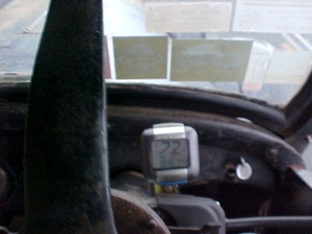

If there is sufficient timing advance, a decent timer, and coils properly set up (equal dwell time to fire works well) 6V operation is fine.
Two of the other T's that I drive, belonging to friends, are also 6V but have working magnetos. I set up their ignition systems also, but just out of habit forget to use the magneto. Again, they run fine and don't find them lacking in high speed performance.
An "ordinary" non-rebuilt ignition system with randmonly adjusted coils with original capacitors, lots of play in the timer linkage, and a questionable timer, well yes, that will need 12V or magneto to get tolerable performance. That's in km/h (72km/h = 45mph).
