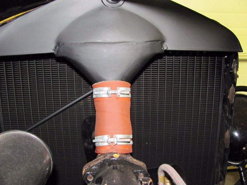

Here is typical brass radiator on a low head with low style cylinder head water outlet to the radiator.

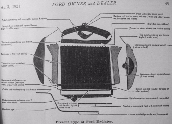

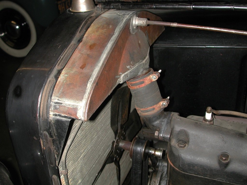

And the factory design of the neck into the upper tank is offset. That mates with the cylinder head as the water outlet bolted there is offset in relation to the head and engine block.
Note rear panel of the upper tank on the right of the photo, the outlet is slightly offset left-to-right, in relation to the radiator support rod to the dash.
And this is Berg's black high radiator, similar position as factory, slight offset to mate to cylinder head.

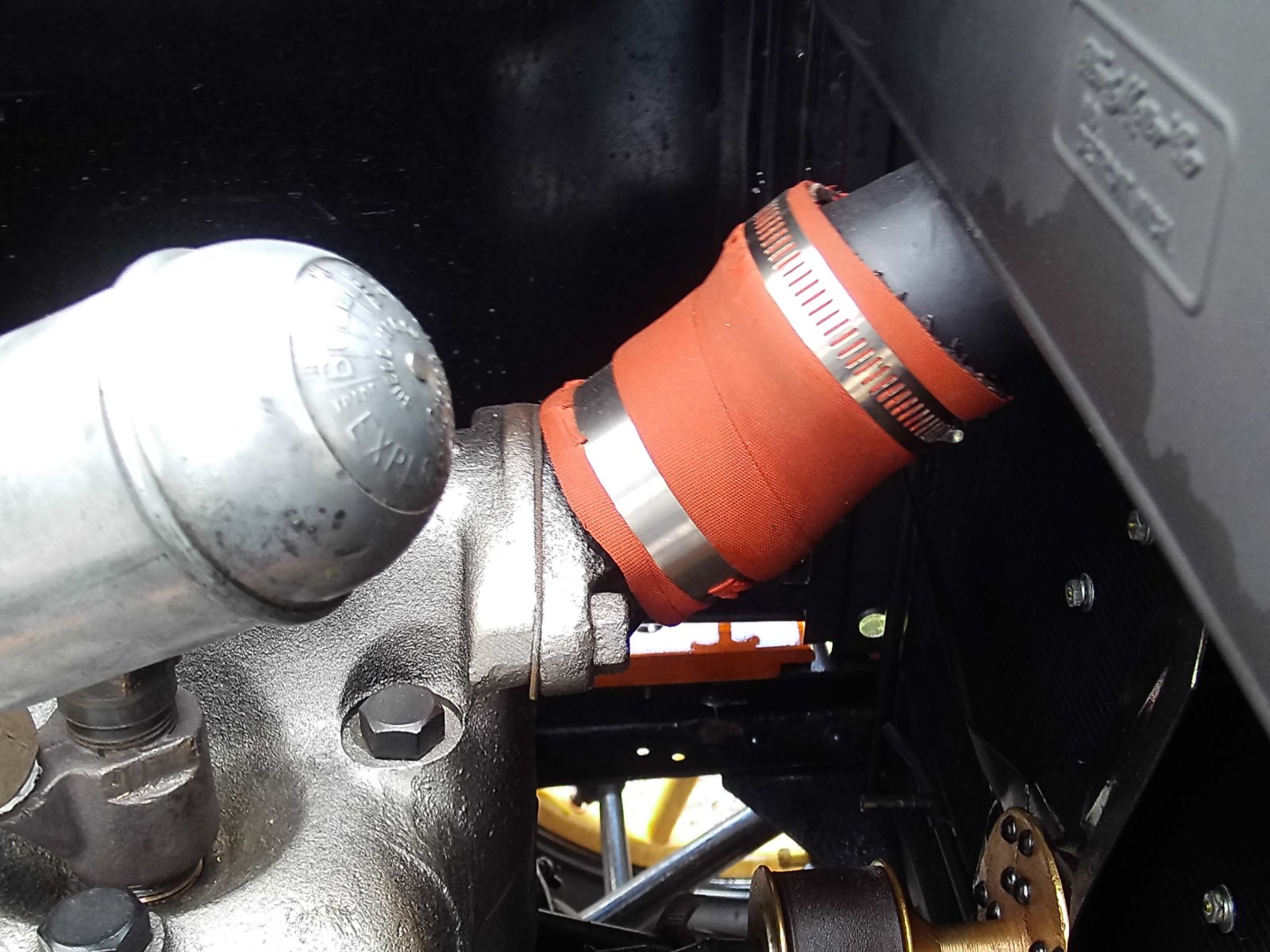

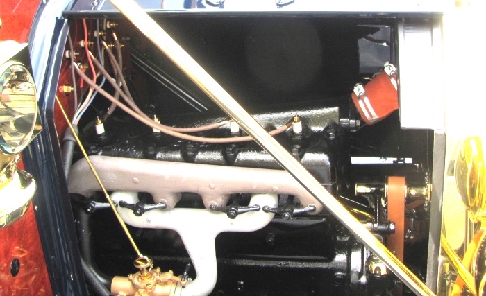

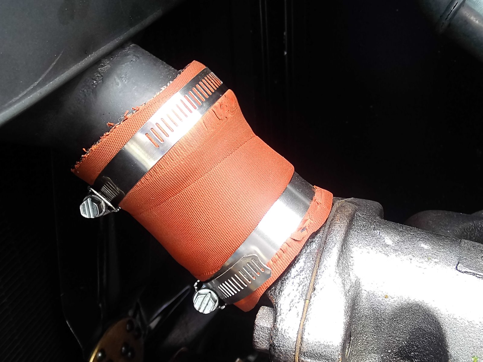

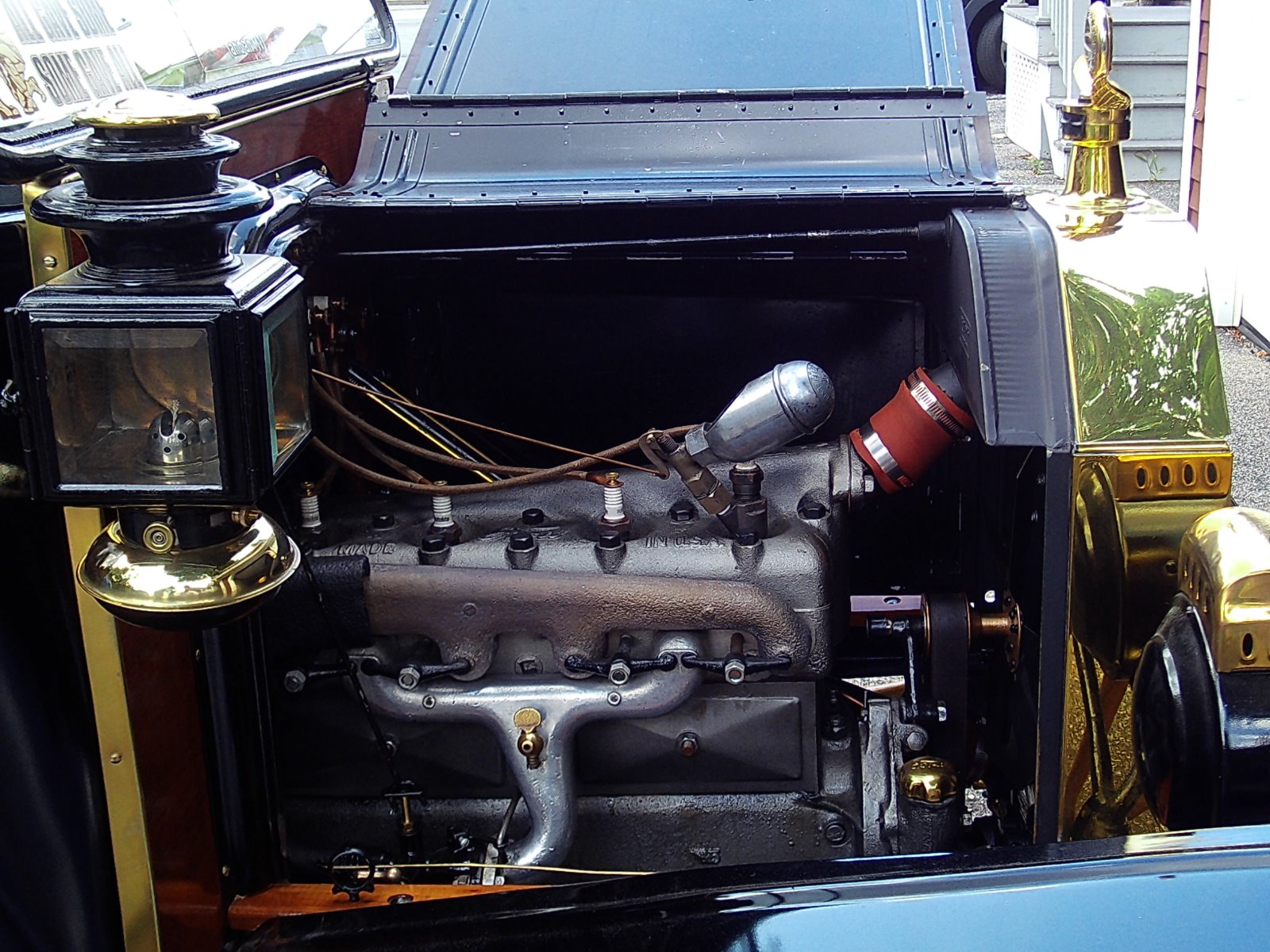

Post by jimuris » Sun Jul 14, 2019 1:11 pm

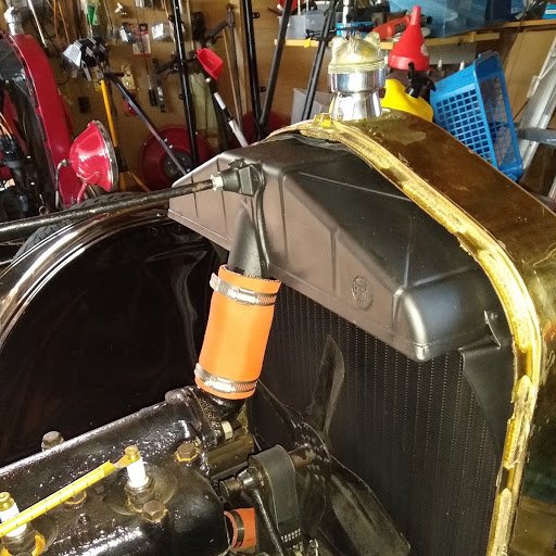

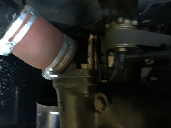

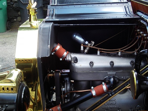

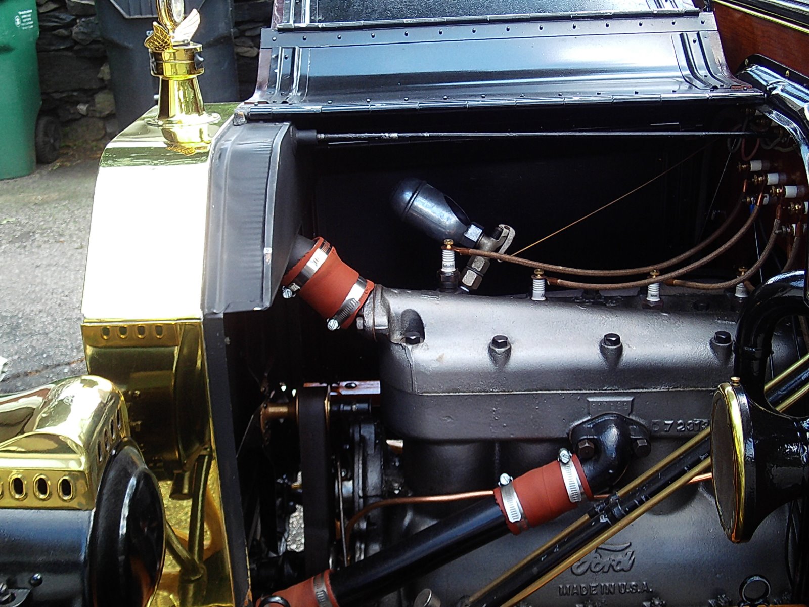

Here are some pics of my issue.
radiator hose
radiator hose
rad hose
rad hose
rad hose
rad hose
rad hose
rad hose

does the clamp tighten down enough for it not to leak?
Posts: 7411
Re: New Brassworks Radiator

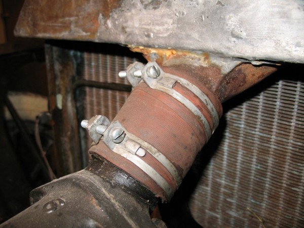

Post by Steve Jelf » Sun Jul 14, 2019 1:38 pm
As Dude Lester said, "It don't hurt the runnin' of it none." As long as the hood fits correctly and the hoses don't leak, I say close enough for gummint work. The change I would make is to ditch the modern clamps and use something close to the original Ford clamps. I think mine are pretty close, though I do cheat and used filister heads so the screwdriver can get a good grip.

All that extra stress on the inlet isn't cool. Is that just a brass tube soldered into brass sheet? The original inlets were a heavy casting with a generous flange and probably more apt to take stress (though at least there wasn't alignment stress present as seen here), but on a set-up like that I'd expect something to fail eventually.

I've seen mismatches at the top hose due to incorrect cross member several times, but so far only on the later “black radiators”. The usual mismatch on the later radiators would be about an inch. It makes sense that the same mismatch on the earlier radiator would be a bit less because of its shallower angle.
