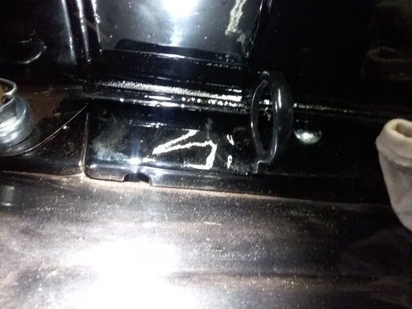

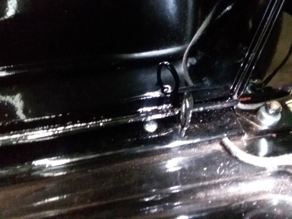

On my 20 coupe there is a little notch on the bottom side of the hood shelf that the wire goes through. hope that helps.

Pictures of the notch in the bottom of the hood shelf, one with the wire one without.

Tractordoc, Thanks for the pics. Jed

No indent on our hood. Anyone else have a hood with a straight bottom?
