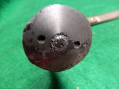

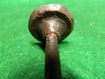

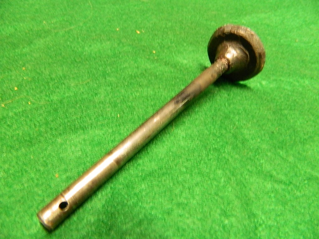

This is the one I removed last spring. It stretched on me and would not seat at all, I now have another that I believe has done the same thing, no compression on number 3 cylinder. When I say stretched I think the valve is in it's last days and is about to blow it's top and it starts to separate the stem from the head resulting in the loss of any gap that was between the valve stem and the lifter thus not letting the valve close fully. The turning you see is from me trying to face off the top to see if I could get it apart, it was to hard near center to cut with high speed tool. Jim
