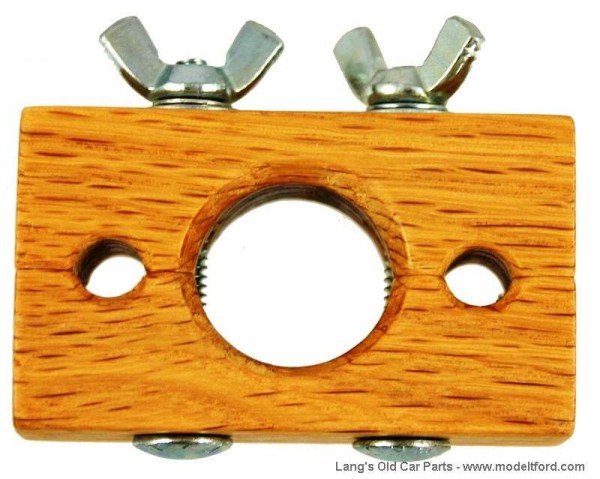

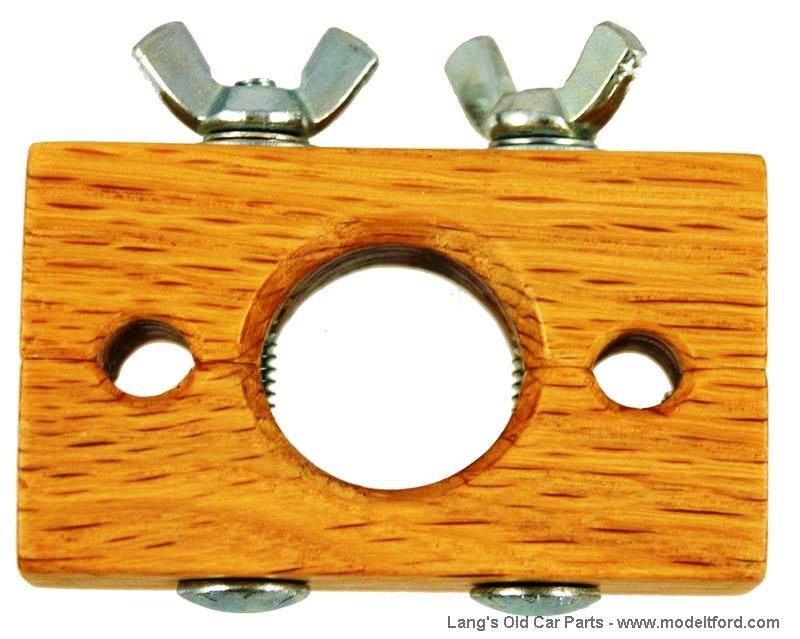

Post by Jugster » Mon Jul 29, 2019 6:35 pm
You might find this accessory helpful. Click on this link:
https://www.modeltford.com/item/3524-25T.aspx

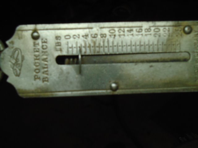

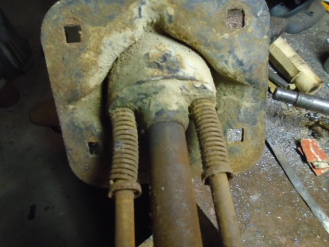

There are springs that provide the required friction, the quadrant notches only offer the position not the friction. It requires about 3 lbs of pull to move the levers. Perhaps your spring is missing or the pin has come out and the spring has slid down the shaft. The cotter pins are very small and can wear out after 100 years
