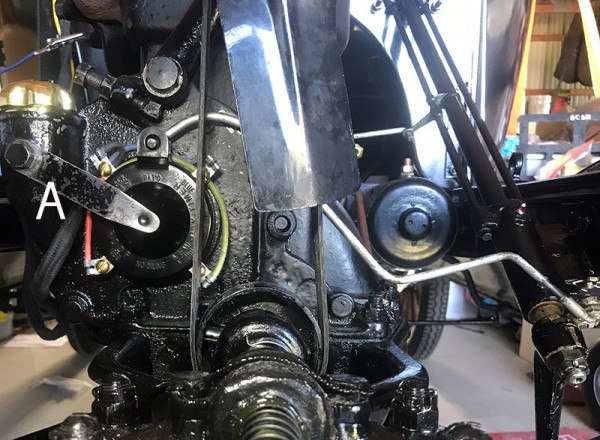

Today I tried to install and adjust my New Day timer. First off I'd like to know if what I've done looks right, then I have a little problem to discuss and a possible solution if you agree.
Following info I found on this forum, I did the following:
1.Identified Cyl # 1
2.Turned the crank until the crank pin was in the 3:30 / 9:30 Position - approx 15° past TDC

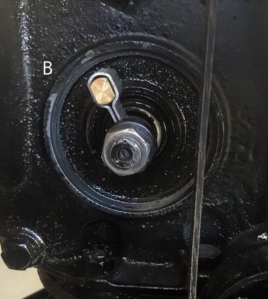

3.rotated the timer until coil # 1 began to buzz then backed it off just enough to stop it. Photo A shows the position of the timer at this point. Photo B shows the position of the brush in this position.
4.Bent the timer rod so that the fully retarded position of the lever corresponded with the timer position in step 3. Advancing the lever 4-5 clicks will start it buzzing again.
-----Does the timer appear to be in the proper position? I ask because if I advance the spark lever and rotate the timer the ear where the lever attaches to the timer touches the edge of the fan belt (my little problem.) I've concluded that either the timer in incorrectly positioned OR the fan belt needs to be shortened which will move the fan and the belt slightly to the car's left. The current belt measures 26 3/4 and experimenting with a tape measure makes me think that a 25 7/8 belt or shorter would give me the clearance I need. What do you think?

Hello Tim, hope the ankle is healing well. I went out and looked at the TT and the RPU both New Day timers are straight up as yours fully retarded. Full advance stop just short of the fan belt. Real close but not touching. Use a piece of string to measure fan belt.

I'm guessing since I cannot see the fan assembly and complete adjustment bracket, it looks like you have the wrong fan adjustment bracket.

It might be that the belt is too long. A shorter belt would put the arm and top pulley farther away from the timer.

Yes, the brush and timer cover appear to be in the proper position. I agree that a shorter belt would be OK. As long as the fan doesn't hit the crank ratchet, it could stand to be considerably lower.

This is an issue caused by incorrect belt length, the timer rod or using the wrong fan adjustment bracket. Usually one of the three I have found on my T’s anyway. It’s a trial and error fit up especially when installing a engine in the car.

Its hard to tell in pic "A" but to me it looks like your timer rod will be above your radiator inlet pipe when you install the radiator. It.should be UNDER the pipe, and positioned so it also does not rub on the lower rubber hose either.

Update - I just hobbled out to the shop & put the sleeve and tube on the outlet elbow. The control rod passes under the tube and appears to clear throughout it's range - we'll see what it looks like with the radiator installed. Fingers crossed
