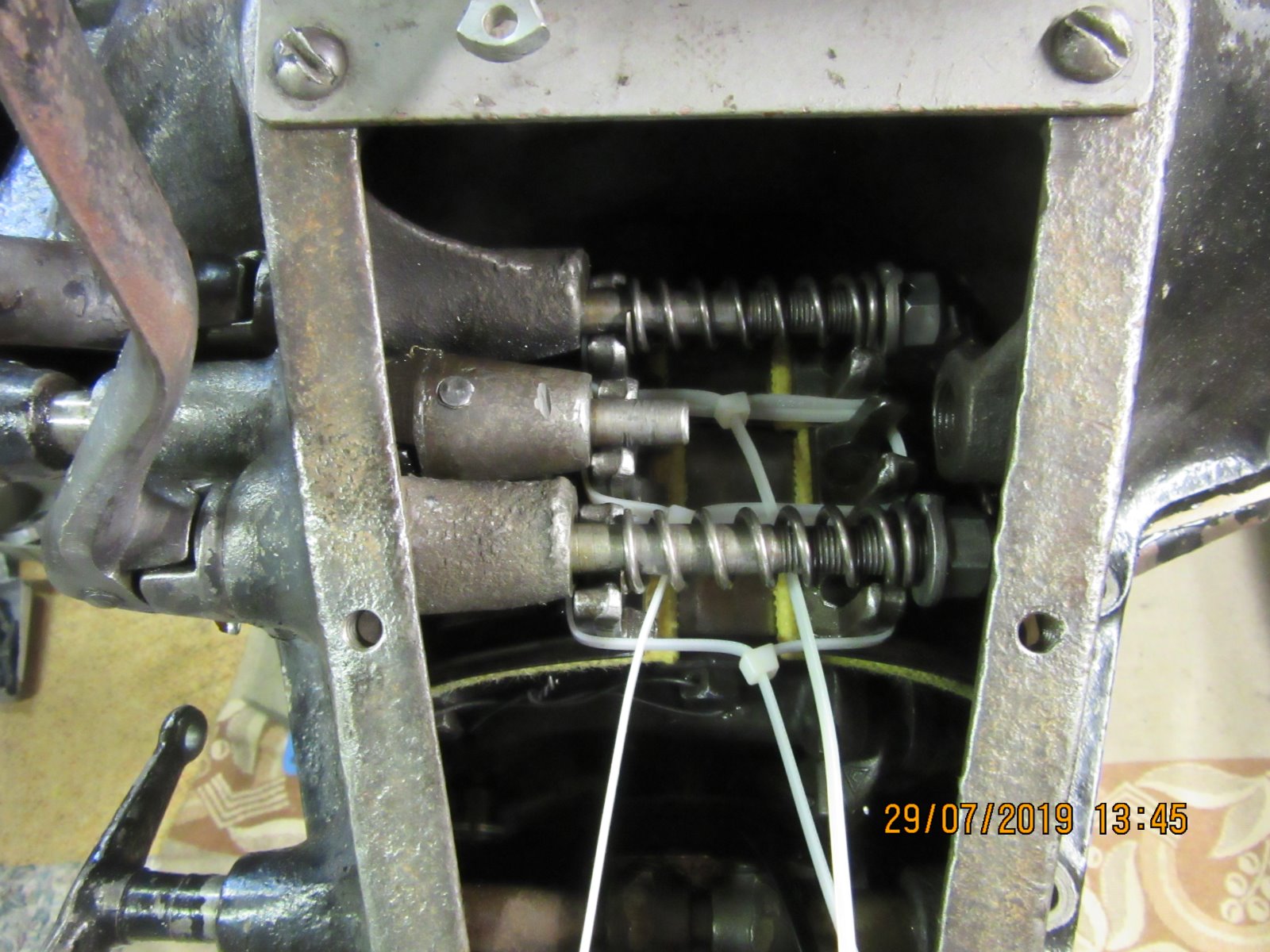

So tonight that is what I tried. I took the output post back off and pulled out an inch of bent tie wire. I looks like some of the wire that I used to hold the bands together during installation (I know, not the best method).

I too encountered a similar problem, caused by me. I pulled the hogs head, and used a couple of small strands of copper wire (from a small 14 gauge wire) to hold the clutch pivot fork in position while lowering the hogs head. It was very small and thin, non magnetic which I thought would be good, and worked great! So I thought. Apparently on removing the strands of wire, I missed or dropped a strand. A couple days later, the mag doesn't work.
I probably did a forum search same as you and asked a question or two, but ultimately, I pulled the post back off, and was in disbelief that it couldn't be that simple. One little strand of copper wire shorting out the mag. I recognized the wire because of its size and length and knew precisely where it came from. Pulled it out, put the mag post back in, and everything was back to normal.

I never use steel wire for the transmission bands !!
