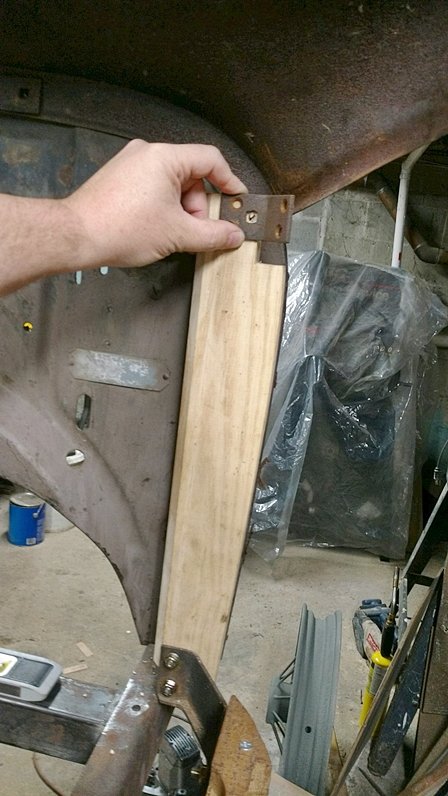

Could someone help me with the sizes of some dash (firewall) bolts. I have a '24 touring body I am rewooding and I bought the body in pieces
If I am looking at things right, All the bolts going to the dash (from body to dash and from frame brackets to dash) are 5/16" carriage bolts....correct? I realize the nuts may not be all the same size, my concern is with the bolt itself.
Also, (I am guessing on this one) the two wood uprights that are on the front of the body sides, and behind the dash, appeared as though they used a much longer bolt to go through the wood, through the body, through the cowl and finally through the dash. If that is correct, is it also a carriage bolt? The hole in the wood is round all the way through, so I cant see if there was a square where a carriage bolt may have been..it might have stripped out? I cant imagine this bolt being a regular hex but I could be wrong.

I am pretty sure the only bolts between the firewall(dash) and body are the 4 up top around the cowl. There would be no bolts going thru the dash pillars and dash (firewall). Up to the introduction of the 26 models, the body and dash were independent things. You could remove the body by taking out the 4 bolts at the top of the dash , 6 body mounting bolts, screws holding running board aprons and fenders off then lift the body off leaving the dash behind. (also removing the instrument panel and steering column brace) Someone in the past may have added those extra bolts or your thinking they are longer then needed, if I am reading your question right.

Anyhow, to answer my own questions. The bolt sizes for the dash to body and dash to frame brackets is 5/16"---carriage bolts, of varying lengths. Obviously we all know that the new hardware store carriage bolt heads are not shaped the same size or dome, but for my purposes here with this body, they will be fine.
The wood dash pillar, (Thank You Mark for using the correct terminology), Does have one of the 4 bolts going through it. There is a small metal reinforcing bracket that attaches the cowl support piece of wood to the dash pillar that has a corresponding hole....a square hole for a carriage bolt. So of the 4 bolts attaching the body to the dash, the two inner 5/16 carriage bolts are short---maybe about a 1/2" long give or take. The two outer bolts are maybe about 1 3/4" - 2" in length as they go through the wood dash pillar and then through the cowl and then dash.
Hope that helps somebody in the future.
